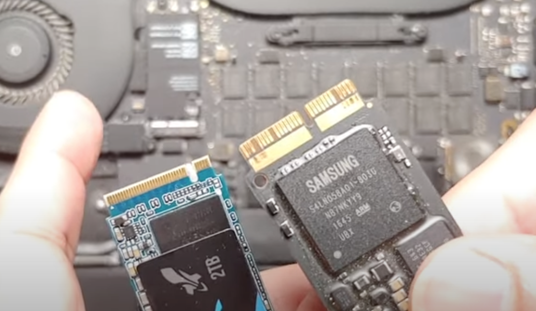

You have a replaceable nvme with the Apple 12+16 Pin Connector.
There where external USB enclosures in the Past and maybe you are able to find one Today.
The best approach i think is to get an external USB SSD and Install MacOS from an USB Install Stick onto the external USB SSD so you can read out the Internal if you are lucky and can think about the Internal SSD replacement later if you want.

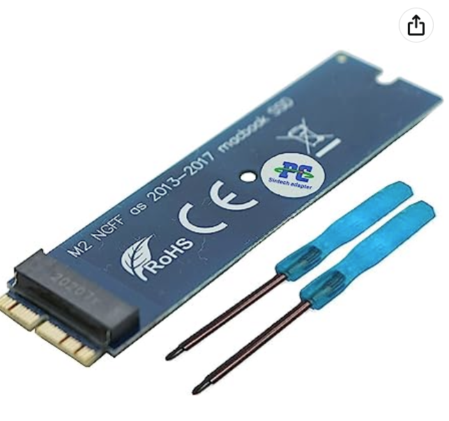

To find an Internal NVME to 12+16 Adapter ist not so difficult.
Most prefere the Sintech:
