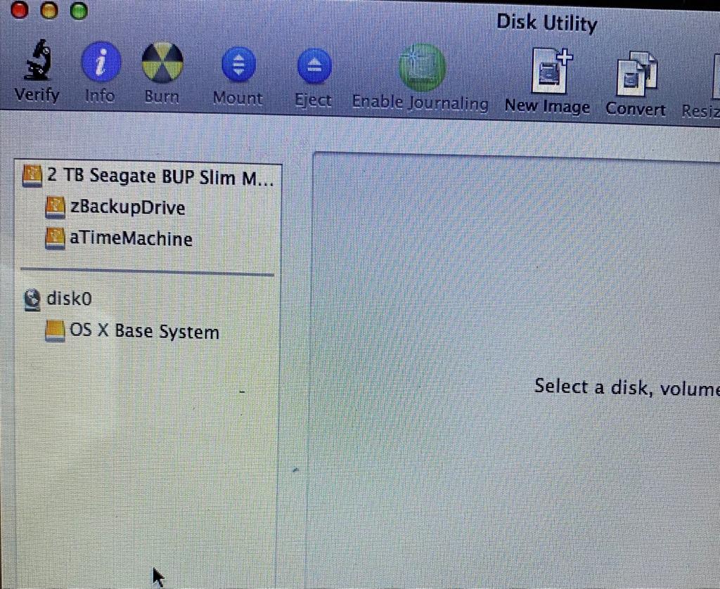

It did not work. New SSD installed but same problem; the only disk that shows up in Disk Utility is OS X Base System 200 MB. Also I do not understand this "Make sure the MacBook is running at least a High Sierra bootrom"; how can I do this when my MBA is not booting at all? prior to this it had Mac OS Catalina. Did I buy wrong SSD?

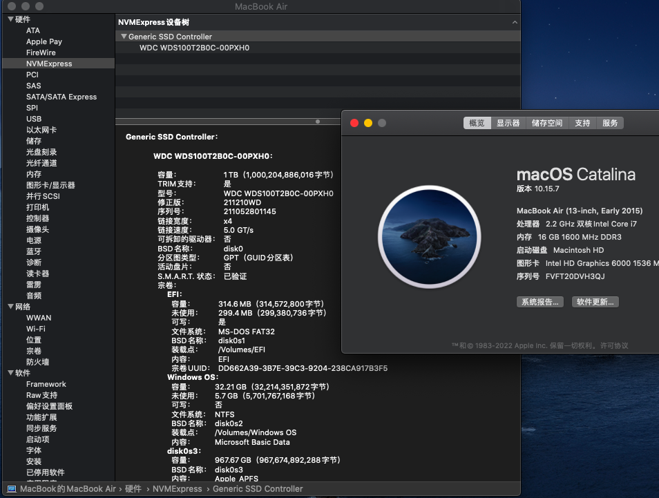

mba 2015 replacement third party nvme ssd sn550 1t needs an adapter card
If you are trying to install, while booted to internet recovery - your MBAir originally shipped with (probably) Mavericks, and possibly Mountain Lion. Neither will see an NVME card. You can see exactly the version that you are trying to install by starting the "Reinstall OS X". You will need, at minimum, High Sierra. Even better, reinstall the same system that you have been using: Catalina. Make the installer for Catalina on another Mac, then boot to that bootable USB installer on your MBAir.
