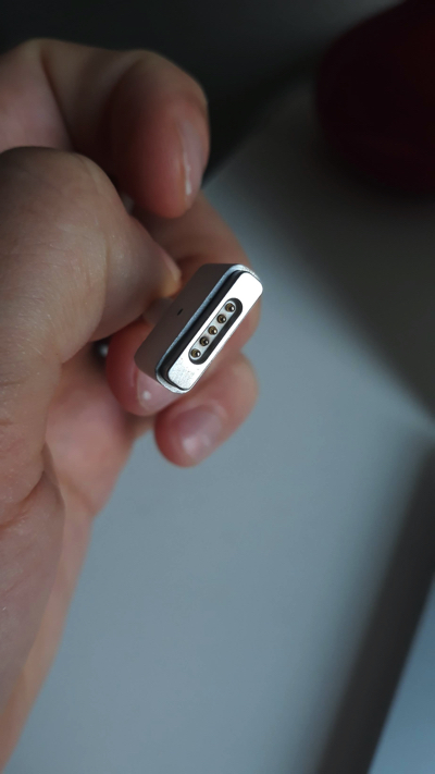

In the last couple of weeks, I've noticed my charger connector (the part which connects to Mac) is too hot to touch and also there are some pins a bit burnt (it is getting slowly but visibly worse). Charging ability is unchanged but I really like this machine, otherwise, it is working fine.
I have tried to clean the patches. It is extremely hot only when not fully charged when fully charged it is normal. What could I do? I guess it is not exactly harmless for the machine.

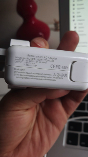

Looks like an "off-shore" replacement adapter (not made or sold by Apple).
In my experience, replacing a power adapter "on the cheap", may leave you with unexpected "fun" later on.
As you are now having problems, I recommend that you replace with a "real" replacement. Hopefully, you won't need to replace the internal connector, too...
Looks like too much current is going through. I do not recall the exact pinout of the MagSafe but the middle pin and one adjacent to it are both ground. The other adjacent pin is DC in.
Normally a higher wattage power supply would not be expected to harm the computer. There is a circuit called a buck converter that adjusts the power down to what is needed.
Have you tried resetting SMC? The SMC controls how the buck converter behaves. Otherwise, there could be a short on the PPBus (yes, that is what it is called) and that is causing high current to flow straight out of the power supply, through the magsafe and to ground. Or possibly the adapter is not talking with the SMC correctly.
The pictured charger is not an original Apple charger. I know that some non-original chargers do not have the same sophisticated circuitry that original adapters have.
Ok, seems like it should be the first option to try out (get original Apple one)

Well, that is a sophisticated answer. Will try all of that. Thank you
