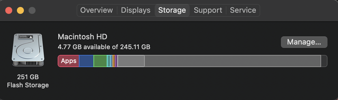

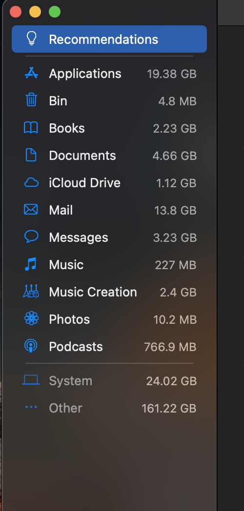

I'm trying to find out what is taking up all the space on my 2020 MacBook Air M1.
Its 251GB HD is nearly full, with 160GB taken up with 'Other' files.
Mail is taking up 13GB so maybe that can be tidied up, but my Photos and Video files aren't taking up any more than 8GB, so is there an easy way of seeing what is taking up most of that 160GB so I can try and delete or move the largest files to iCloud please?

I just can't see what is taking up the 160GB of 'Other'.
I'm using iCloud for most things, and I've deleted some files to make a little more space. The total video and photo files are of minimal size and are mostly in iCloud anyway.

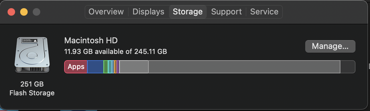

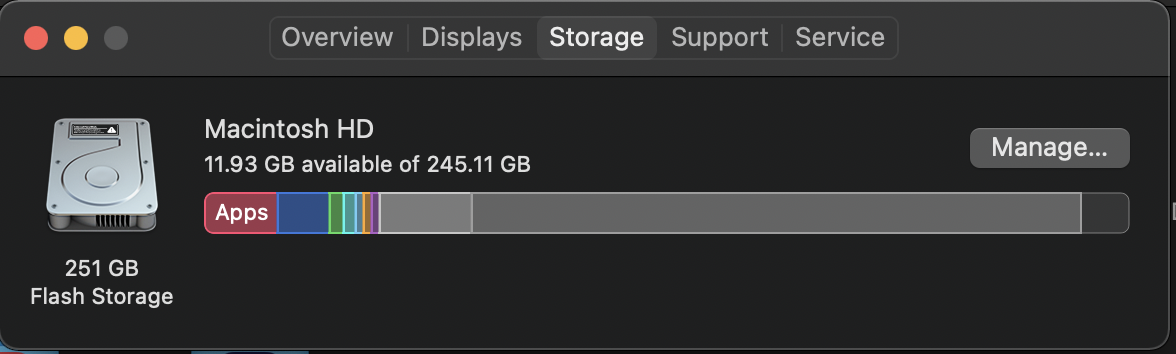

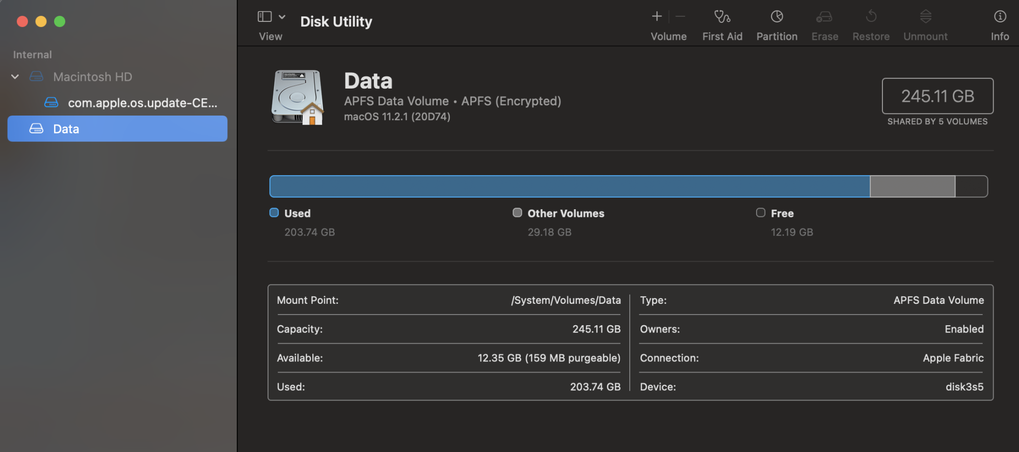

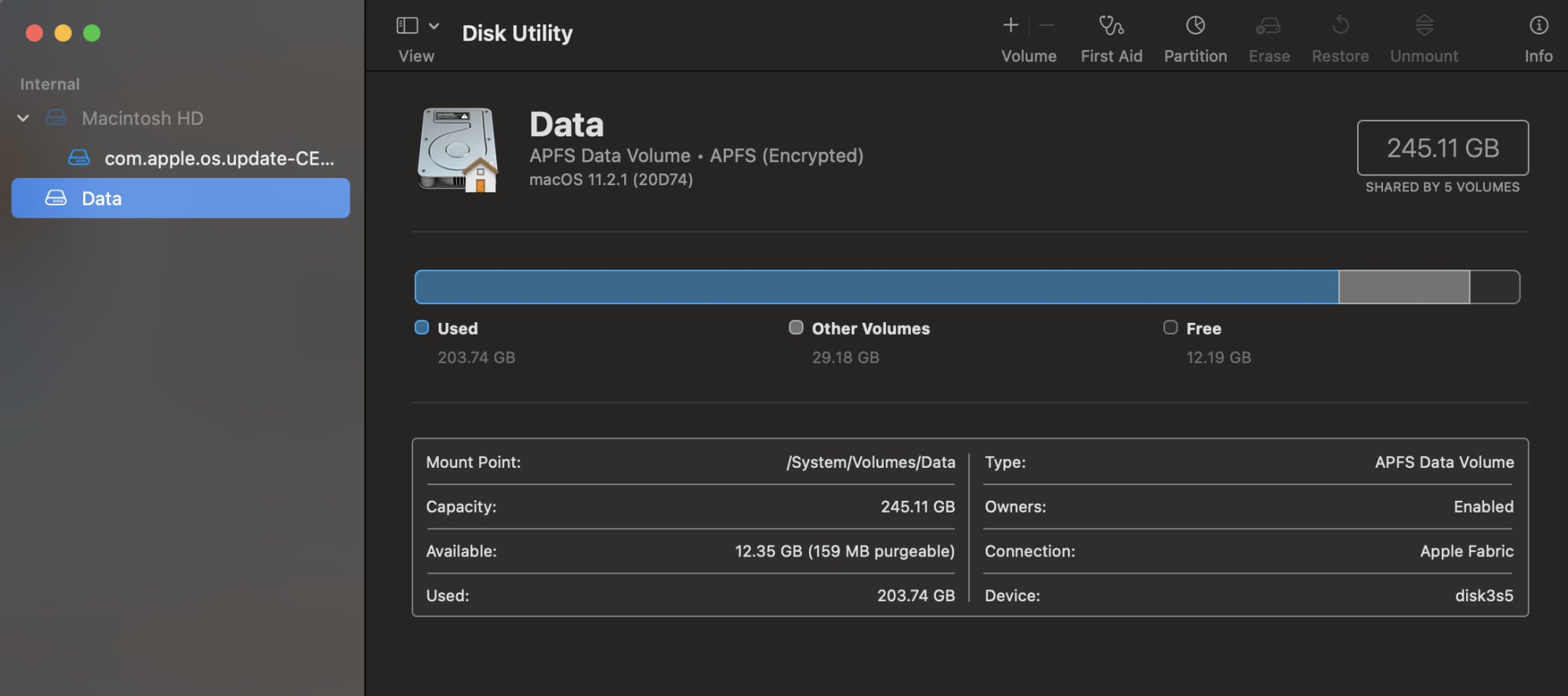

If you used TimeMachine and it’s picking up an external, a copy of that external backup is on your internal. If that sounds insane, there is some logic to it. Speak to Apple. Anyway, open Disk Utility, highlight your user's volume group, look at Private Size to see how much space Snapshots are taking up.

Pretty sure snapshots would appear as reclaims or space with lines over it not the solid other block. But yeah. If snapshots are the cause the can be deleted with diskutil ap deleteLocalSnapshot (conmand from memory. Probably wrong. Will advice later if needed when at my desk)

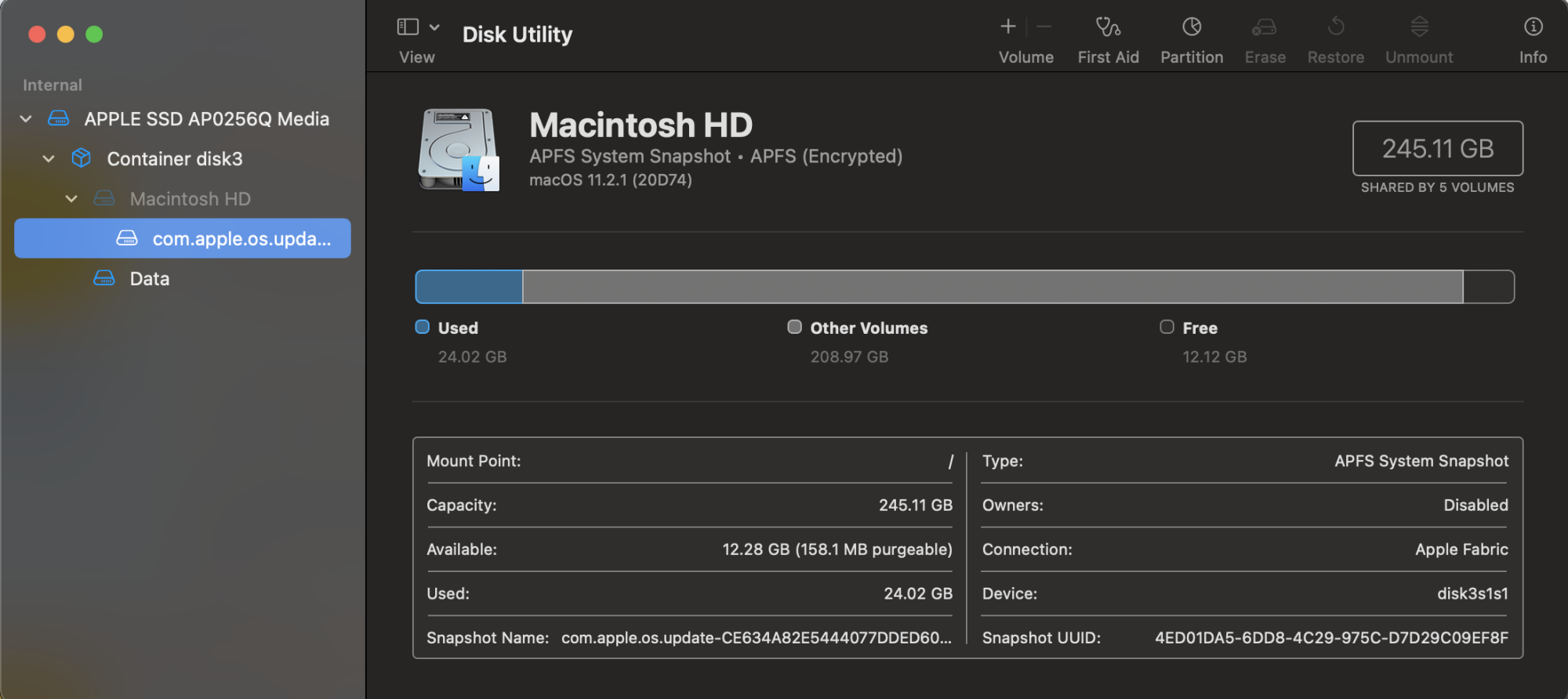

I'm not quite sure what any of the below means if I'm honest..
Within DU, just right click on the snapshot to delete.

If you’re not using TM, it shouldn’t be an issue. Go to View and make sure you’re not hiding snapshots. If you’re not hiding, you don’t have any. They would appear directly under what you have shown. Sorry, keep looking.
This?

Yeah, I think MacOS supposedly will start freeing up space it knows it can without breaking things, only when the disk gets pretty full, but it doesn't tell you that.. I might be wrong on that but I thought that's how it works.. I use CleanMyMac X on mine to get rid of cache junk and to uninstall programs. It seems to work ok. I've kept up on it once in a while so cache junk doesn't get too built up. I guess with MacOS you're not supposed to have to resort to that, but to each his own.. I do go thru Messages and clear out pics and vids I've sent or sent to me if I've added them to my library. You do have to actively keep up on that or yeah like you said, they eat space. I do think it does offload pics and vids though in Messages as I've scrolled back and back and back and it has to wait and load things, like it's downloading from iCloud...who knows.. I've got the 1TB 13+ and I did put the 2TB ADATA in this MBA so I do have plenty of space. 128/256/512 or even 1TB just doesn't cut it for me on Mac.. My next machine is gonna be really really expensive..
Daisy disk is great (and fast) but I find that I find more stuff with Grand Perspective
- https://apps.apple.com/us/app/grandperspective/id1111570163 (also here for free at https://grandperspectiv.sourceforge.net - but seriously just give them the $3!)
It take longer to run, but I love that I see the whole drive at the file/folder level.
Thanks, I've just installed Grand Perspective, I like how you can scan any part of your HD to see the size of files.
Unfortunately it only tells me what I already know regarding what is on my HD, I still can't fathom out what is taking up the 160GB of 'Other'.

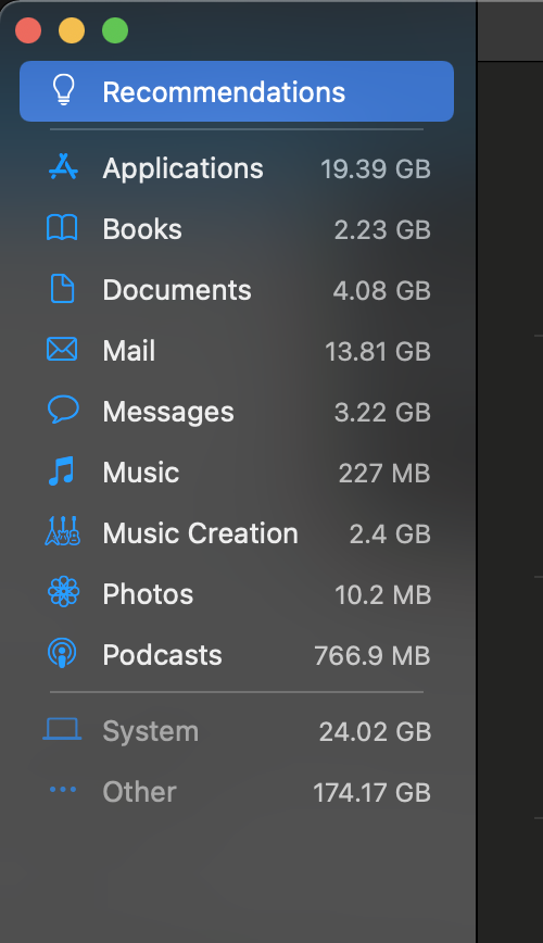

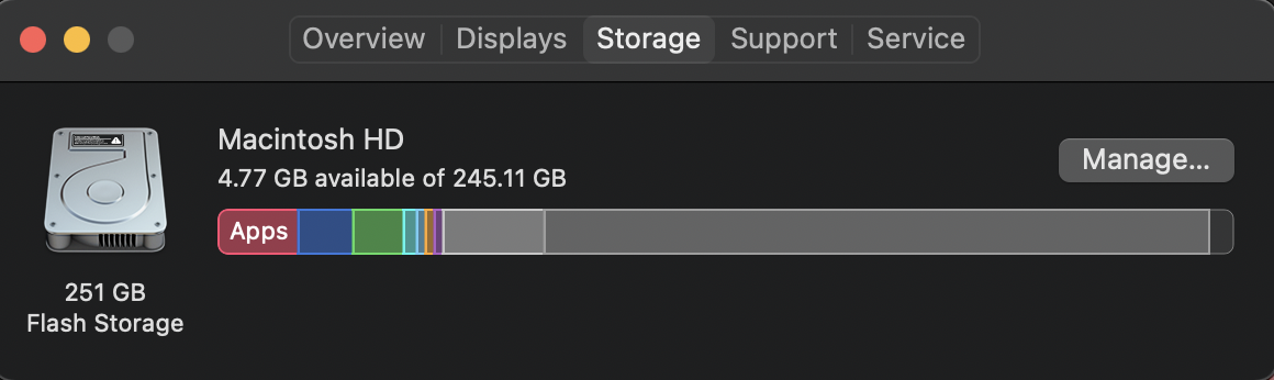

Well things have gone from bad to worse in just a couple of days..
Just a couple of days ago I deleted as many unwanted files as possible, and I managed to free up 12GB to space.
Today that free space has now reduced to just 636MB, and the 'Other' has jumped up to 174GB.
Mail popped up a message saying it can lo longer function as there is not enough space, and promptly closed itself down.
I have no idea what's going on..

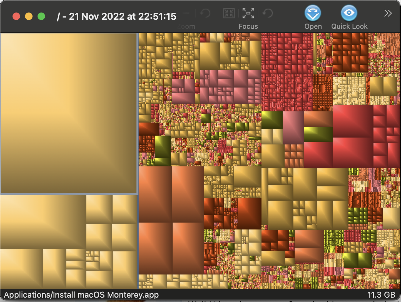

I ran Grand Perspective which shows the largest file is my operating system at 11GB..

It might make sense to do a backup to Time Machine and reinstall with restore from Time Machine, if you can’t figure out where all that junk is coming from. Or even better, backup all the important data separately, and do a clean install. Always make sure you have multiple backups though before attempting something like this.
After I did a clean install of my wife’s computer, the excessive storage usage on Other hasn’t come back. For now at least. 😐
