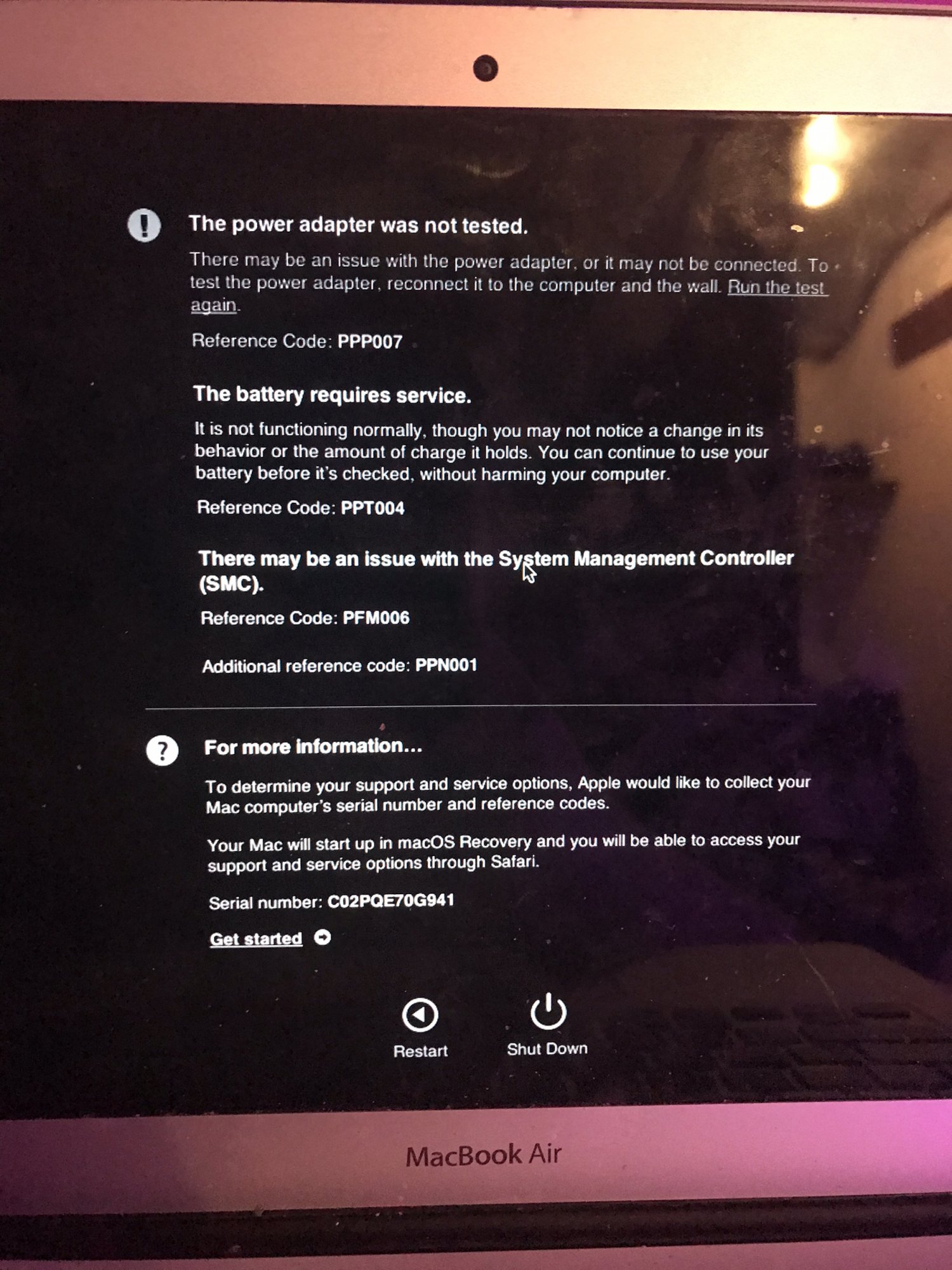

I've tried an SMC reset, PRAM and NVRAM resets, I ran apple diagnostics (shut down computer and hold D) and my results are attached. The solutions i've tried have all failed and I'm not comfortable enough messing with my system files as previous solutions on the forum suggested

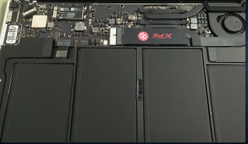

Well, it sounds like you may have done internal damage. The IO board is right there, along with the Magsafe2 port, and the fan is right there.. Does the USB and headphone jack work? If not, definite damage. If they do, you still may have damage. It's up to you what you do. Maybe find a local reputable repair shop that works on Mac's. Here's the inside of mine for reference. That flat cable that kinda routes around the fan I think is the IO cable. If you take the bottom cover off at least make sure that is still seated well on both ends. Also, that little connector in my pic on the left above the battery with the little helper tag on it, that's the battery connector. Make sure that's still plugged in good. You'll of course need the proper P5 screwdriver for it if you attempt that. I wouldn't try that unless you know what you're doing. I'm not responsible for further damage should you try opening it. My suggestion would be find a shop, or Apple... Good luck. You may find you're better off money wise finding another good working used one and putting your SSD in it..
