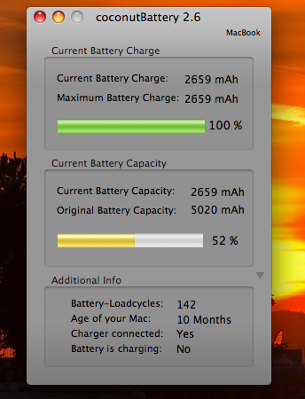

i have the same thing
142 cycles
10 months old
only 52% left. i think i'll call apple care
macbook 13".
