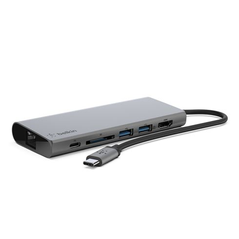

OK But lets say i buy something like this
How is that going to connect to a 2014 macbook pro using the above adapter?
That is a USB-C dock; you cannot use that with the Thunderbolt adapter. You must use an externally powered Thunderbolt 3 device, and it must have a removable cable. The adapter would then replace the cable on the dock and you'd use a Thunderbolt 1/2 cable to connect the adapter to your 2014 computer.
