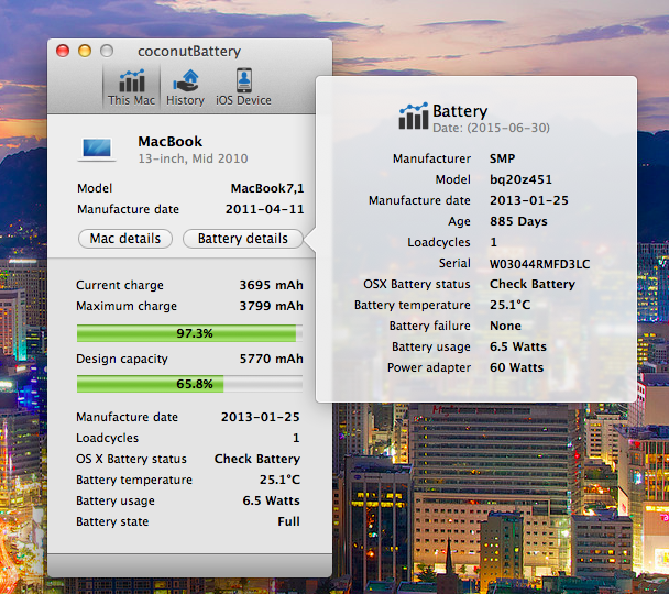

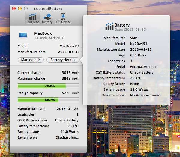

Hi all, I have a MacBook (mid-2010 white) which I bought around four years ago.
It worked perfectly for quite a while, but I didn't use it for quite a while (9-10 months) and when I opened it up, it turned out the battery needed replacement. I got the battery replaced (by an Apple-certified store), but when I turned it on this time, the battery information showed 'Service battery' warning, and the first full charge went up only to 97% and not 100%. The store informed me that it's normal and that I can still use my Macbook normally, but after checking CoconutBattery, I was surprised that it held only 66.7% of the design capacity when it's supposed to be a new battery.
I did a recalibration (charging it to full and leaving it plugged in for two hours, then unplugging it and leaving it to drain until it dies on its own, then charging again), and it lowered the design capacity to 65.8%!
It feels a bit worrying that a supposedly new replacement battery holds only 66-65% of its' initial design capacity. Is this normal or should I get looked at again?
This is the battery information from System Information, and the CoconutBattery screenshots are attached.

Screen Shot 2015-06-30 at 12.31.28 AM.png Screen Shot 2015-06-30 at 8.53.01 PM.png

I followed your instructions, but the LED didn't change colors, it only dimmed until it turned off. When it turned off, I powered it on, but now the battery is down to 65.5% design capacity and only raised a tiny bit to 98% battery charge. :( should I try it again? or maybe recalibrate the battery again? or perhaps just give up and use the battery until it needs to be replaced again? :confused:

At full charge of 98%, the battery info says it holds around 4:50 hrs. I charged it to full and unplugged it at 11PM, and now at 2:15 AM, it's down to 25% (1:08 left) with typical usage of web surfing and watching videos. I did switch between using my Macbook and my PC while using it, so it might be different if I was using it continually without switching back and forth.

I would definitely phone them again, or head over there and explain what is going on. 3-4 hours if that is not how long it should be holding a charge, and that actually seems pretty accurate of what a 60% capacity battery would yield.
So, essentially, it seems like the reading is proper and you were sold a 60% capacity battery, which is not cool. I'd get my money back or have it replaced again.
