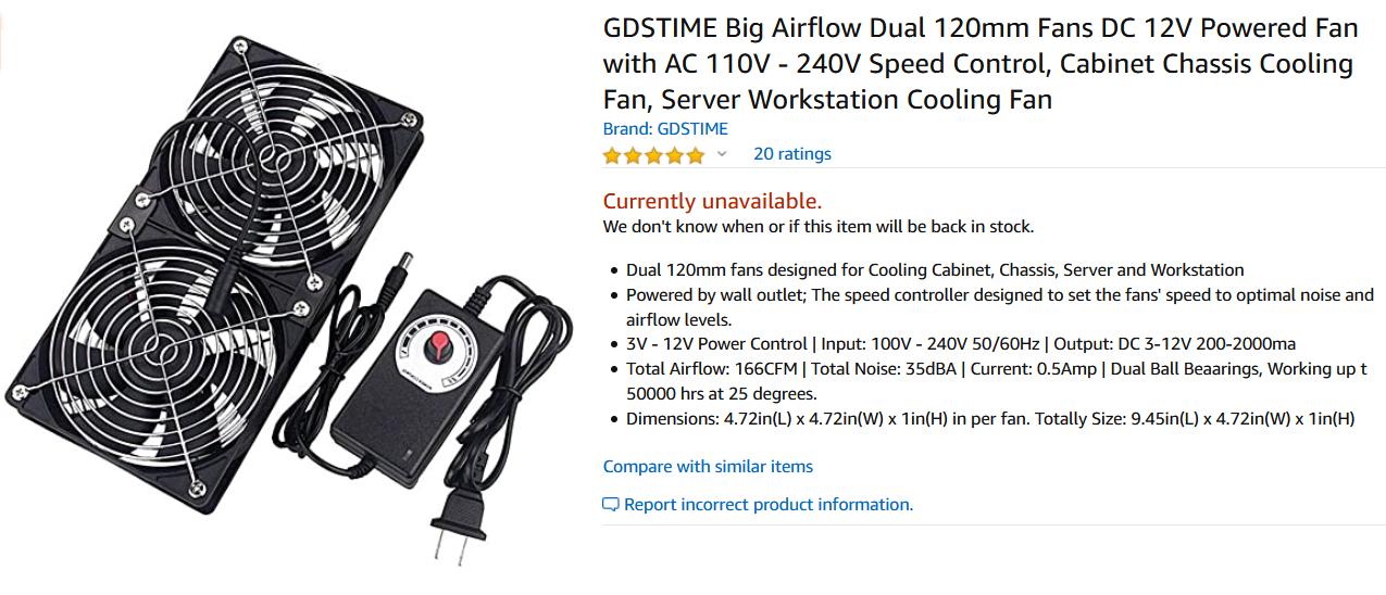

I also have a 2014 at 2.2 Ghz and only Intel graphics and I run trading and video applications on it and it can get warm with the fans spinning and making a lot of noise. I use it in clamshell hooked up to a 4K display. My fix to get temperatures down:
