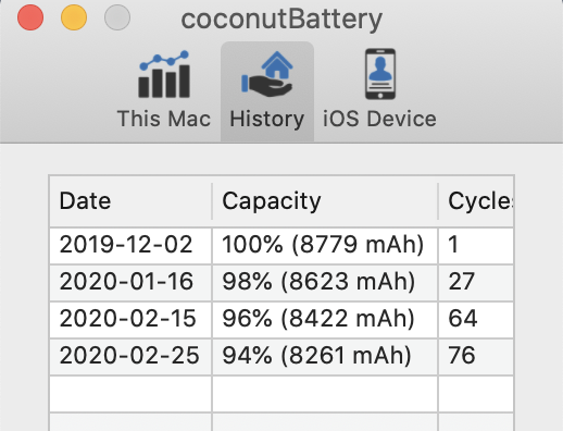

Hi,
via coconutBattery, I see that the % of my 16" MBP is dropping pretty quickly. If it's going to continue like that I may be below 80% at 250-300 cycles?
Is it normal, or should I worry?
Thanks
Is the battery still behaving as expected in normal, daily use? I'd put more stock in that than the reported stats - there's sometimes too much information these days.
I can't really measure it since my laptop usage varies greatly from day to a day. Sometimes I'm just browsing, sometimes casting, sometimes editing, so I can't really have a "feel" of my battery if I get a few mins less or not. Def. not hours less if any.
These statistics seem to vary up/down and their precision is not really clear. My 15 inch 2017 has had as low as 96% and is now back at 99% in ~50 cycles (new battery due to keyboard replacement). If you do not discharge sometimes bit deeper, try discharging intentionally to may be 20% or so. And see, if that improves the reading. Those measurements used to calculate the capacity are not perfect. Some people do "re-calibration", you can google it. I am not sure if it is really healthy and useful, though.
In any case, if it drops under warranty below 80%, Apple will replace it. Keep an eye on it. There are here and there bad batteries.
The problem is the trend. I know it's not 100% accurate and fluctuates 1-2% here and there, and that it's not linear, but it's weird that every 10 cycles or so it goes down by 1%
If you don't think its working as expected, take it back, but I believe apple doesn't consider it defective until the 80% mark.
