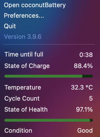

I dowloaded coconut and my new laptop has the following - Does this seem right as I have only had for 7 days - 5 Cycles and 97% health? :
I'm not sure about the 97% thing. Mine currently says 99.8%, but I do recall my previous MBP being a few percentage points lower when I first got it.
