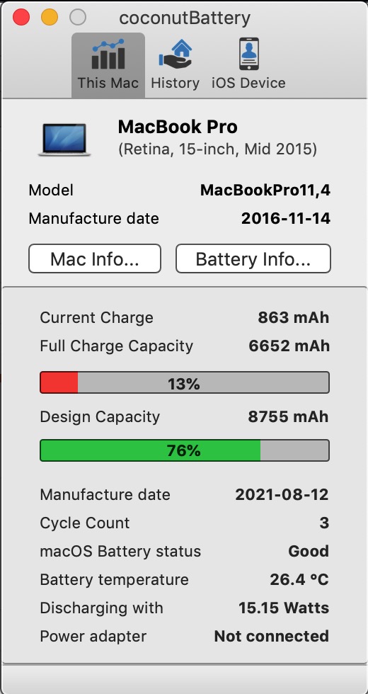

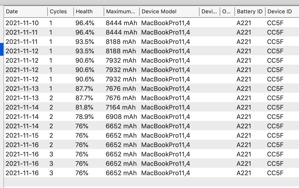

As per the seller, OEM. Coconut reports it as a Simplo. One thing I also forgot to mention, the full charge capacity has dropped dramatically but all these number look inaccurate to me as I can use the computer for substantially longer periods without charging than before with the old battery. As you can see below I have been stuck at 13% for like 1 hour and I am expecting a sudden shutdown soon.
