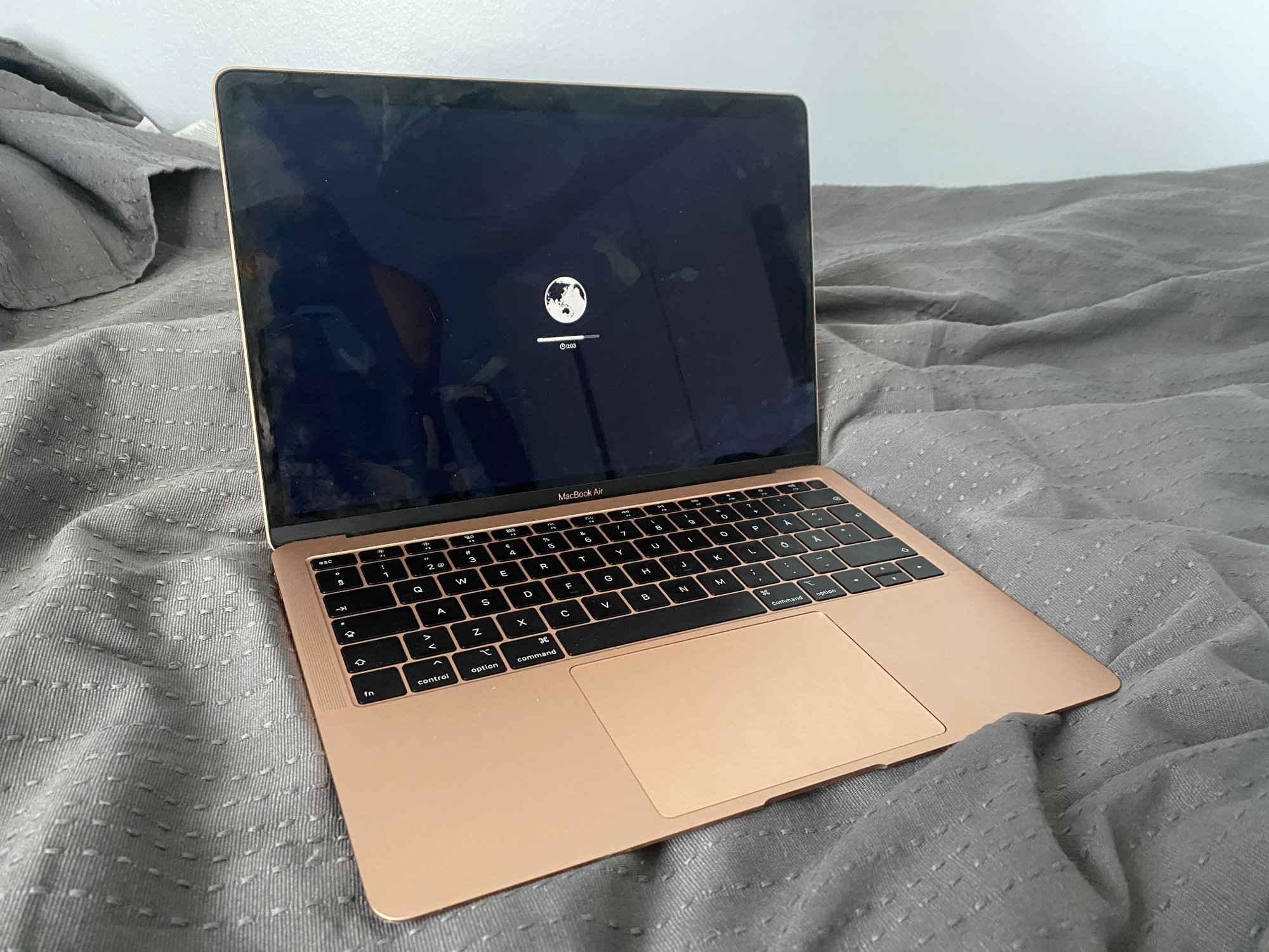

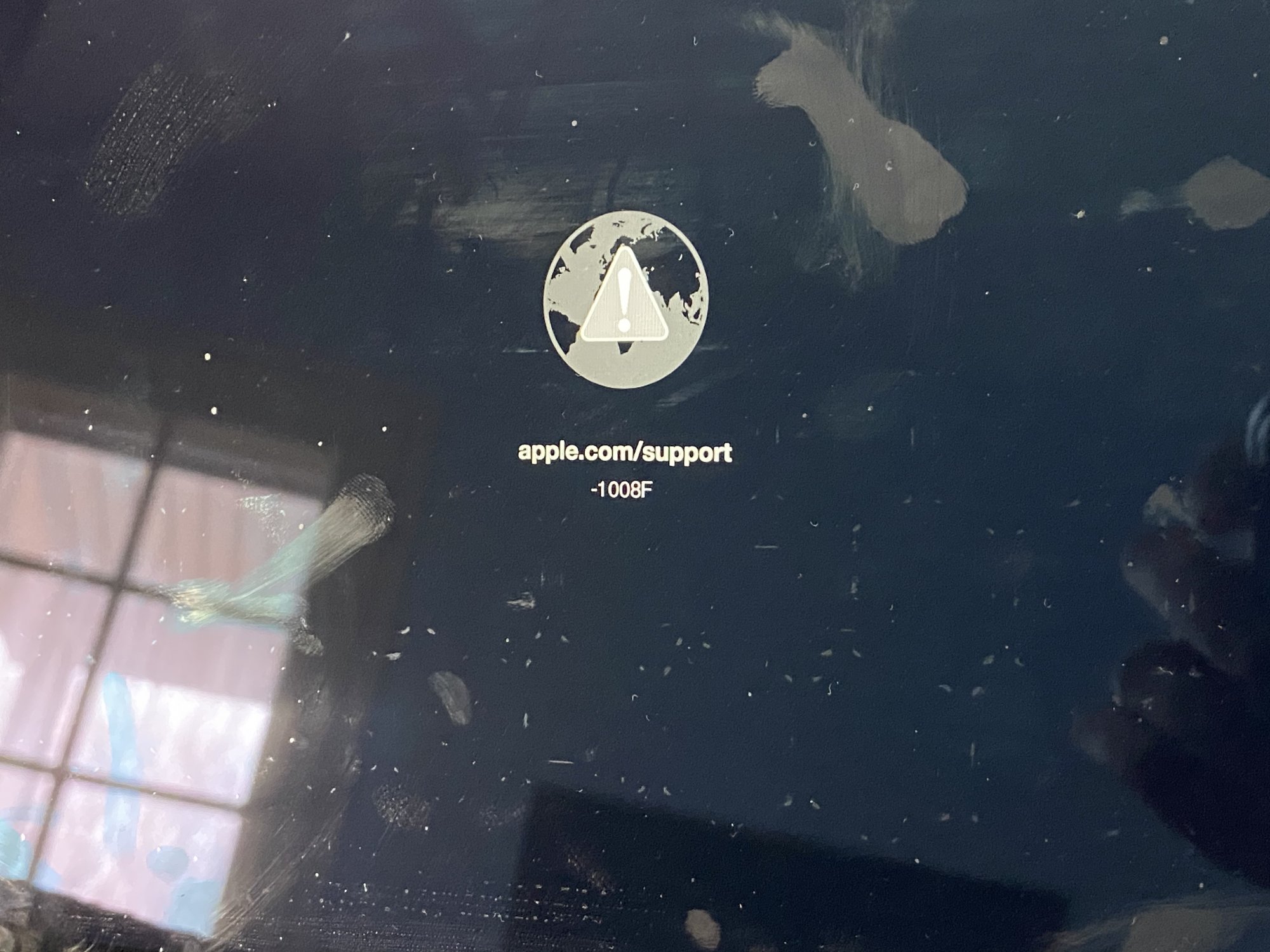

Hello, my MacBook air 2018 has a big issue with its software.
My Original plan was to reinstall the OS.
I did the normal things, went to diskmanager And deleted everything from the Drive.
Then I restarted the MacBook like normal, And pressed command+R.
After that It gives me a screen, where I can Connect to a Wi-Fi, but When I try to use it It gives error code -1008F. I have tried many times And it does the same everytime.
I have no access to the Internet recovery window, so I cant use a USB installation media, because I cant change the bootoption.
The computer has no warranty left.
Is there anything I can do?
I have also tried all the keyboard combinations And they dont do anything.
Cmd option R.
Also already smc and pram?
That error is usually because you are trying to use Internet recovery over with a wifi security method not supported. Just for now, try opening up your wifi with no password and see if that works.

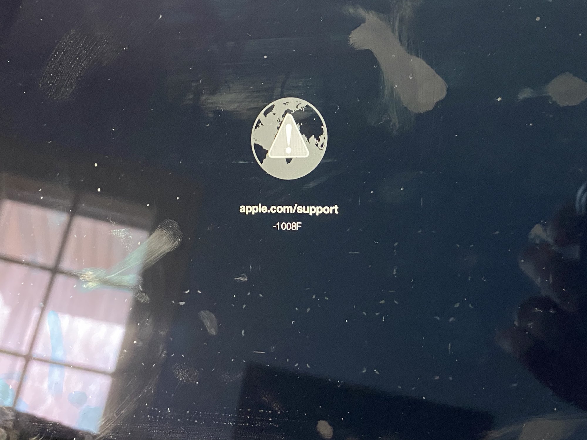

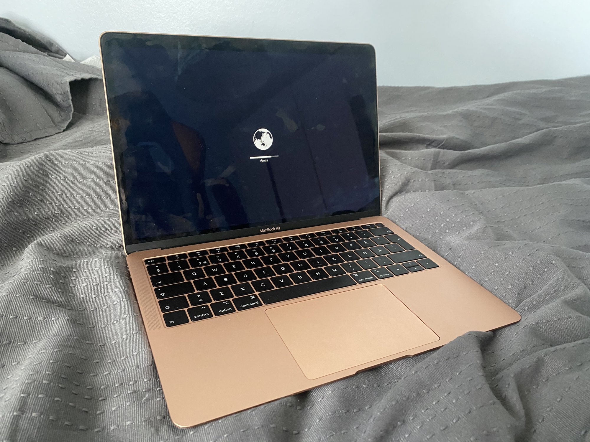

I have also tried all the keyboard combinations And they dont do anything.View attachment 902488View attachment 902489
If you boot back to Recovery Mode and run Disk Utility what does it show when you enable View->Show All Devices?
Didnt work for me.
You need to remove the device from the Find My devices. that is blocking it to proceed with the recovery and that's why the 1008F error
after you do that, try restarting with Command + R, and if that doesn’t work try with Comand + Option + R
That fixed it for me
