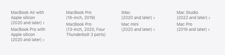

macOS Tahoe is officially the last macOS to support Intel Macs, as confirmed by Apple. This will be quite a long thread, I'm sure. The official minimum requirements are as follows:

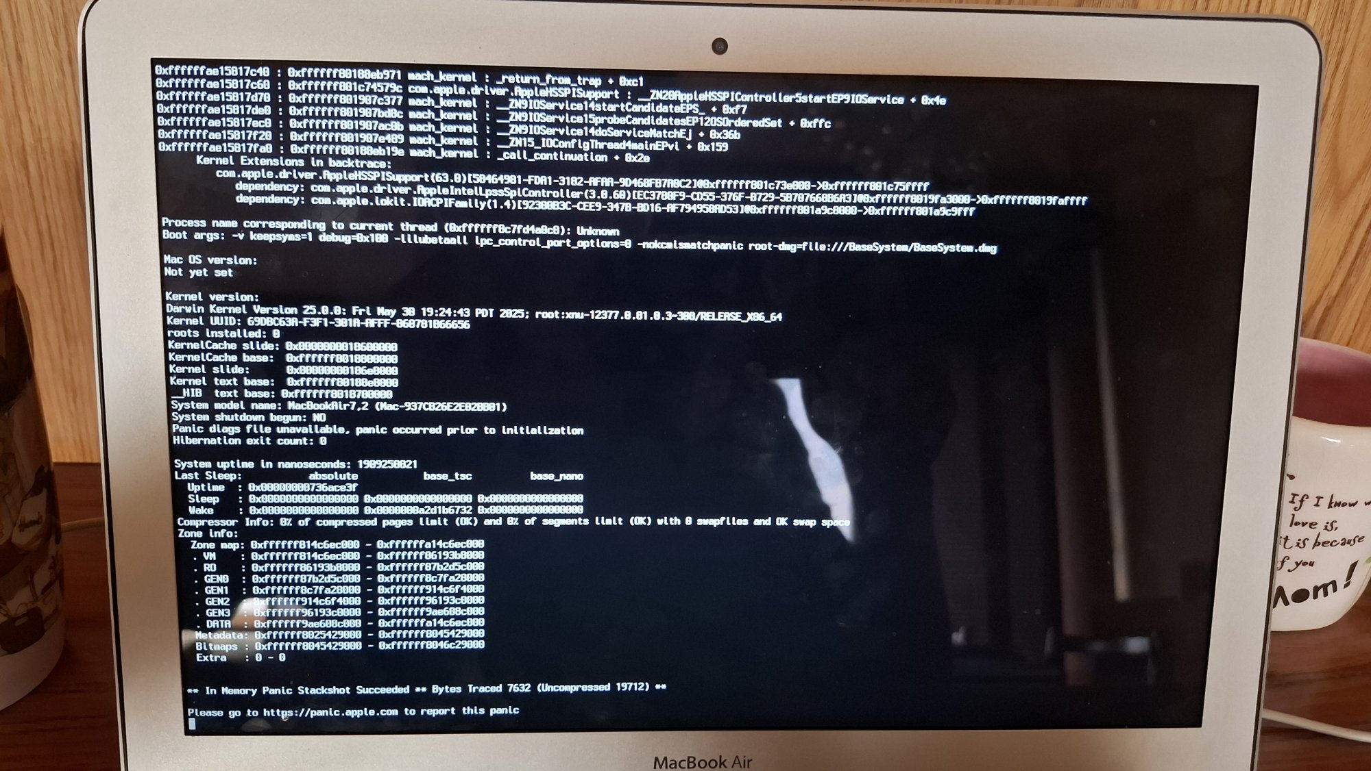

I'm planning on downloading the beta tomorrow, and testing it both in a VM, and natively on my 7,2 MBA. I'll report back once I do.

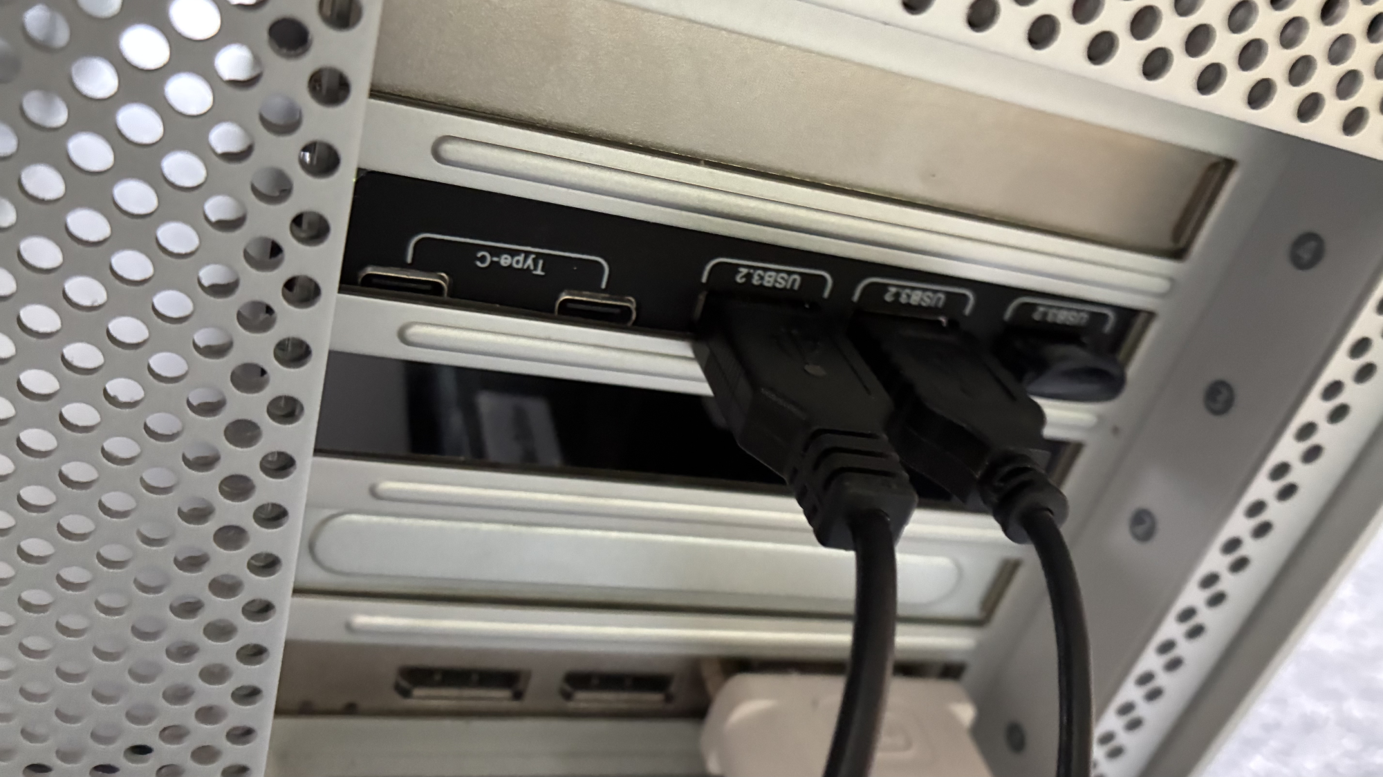

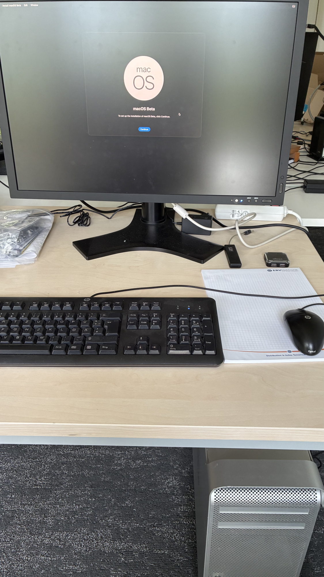

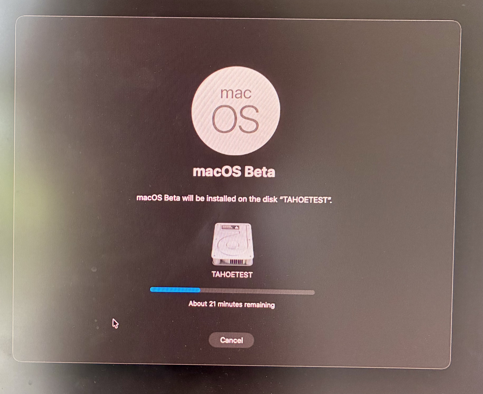

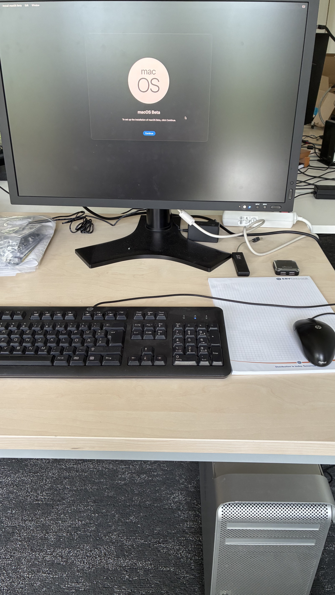

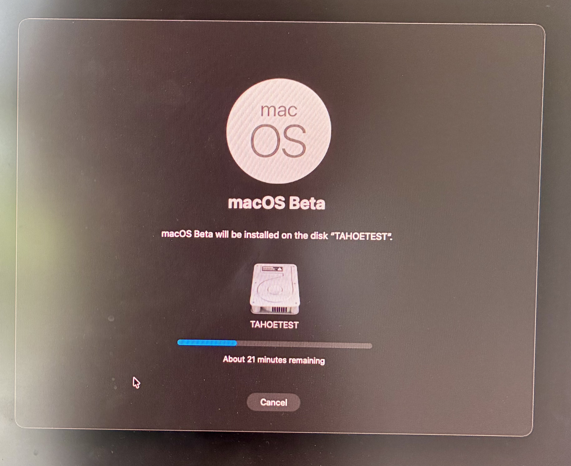

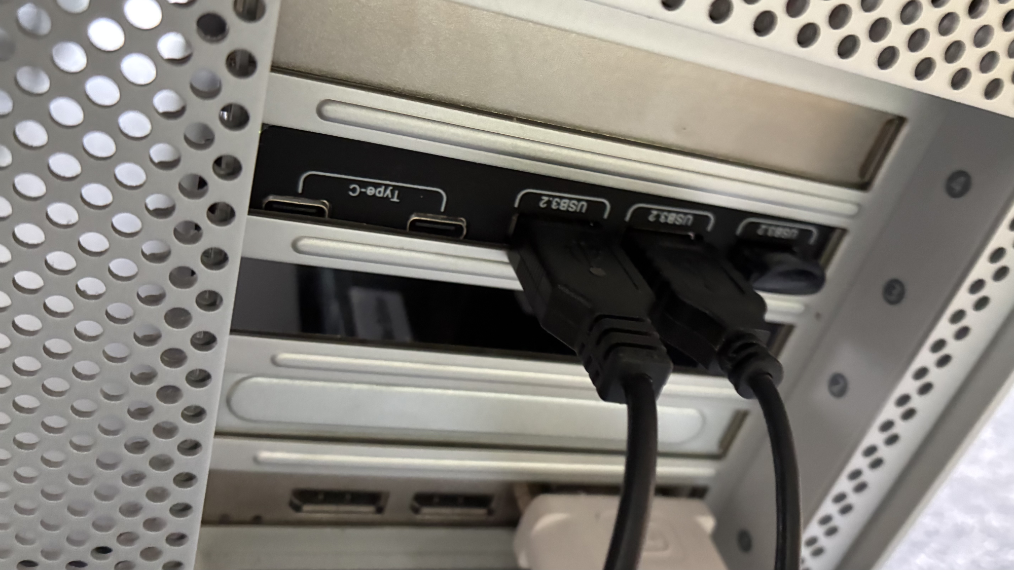

Installer boot for Tahoe successful on MP5,1 (stick prepared with MrMacintosh pkg, extracted to install.app and treated with OCLP 2.4.0 to write to USB stick.
Needs intermediate step USB 3 card though while booting from it.
Sequence: Boot OC EFI, select USB stick installer, boot verbose and wait for "waiting for boot volume" error or crossed halt icon appears. Then unplug USB stick from USB 2 and reconnect on the fly to USB 3.
Booting resumes (!) and after a while the install menu appears (or the missing mouse/kbd blink sequece - then replug the mouse / kbd also to USB 3).
Needless to say: Result of the installation will be at least dubious and no current patches are expected to work any miracle ;-)
Update: 2nd boot/install stage now running, leaving "17min. to complete"
Update2: Setup assistant fired up with blue blurry Tahoe wallpaper. Cannot set new user due to crash and restart.
Tried to migrate a previous user instead, now crashes during reboot phase to complete migration.
...so close to the Finder now - almost in reach ;-)

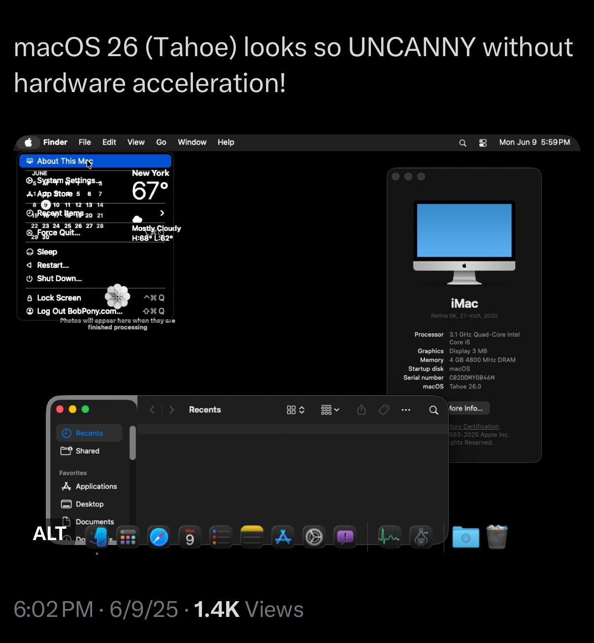

Will try this on a i7 machine. Suspect heavy usage of AVX 2 commands somewhere on the process!

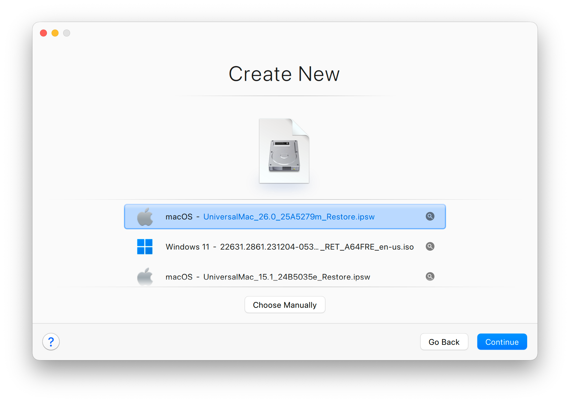

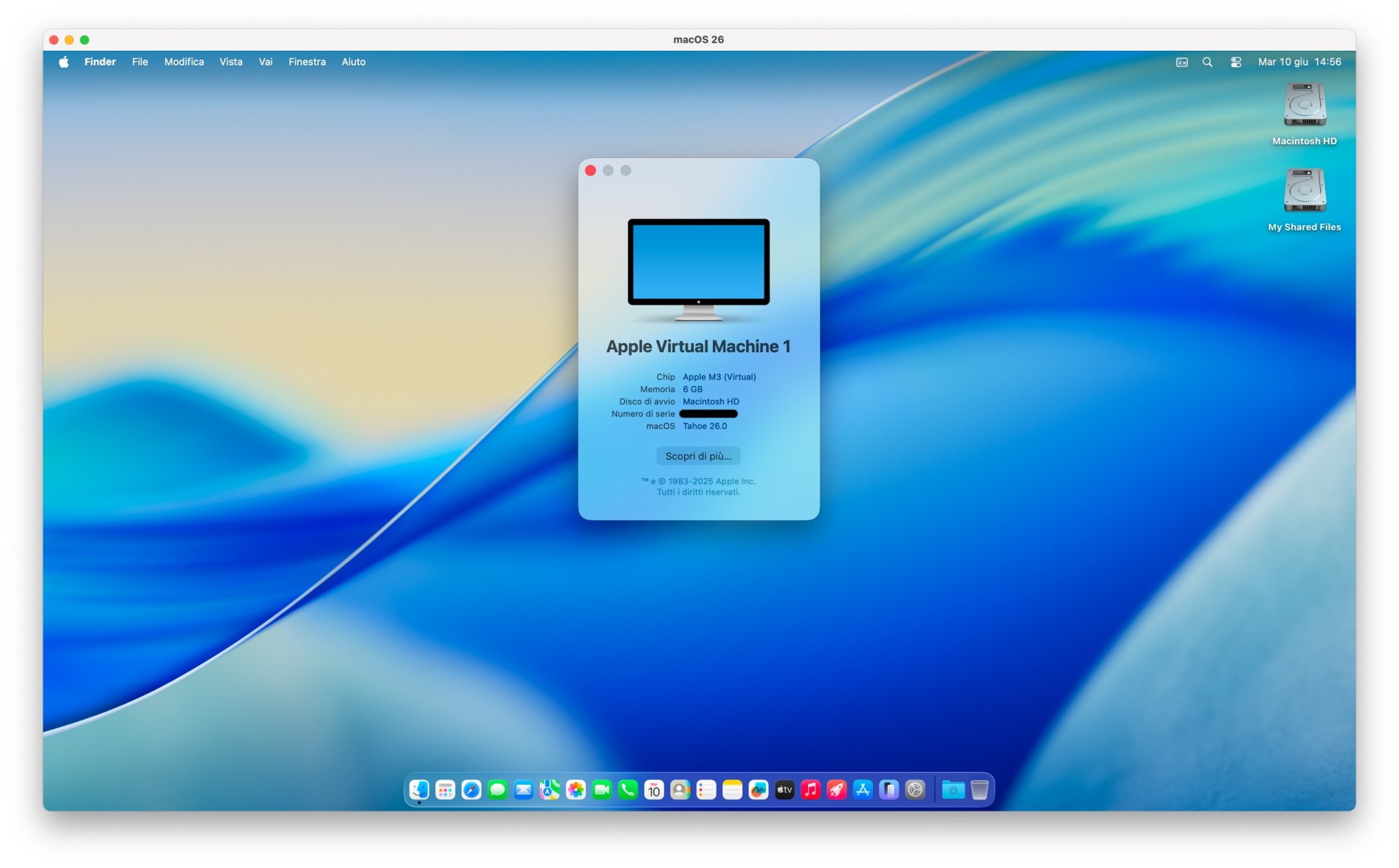

… In the meantime, macOS 26 Tahoe Developer Beta 1 works perfectly as a virtual machine on Apple Silicon; here, in Parallels Desktop 20.3.2, on an M3 MacBook Air:

USB drive is disconnected during boot - currently only USB 3 works as a remedy. Of course not easily feasible on MacBooks as it is with PCIe slots in a Mac Pro.
Nothing to do with T2 (which is also not present in Mac Pro).

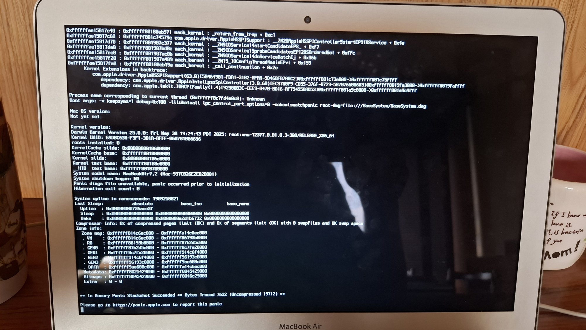

Same happens here on my MacBook Air 4,2 and MacBook 6,1.
