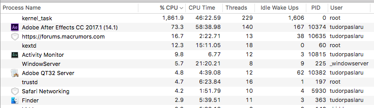

2.
Also, sometimes, the fans are going mad, the computer is very slow and the kernel task in activity monitor shows about 80-90% CPU usage. This is happening randomly, while watching youtube for example or writing in microsoft word.
