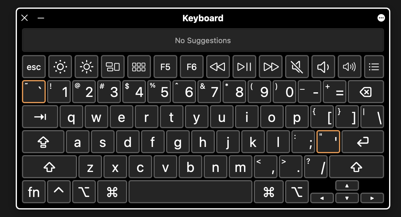

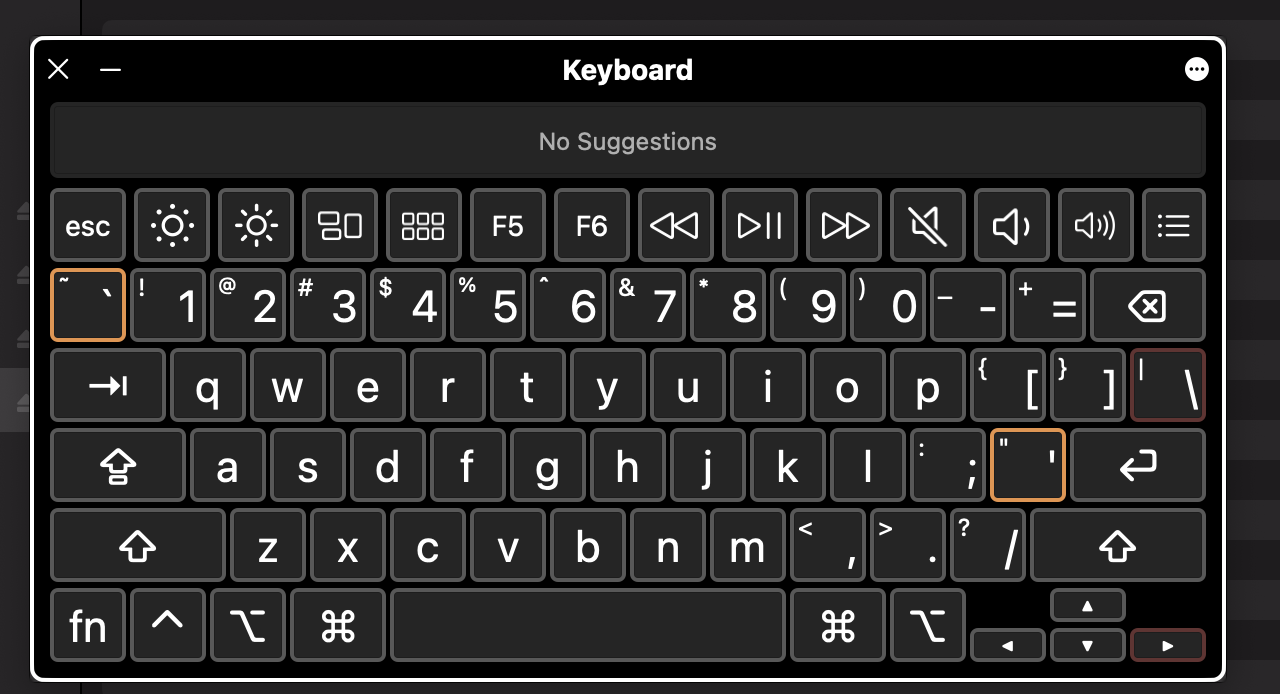

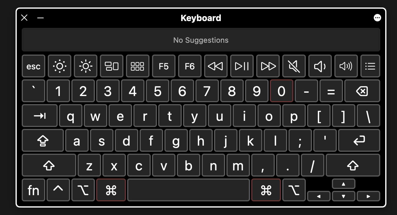

Hi. Thanks for the reply. This only started today. Nothing happened to it, or my computer far as I can tell. The keyboard came with the iMac, 2 (Wow now the "zero" button does not work, nor does the right parenthesis button. I had to copy the "zero"and ")" symbols from a webpage to type this sentence.)
Anyway its a 2019 iMac with original Magic Keyboard and mouse.
I did try your suggestion and by golly you are right. Here is are some screenshots.
Screenshot 1 .....You can see the 2 keys highlighted and I am not even pressing them, or any keys at all.
Screenshot 2......this is what is shown then the 'zero' key is pressed.
Screenshot 3......this is what is shown when the left arrow key is pressed
Screenshot 4......this is what is shown when the right arrow key is pressed
This is absolutely baffling.
