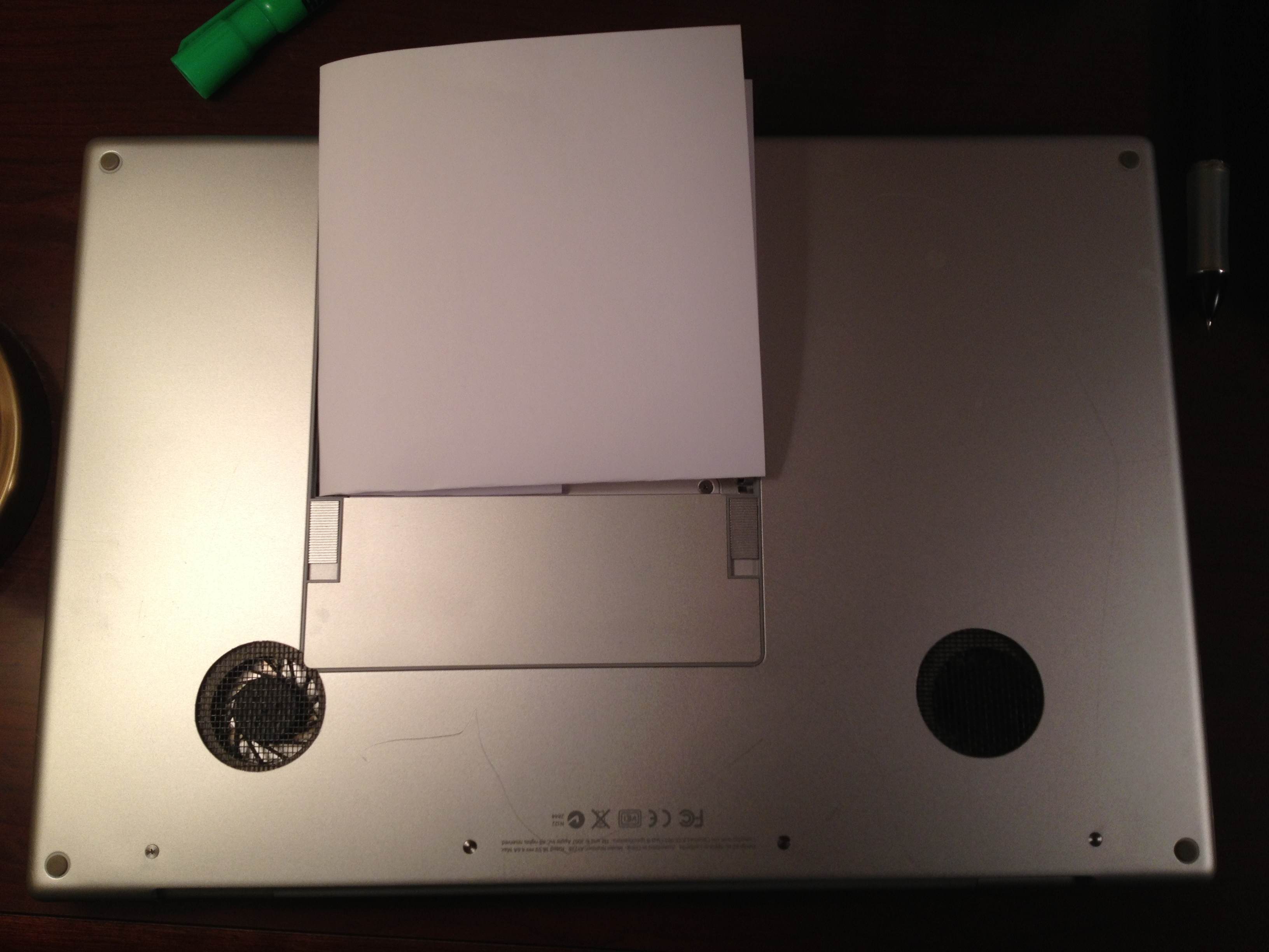

1- Clean fans and radiators
2- Replace thermal paste
3- Improve seal between fans and radiators with 3M 105*C electrical tape
4- Drill 35mm vent holes in case bottom under fans & add covers

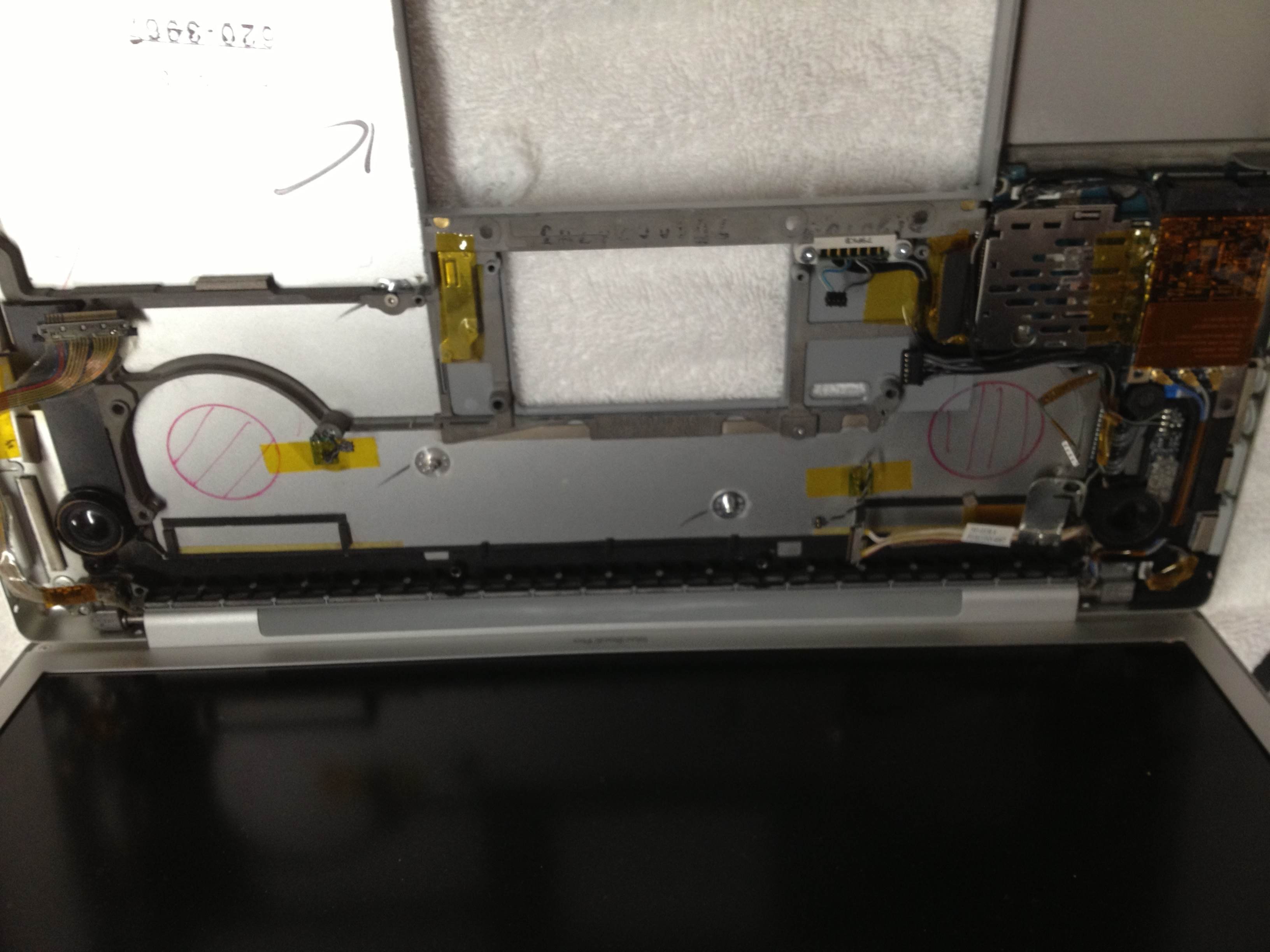

- THERMAL PASTE - Cleaned with 99.99% iso alcohol then ArtiClean and lens tissue. I wanted to use Thermal Grizzly Conductonaut for max thermal performance. But the MBP has some ALU at the edges of the GPU & CPU heatsinks so that would be impossible to isolate relaibly. I used Gelid GC-Extreme which I find superb for the low pressure, sloppy heatsinks of laptops. The Apple factory & refurb paste jobs were atrocious BTW; fitment with only 5 screws for 3 dies is weak.

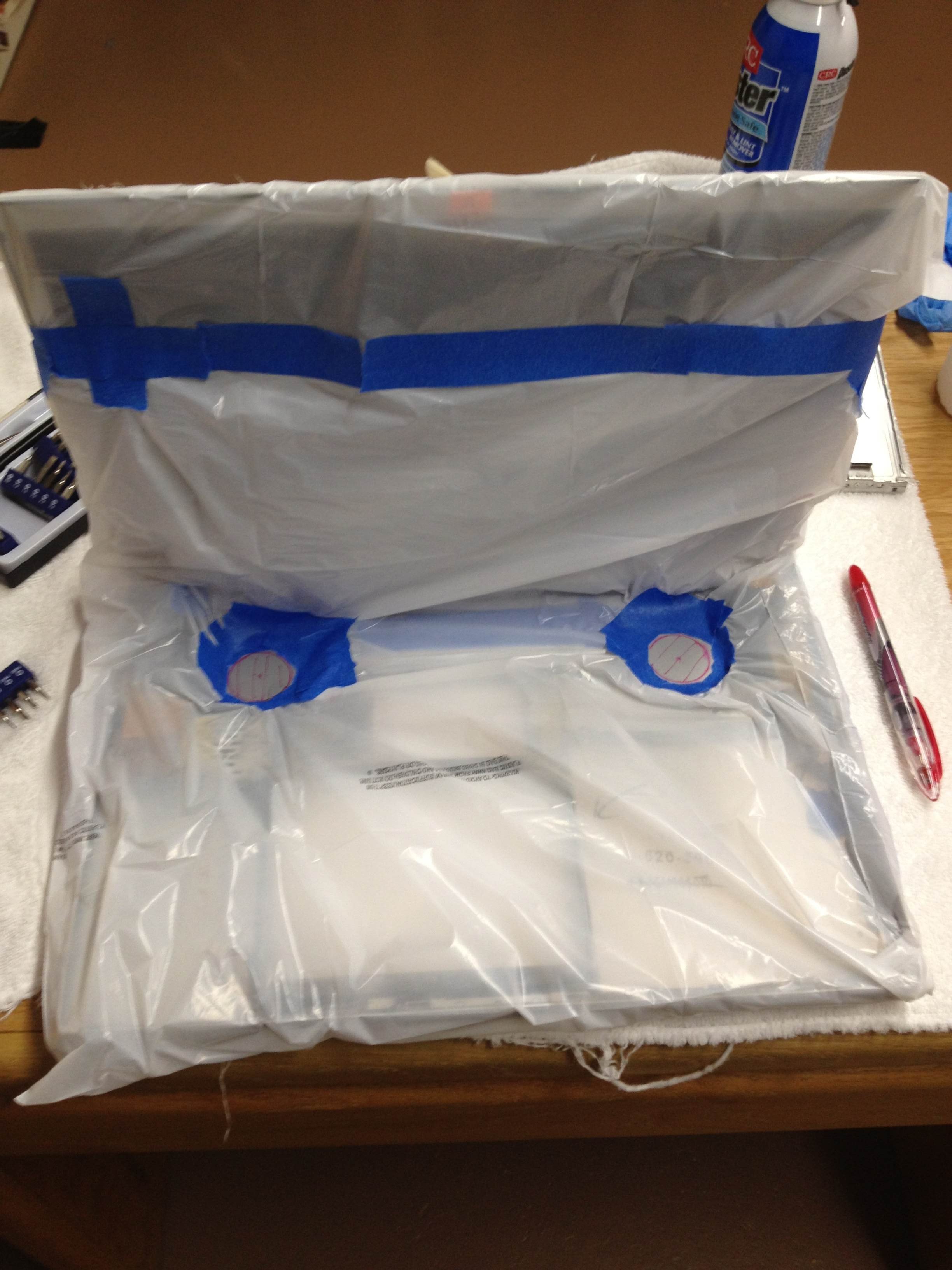

- CUT VENT HOLES IN CASE BOTTOM- Rush job so did not want to entirely disassemble the laptop before drilling. Drilled increasingly large pilot holes in case bottom at fan blade center. Used Milwaukee Hole Dozer for large diameter holes; cut the ALU in 10 seconds. Finished with Swiss micro files and some sandpaper. Despite a good masking job with polyethylene sheets and blue tape, Keeping ALU flakes out of the remaining components was nearly impossible. Pro tip: completely disassemble ALU case bottom and remove screen; will save time.
- BUILD INTAKE COVERS - Wasn't quite sure how to make plastic rims and mesh grilles. I purchased a bunch of plastic and rubber grommets. In the end I just put some fibreglass screen door material between the case bottom and the fans (no grommets used). The screen is taped with 3M electrical tape but really held in by pressure from tightening the fan screws. I will need to monitor as the screen could make contact with the fan and deterioate over time. I tested the screen extensively to ensure it does not conduct electricity, even when damaged. Also, the screen does not provide great protection for the fans. But they do allow excellent airflow and some protection.

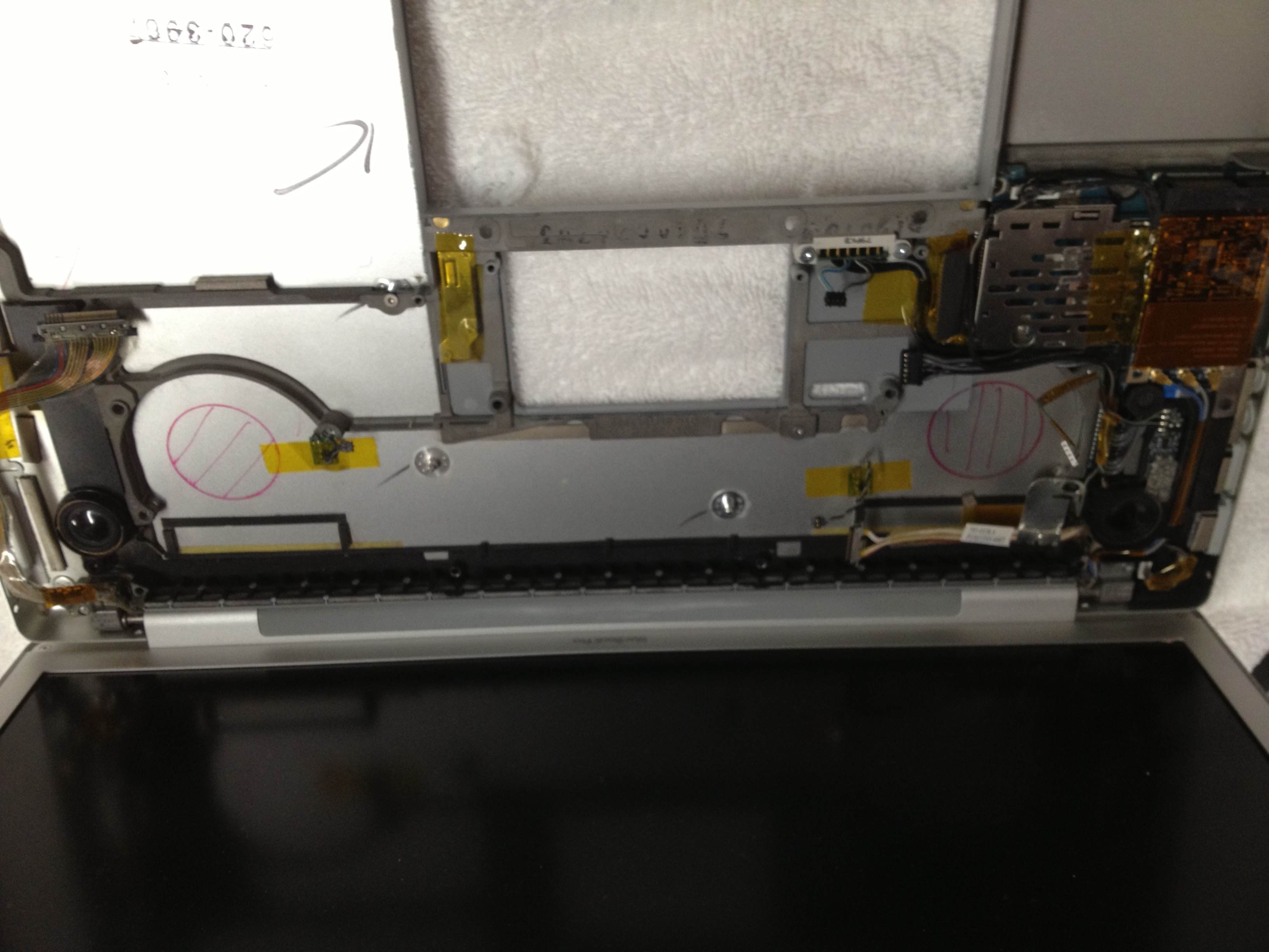

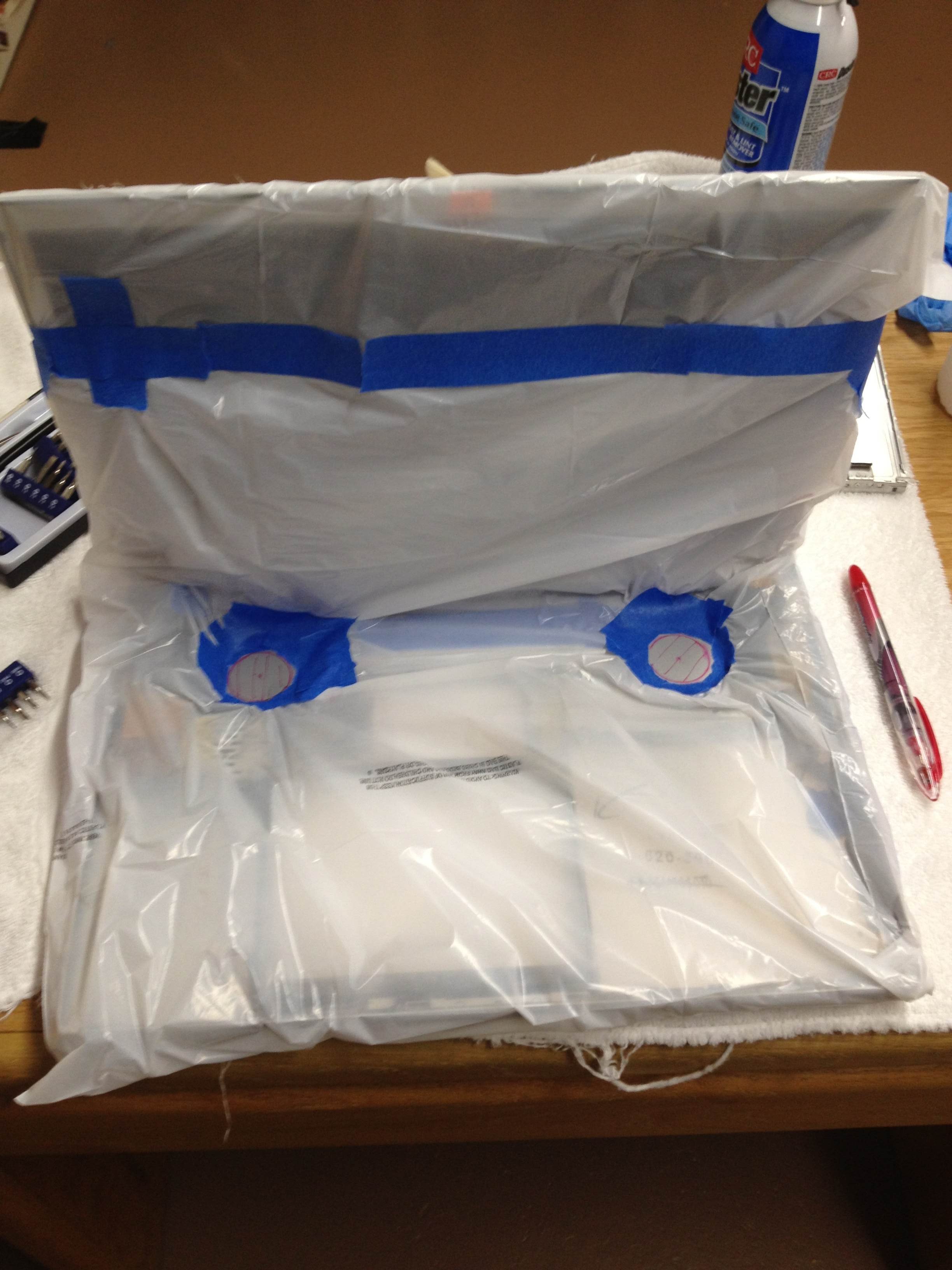

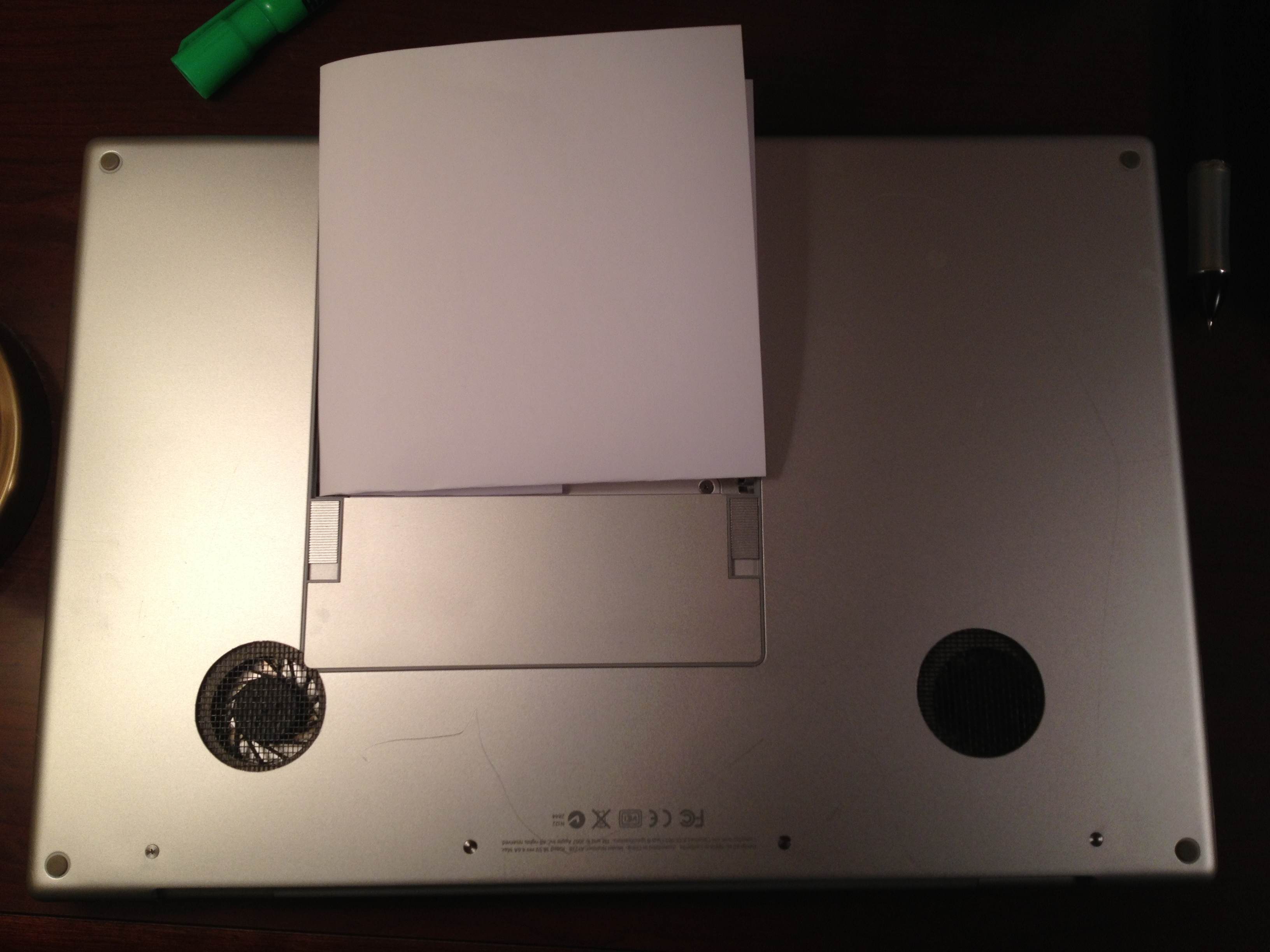

- Youtube before: 80*C+ (fans 6000 rpm)
- Youtube after: 55*C (fans 2000 rpm)
