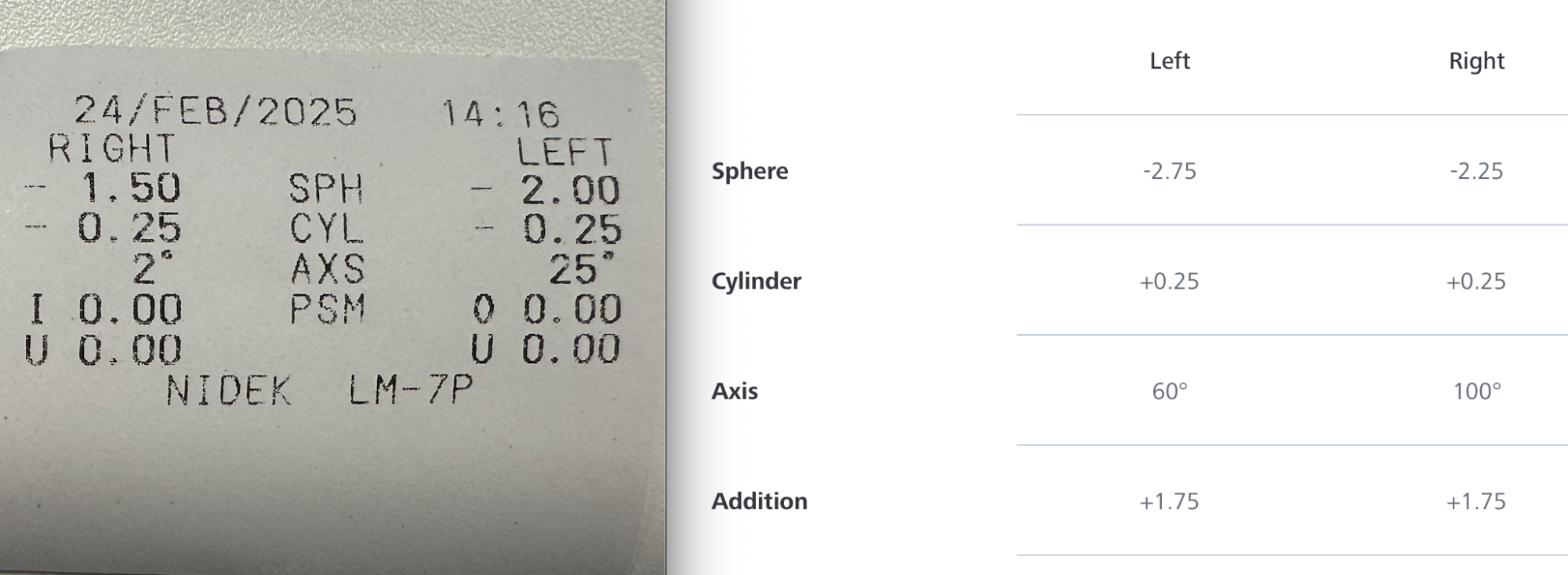

I started to get suspicious that perhaps the lenses were the wrong prescription so after speaking to local opticians I found one that was prepared to measure the prescription in my glasses vs my insert lenses (both distance).
My glasses showed a minor deviation from the prescription, a value I could dismiss as being introduced my the measuring optical device. The Zeiss lenses deviated far more significantly and now I am suspecting they are the cause of the headaches.

Left image: Measured values provided by an optician of the Zeiss inserts:
Right image: My prescription and the values shown on the Zeiss website for my order.
So.. is the 0.75 sphere discrepancy on both lenses required/intentional to work with AVP or is it a mistake?

When I got mine they had the astigmatism axis off by 90 degrees. Pretty easy to tell just by rotating them. Took three tries to get them to actually read the prescription properly and make the right lenses.
OP's seem to be 002/205 vs Zeiss 100/060 according to the measurement; although I can't say if that makes a big difference with -0.25 cyl; my own -3.5 it certainly would.

  3. Without the AVP, maintaining the inserts at a similar position to my glasses - Yes, the inserts brought things into focus. I fixated on the wall about 7 to 8 metres away. I could see the texture of objects hung on the wall better with my normal glasses than with the inserts. Truth be told, if I hadn't been looking for a difference I don't think I would have noticed it. I swapped between my glasses and inserts several times to be confident about my comparison.
Point 1 helped me appreciate more the obvious fact of just how essential lens inserts are for anyone with distance correcting glasses. It also left me thinking that perhaps the image could be sharper for me. For example when watching the Alicia Keys immersive experience I started to think that some of the foreground items in the studio were slightly blurred and that my general experience is also compromised.
Point 3 (unless I was positioning the inserts incorrectly) strengthens my opinion that the 0.75 discrepancy might be a mistake and not a required offset for the AVP. But is it really enough to cause eye strain/headaches?
