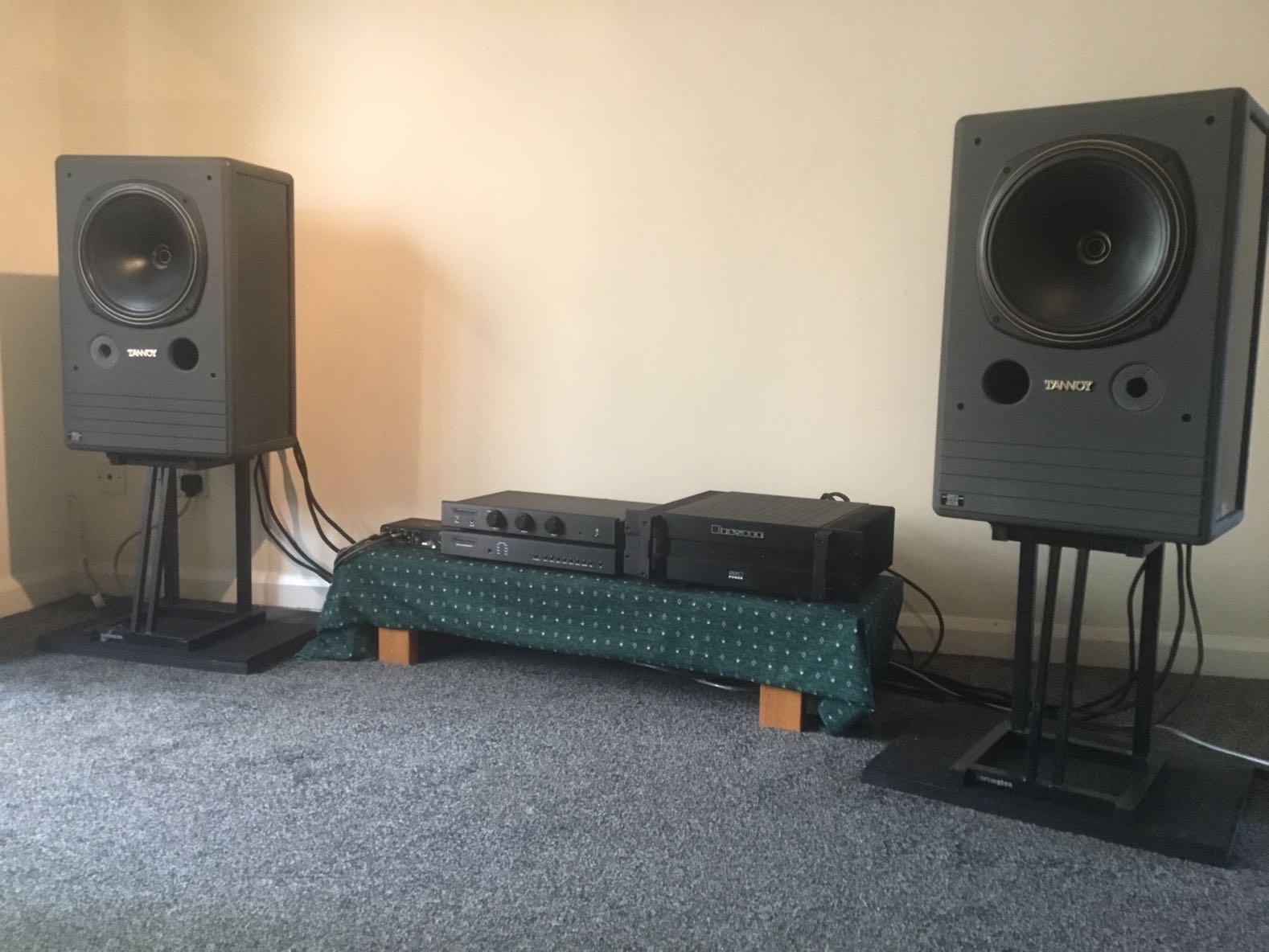

Pic - Bryston BDA-2 DAC, BP6 preamp, 4BSST amp, Tannoy System 12 DMT mk1.
I output USB-C from my Mac Mini M4 to the DAC, and also use a soundcard which outputs S/PDIF to the DAC.
I also use a Beyer A20 headphone amp with this setup. Well recommended.
Most soundcard and preamp earphone outs are a bit weedy.
I would say, buy a 1.5m SUPRA USB cable for your DAC. Very nice sounding cable, and cheap ($40).
I did use Van De Hul 102 mk3 signal cables. Great quality, and a smooth sound. Used eBay bargains out there. On a budget, then cheaper QED models, or Van Damme silver-coated ‘touring’ cables are decent.
My present cables are over £3000, a bit much for you I think!
This pic is purely for inspiration, and to show how it’s done when money is no object, but room-size, common-sense, and extensive research, keeps you realistic (no 15” drivers).
This system was built for accurate, flat studio monitoring, and has been tweaked and customised extensively.
