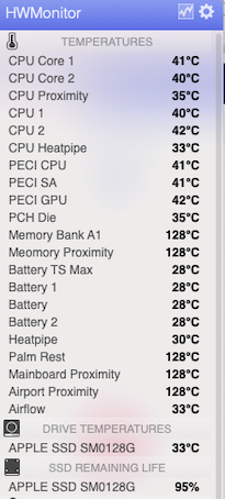

Here are the temperatures recorded by HW monitor. On the Internet I found that I can freely neglect the memory bank temperatures, since they're not there on the board.
I'm writing these messages on this MBA, and I can use it normally except there is a loud full speed fan if macs fan control is turned off. So the issue I'm experiencing appears not to affect the performance but it's not that convinient hearing loud fan during system boot. When macOs is loaded and macs fan control application is loaded, the laptop becomes very silent. (macs fan control is adjusted to control CPU temperature).

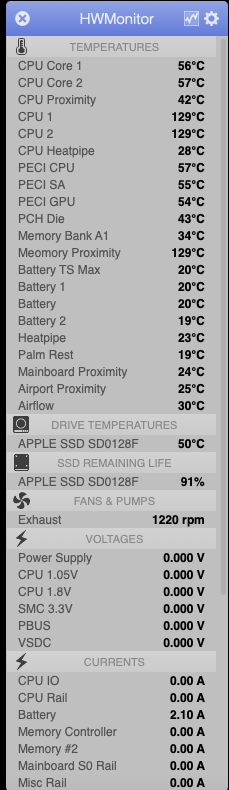

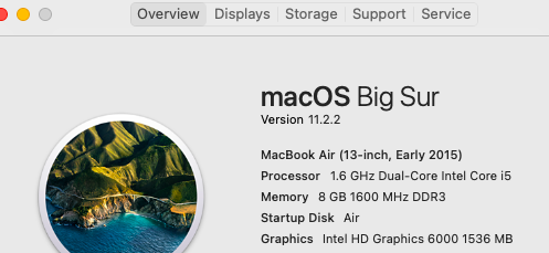

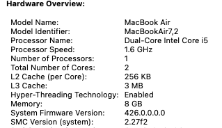

I attached HWMonitor screenshots from an Air.
Thank you. Very helpful. Now, I know, that "meomory proxitimy" doesn't exist. I thought that airport proximity doesn't exist either. I'll investigate the schematics to try to figure out what is mutual for all other 4 sensors. I have closely inspect all parts of the board under magnifier and couldn't find obvious traces of the corrosion.

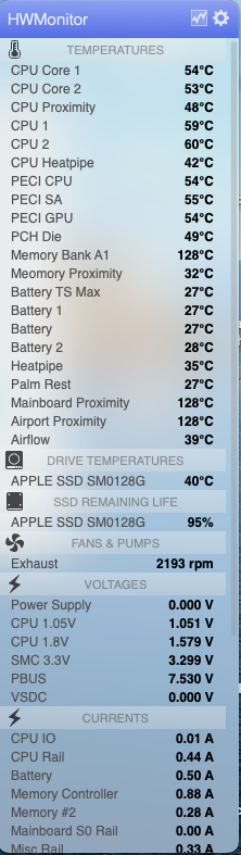

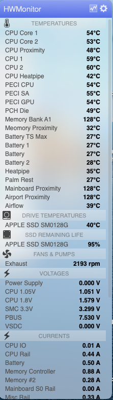

Just want to update. I managed to solve the problem and the cause was not trackpad nor flex cable nor LIO board nor its cable. It was unfortunately waste of time, but the appraoch is to try first what is more probable cause. The actual problem was faulty "Multiple Channel Temperature Sensor" U5810. This chip caused disbalance on SMC 3 bus. It works even without it, even thought three temperatures (memory, mainboard and airport) are out of range. Removing this chip restore Plamrest temperature reading which was the main reason for full speed fan, but also limiting CPU frequency which was not noticeable when working with less intensive applications. Trackpad is on the same SMCBus and in 9/10 cases it is the cause of the problem when reading palmrest sensor out of range. However this was the case 1 out of 10. I have ordered a new chip and will wait some time until arrives. In the meantime, I can use my macbook without any limitations. HWMonitor screenshot is attached. I'd like to thank Audit13 once again for his HWMonitor screenshot , because I didn't have "known good board at my disposal to compare".
I hope this can help someone.
