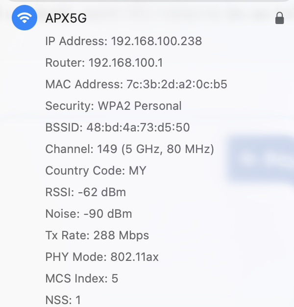

I went through the whole troubleshooting process with Gemini last night...
As you can see, SNR is not too bad, but Tx rate still fluctuates wildly. All speeds I mentioned are Mbps.

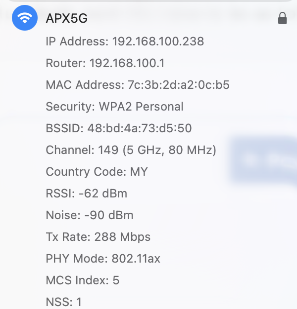

Good call. Gemini is not perfect, but it does look like you have a relatively good SNR there. Does an ethernet connected device plugged into the modem get full speed? If so at least you can isolate wifi vs wired.
The only thing I see as a flag there is NSS-1. One stream
You should see 2 not 1.
That and 62dB RSSI- it's at the limit of dropping the connection or modulating the throughput
Your other devices-if they are connection on 2 streams will get double the speed- and will not modulate
Are you doing anything different at all on that device? I'm thinking specifically USB-C keyboard or mouse that is connected to it and isn't used on anything else. That'll do it. USB-C hub (- that is, USB-3 specifically which interferes with wifi) USB-C hard drive? Anything like that?
If so, unplug everything like that and see if you get NSS-2
Other possibilities? Driver issue, plist file...
Did you have the machine repaired because it could be an antenna issue. Did you have the screen replaced?
In any case, NSS-1 is what you need to hone in on.
