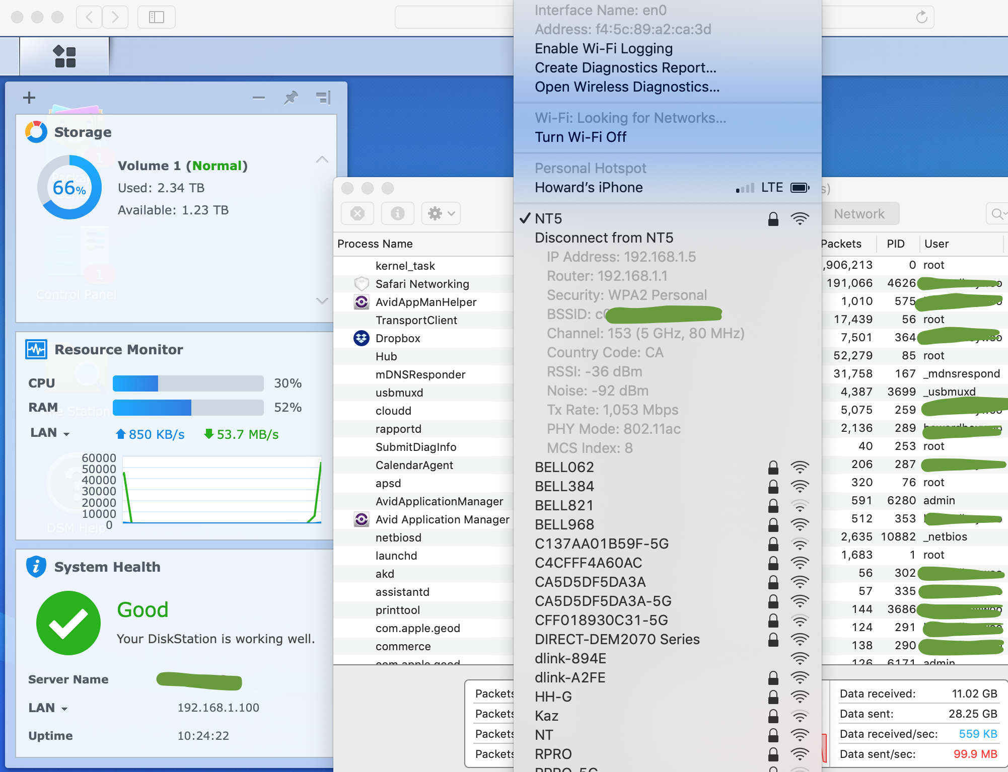

What does option click on the wifi show when you’re doing an upload and download? Can you provide screen shots showing activity monitor and your wifi details?

You should be able to capture much of this with a single screenshot for each direction. This is a download, you can see that the download is just ramping up but the signal strength is good and the NAS is not working hard.
