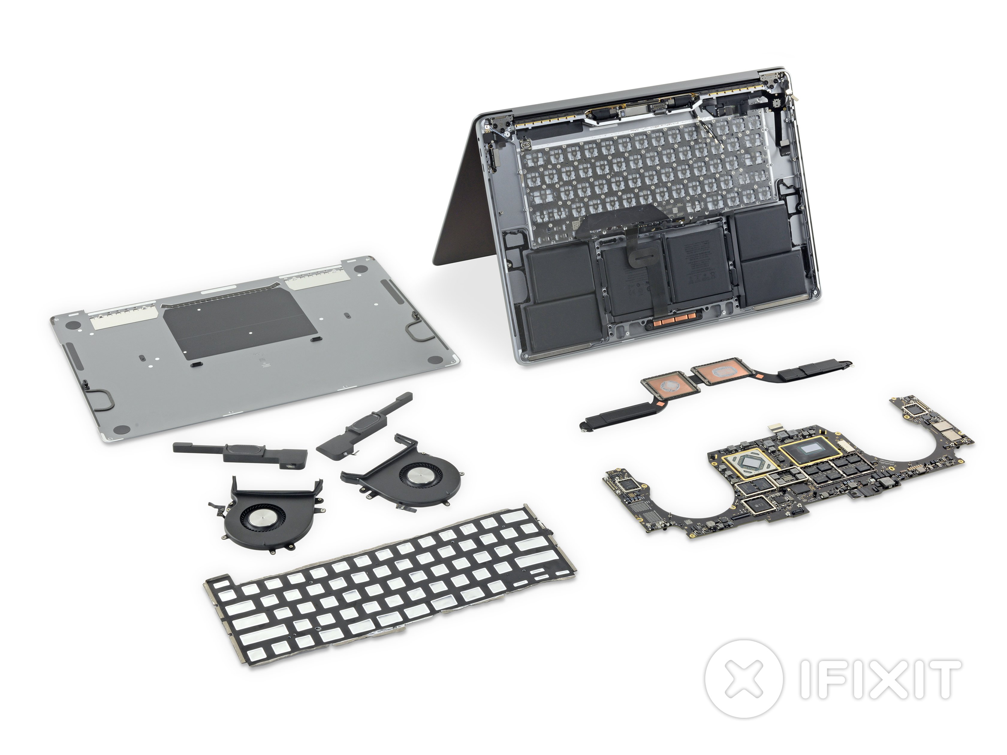

As far as I can tell. The Wi-Fi and bluetooth module is integrated in the motherboard. It is not replaceable.

I can also confirm, from the Apple service guide for this model, that the WiFi/Airport card is integrated into the board. This means that repair involves replacing the logic board so a backup of all data is needed before submitting for service.
