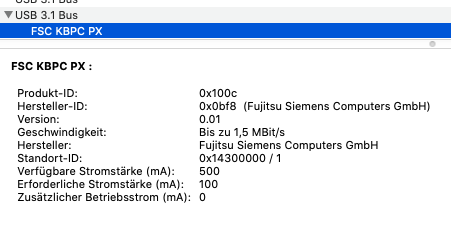

I own a older (but good) USB Keyboard. Unfortunately, it only works if I reboot the MBP. If I make a "hot plug", it will be identified as HUB and not working correctly.
USB-Info after fresh reboot:

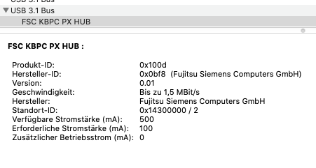

USB-Info after "hot plug"
As you see, It alters the Product-ID (from 0x100c to 0x100d).

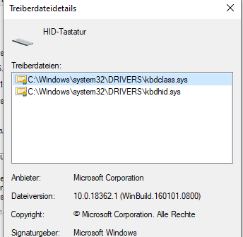

Yes, but Windows uses his "normal" HID keyboard driver.
