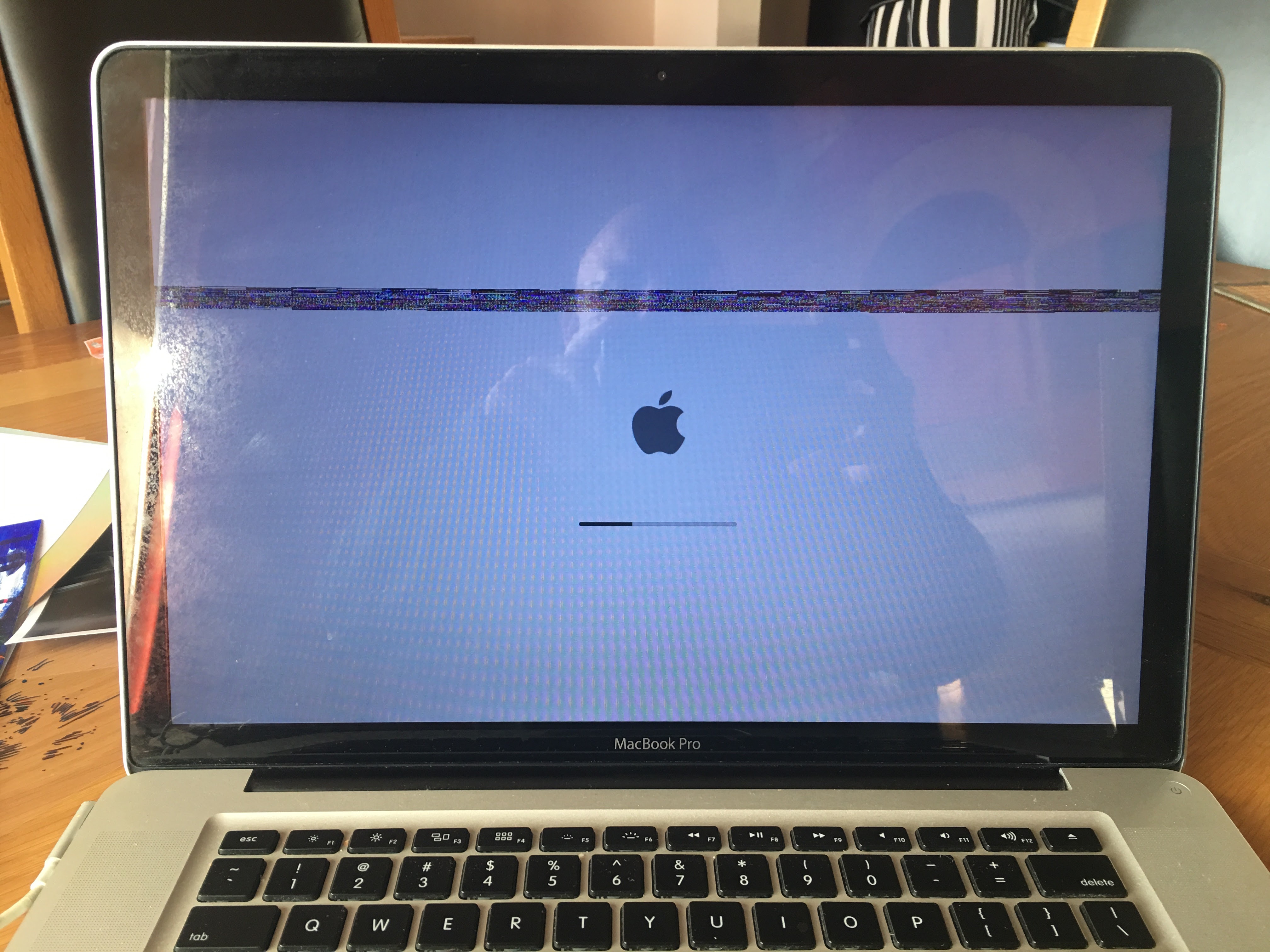

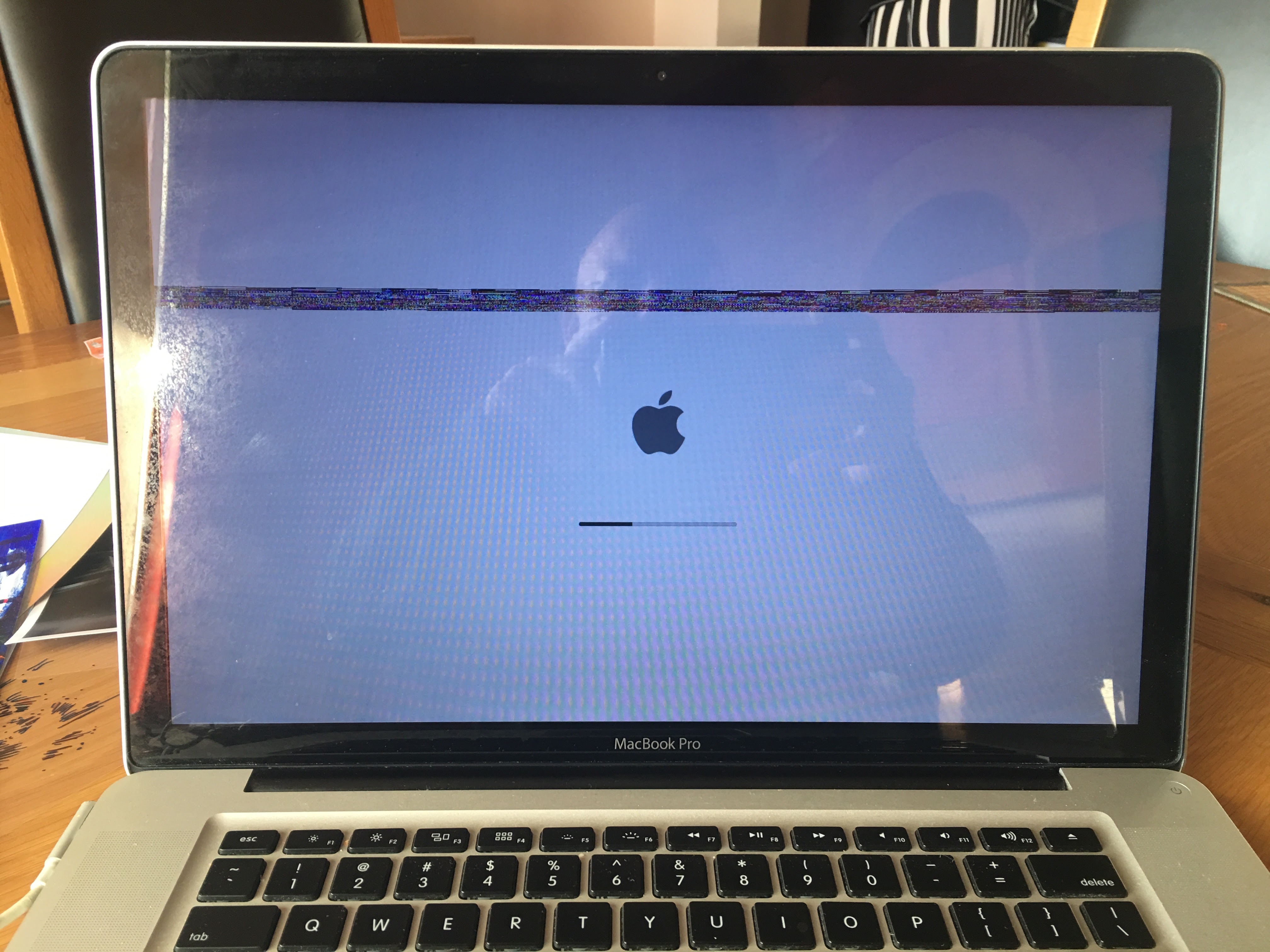

When it does chime it gets to a white lined screen with apple logo , start up bar gets about half way, then it either freezes or goes blank, attached image will help explain.

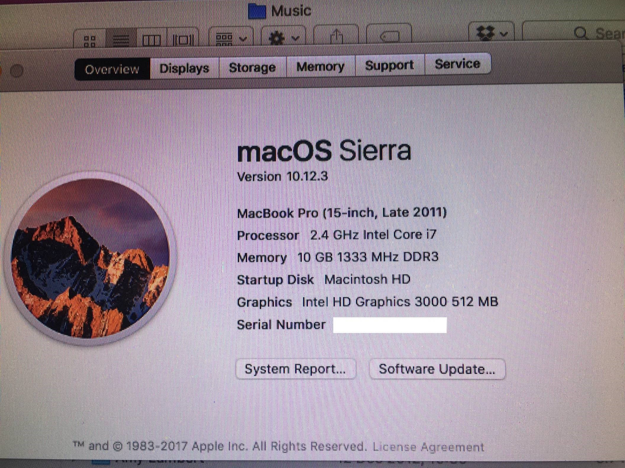

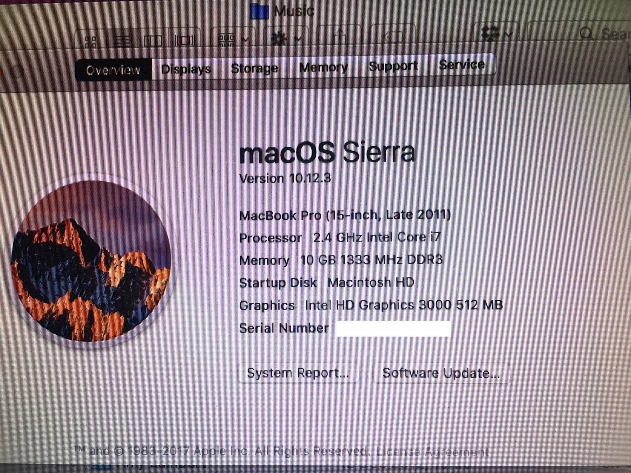

GPU is failing, which is a common occurrence, there's not much you can do with it, and given the age, I'd look to replacing it.

Its a design flaw that basically meant that the GPU was going to fail at some point. Apple had a repair program but that ended last december.
With that said, the repair program only replaced the bad logic board with a repaired logic board so the inherent problem remained and it would be a matter of time when that repaired laptop failed again. I say this, so you don't feel bad that you missed the deadline for getting it fixed.
