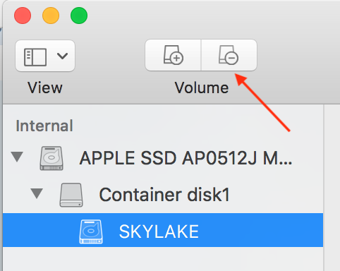

If you are trying to erase an APFS formatted drive with Disk Utility you need to delete APFS volume from the container before trying to erase the drive. The container needs to be empty.
See screenshot:
Reactions: organicCPU
I see, thanks. so I boot from the external drive, delete the apfs volume and then format the whole ssd. after that boot into recovery mode and reinstall the OS on the formatted drive? could this screw anything up that can't be reversed?
