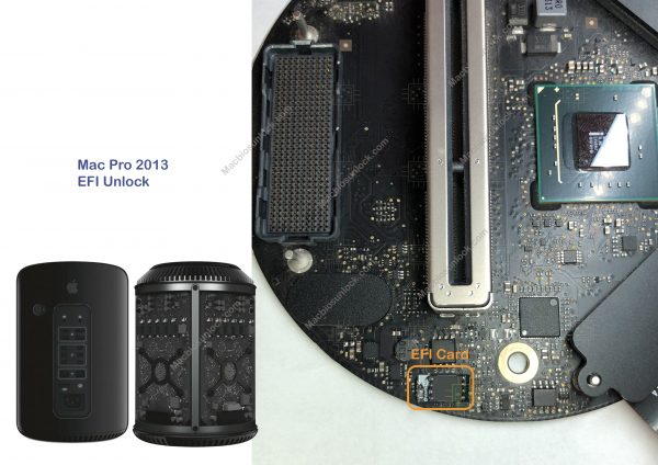

The solution I mentioned above for the pro shop is actually remove the EFI chip on the logicboard, put it on a chip reader to extract the ROM file, then use a hex editor to find and remove the password, then write back the ROM file onto the chip before solder it back to the logic board. It's not a stuff you can do without a proper tool set and skill set.
Something like this:
Or this:
Or this:

I found another resource with pre-programed devices. They also have a version which doesn't require soldering skill. (Clamp version). Very pricey and for repair shops only.
But these are the guidance. You can be creative and just buy a CH341a programer, with a 8pin clamp (about 10$) and try it yourself. (Photo below)
You would need another Windows machine, as the SPI program (or ASP program? I don't quite remember) only run on Windows.
