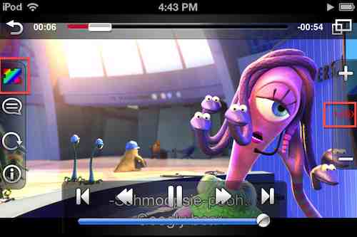

EDIT: tested AVPlayer on old(er) hardware. My complete writeup is as follows:
AVPlayer(HD) & 1080p MKV users on older-than-two-year iDevices, attention!
Answering a question (link with more info & comparisons to OPlayer) regarding AVPlayer running on the iPhone 4 (released in Summer 2010), I've quickly tested the MKV playback in the player on my 4th-generation iPad touch (released in Autumn 2010) to find out whether the question is right. (After all, AVPlayer(HD) is probably THE most recommended generic video player, particularly for MKV playback.)
During this, I've noticed the player didn't use hardware acceleration for any of the Full HD (1080p) MKV videos, unlike on newer hardware (e.g., iPhone 5), where there is no such problem. This includes all my Full HD test MKV videos – for example, Monsters etc. (click the link for the freely deployable, testable video! More links to other standardized test videos below.)
I've continued testing to find out whether this is only an iPhone 4 / iPod touch 4-specific problem and found out that the iPad version of AVPlayer is suffering from exactly the same problem.
However, 720p video (e.g., Harry Potter and Suzumiya) were played back flawlessly, with hardware acceleration. So did, of course, even lower-resolution videos.
After this, I've continued testing on even older, but still 1080p playback-capable hardware: the iPhone 3G S and the 3rd-gen iPod touch (not to be mistaken for the 2nd-gen, 8GB-only iPod touch sold up until Autumn/2010), both based on an even older CPU. The situation is the same: AVPlayer plays back MKV files up to 720p using hardware acceleration but not 1080p ones. While, again, the latter could certainly be possible (see below).
This seems to be a generic bug in both (small-screen and iPad) versions of AVPlayer running on 2009 and 2010 iOS models (iPhone 3GS and 4, iPod touch 3 and 4, iPad 1). These models, again, would all be able to play back 1080p videos (with the 2009 models, almost) flawlessly.
I'll immediately talk to the developers, who, hopefully, very soon release a fix.
In the meantime, just follow my advice below the screenshot.
(playback of the 1080p Monsters test video on the iPt4. Pay special attention to the red rectangle-annotated icon in the top left corner. It's enabled, meaning there's no hardware decoding. (It'd be passive during hardware-accelerated playback.) The same stands for the red and also-annotated 1.00X icon in the center right, showing the CPU just can't decode the video stream properly.)
