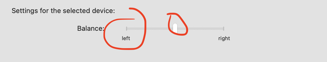

Open sound preferences, slide the thing from left to the middle.
Are you changing the balance of the beats? or some other audio output (the mac's speakers, maybe)
Nope. My iMac’s speakers work fine. Other Bluetooth headphones work fine. Only these Beats on this iMac. The Beats are fine connected to my iPhone. Switch to my iMac, and left only mono.

When I open System Prefs/Sounds - JUST OPEN IT, NOT ADJUSTING IT IN ANY WAY. JUST CLICKING ON THE SOUNDS ICON TO OPEN THE PANEL - I get stereo! Just opening it. Close it, and back to mono. Open it, stereo. Adjust left right, no change. Close it, mono.
