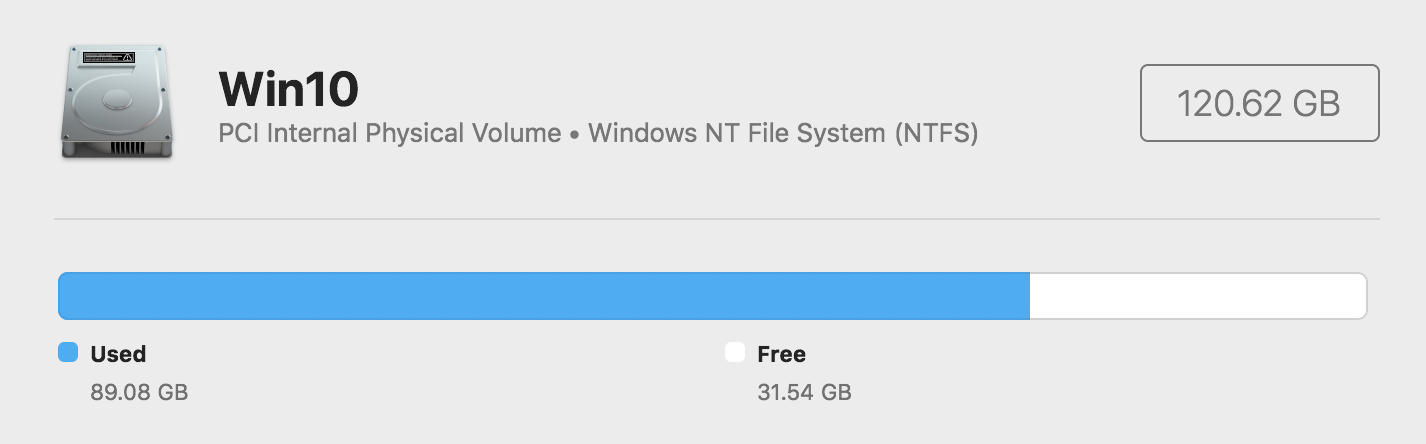

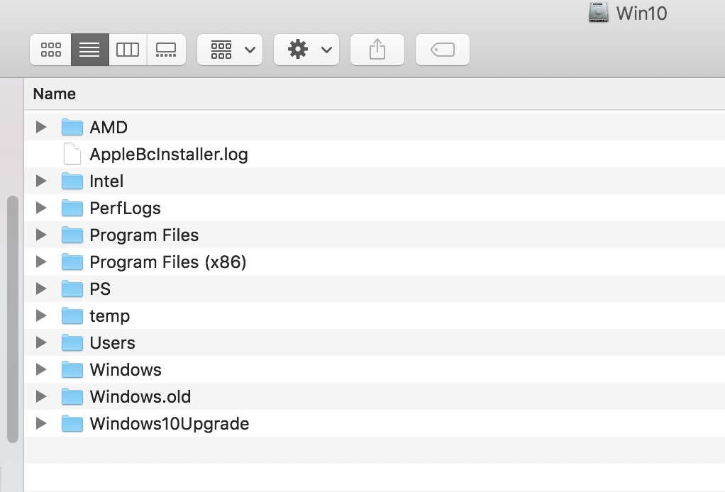

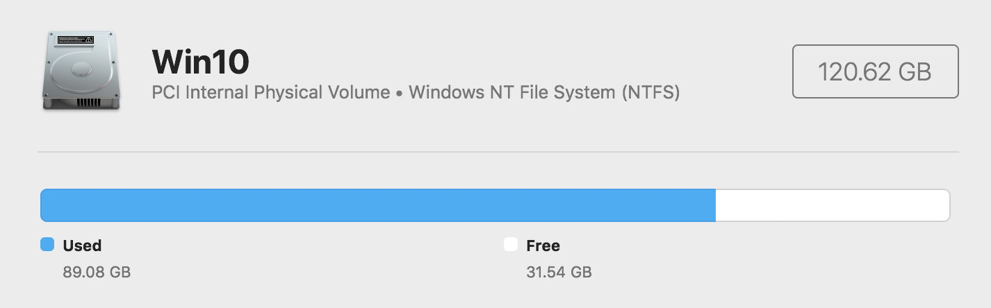

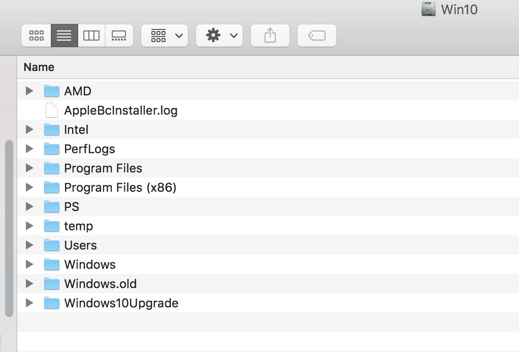

So it seems Mojave messed up my Windows partition on my iMac.
my setup is different then a typical bootcamp set up. I run windows on the internal SSD of my iMac. I split up the Fusion drive and installed windows on that. macOS is being run on a Samsung T3 USB drive.
Whenever I wanted to boot into windows, I'd reboot with the option key down, select the windows drive and viola.
I see the partition in Disk utility so the drive is there
The data is still there, as I see it in Finder
Its not bootable any longer. For instance I shut down my iMac, and unplug the T3. On powerup, I get the question mark folder. I beleive I was running in windows for DP1, but now with DP2 its no longer bootable.
I thought it was safe because macos is running competely on the external SSD.
I'm not sure what I can do to get it back to being bootable. 🙁
