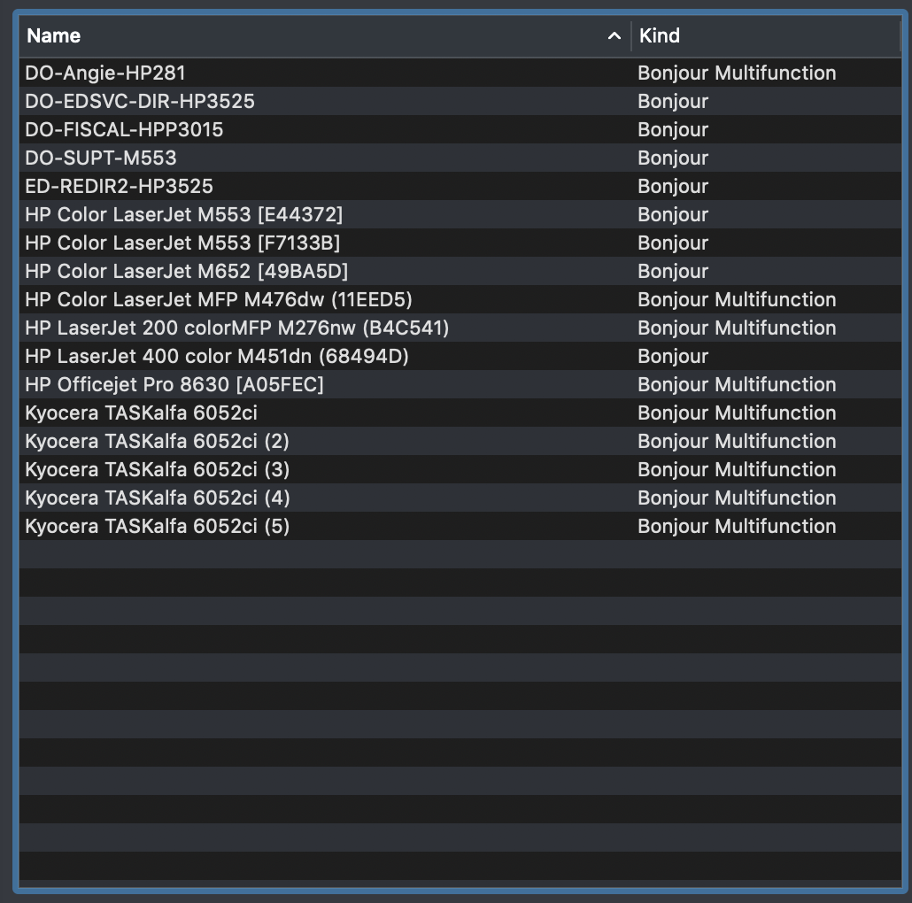

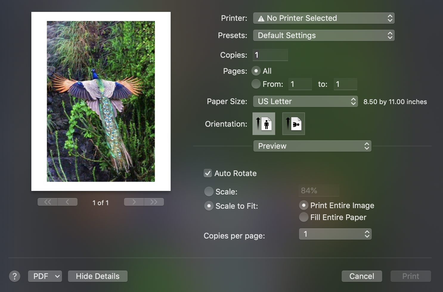

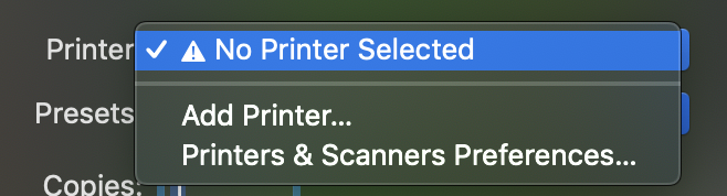

Lately, when I go to print from anything on my Mac here at work, I get the very long spinning rainbow ball. When the print dialogue finally opens, it says that it can't find the printer then gives me a list of every printer in the building to choose from, all of which say "Bonjour" or "Bonjour Multifunction." (I have attached screenshots of the Printer dialog thing, the message in the drop down, and the list of printers that comes up when I select "Add Printer." Selecting any of the printers displayed does not work.)

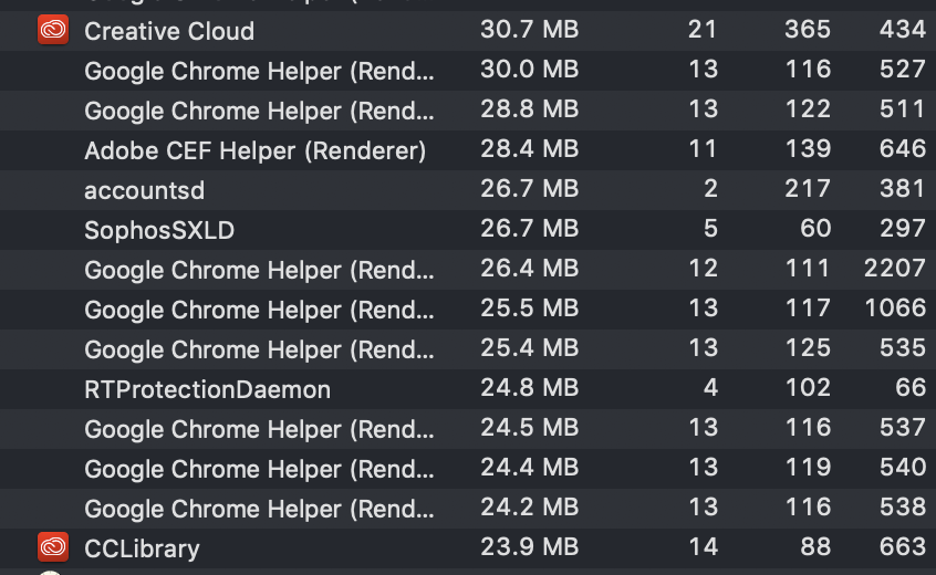

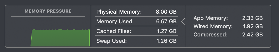

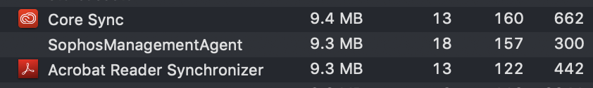

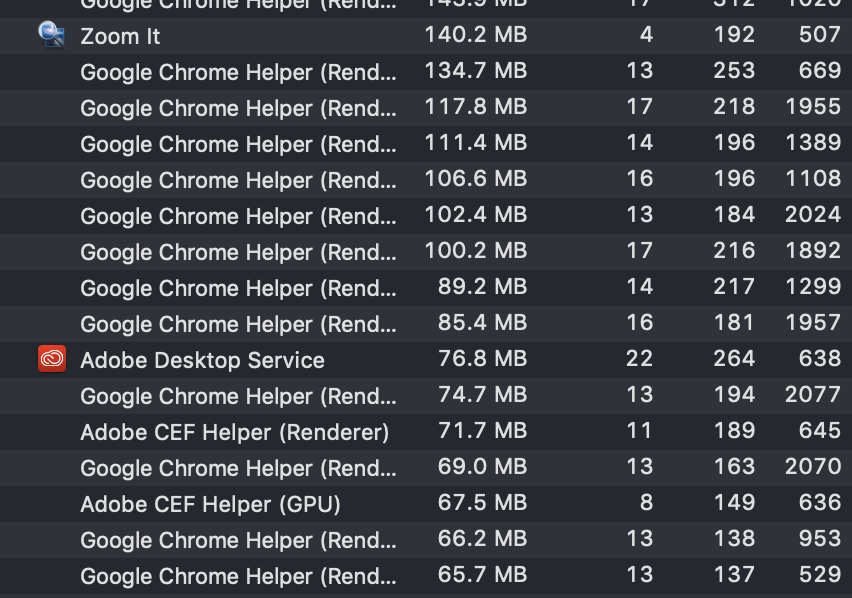

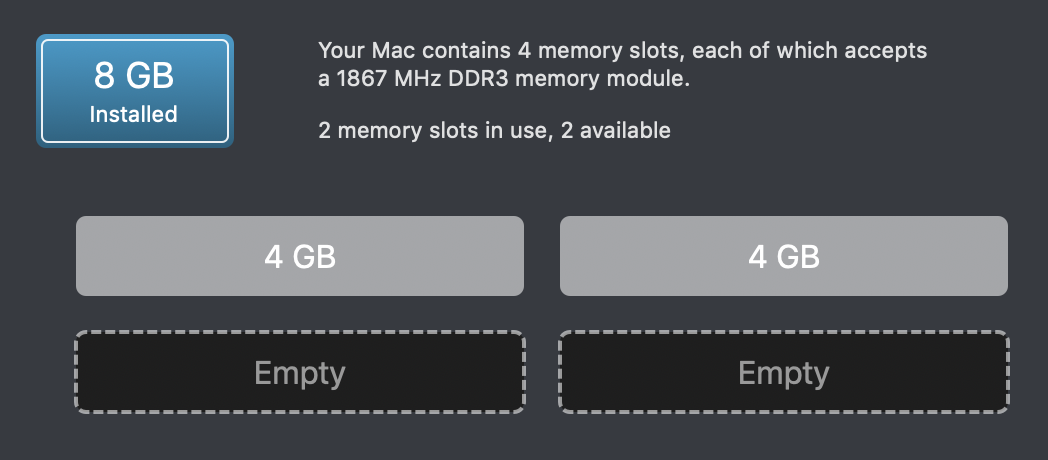

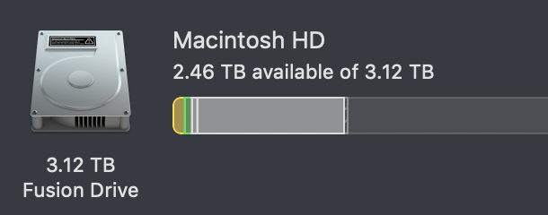

Here are screenshots of more specs and stuff from my activity manager. I don't know why zoomit and and all the Creative Cloud stuff seems to be running. I don't have any of that open as far as I can see.
Anyway, I don't know why shutting down and starting up doesn't work every time. Is restarting better than shutting down for clearing up things that might have gotten tangled? Does restarting do something different? or is completely shutting down the best of the two choices?

As mentioned before:If it's your company's computer, then it is up to them to maintain it and keep it working properly.
Nevertheless ,reading your posts and looking at the screenshots, perhaps on a few things I could give some general recommendations ....
I assume it's an iMac ,but anyway , with Os 10.14.6 and only 8gb of RAM installed, this computer will slow down easily (spinning beachball) when there are many applications (left) open.
Both ways the Mac "cleans up" a bit and starts with more speed than when its loaded with lots of apps/activity.
-If you look at Preferences>printers , on the left side you'll see used/available printers . If you could find it which one you use, on the bottom there's button where you save it . Another way is to store it as "printer used last time".Both ways the correct printer will be used.

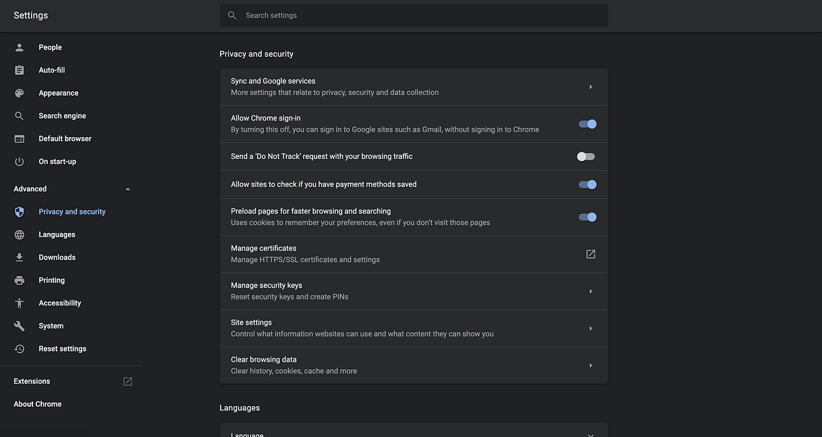

-I saw a lot of Google Chrome activity, and found a site that may help to solve the issue:
-If you go to preferences>users>startup items, you can see all the apps that load at start up. You could remove all the apps you don't need constantly. There's no risk involved, you could even remove all of them.
