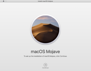

I'm going through the possibilities of installing Mojave on a 7,1 Mac Pro. Please don't reply if you feel compelled to only say it's not possible (not interested in hearing defeatists rant on and on - please go enjoy your Catalina experience). Defeatists aren't useful - they're just thread destroyers.
In computing almost anything is possible if you have the right tools. Certainly they ran Mojave on the development 2019 Mac Pros, and Thunderbolt 3 existed since 2017 for Mojave installs. iMacs, MacBooks and MacMini's from 2017 had Thunderbolt 3. Same with T2 chip (since 2018)web. On a Polish site they showed how Mojave already had the built-in PCI port configurer app for the 2019 Mac Pro, among other 2019 Mac Pro kexts and system core apps.
Would like to hear from anyone who can be helpful. Again, if you want to say it isn't possible, thank you, you've already been heard from in other threads that tried to discuss this - so please don't hijack this thread (use your powers of defeatism somewhere else). The fact is, there is no reason Mojave can't be force installed on a new Mac if you turn off SIP and the T2 chip (which I've already done). It is possible to hack the installer to think the 2019 is an approved machine. I'm already running my 'Users' folder on an external HFS+ drive (this is not approved of but works fine). I'm running High Sierra off on an internal HFS+ SSD in a 5,1 Mac Pro - told I shouldn't do that. Well it works better than when it was formatted as APFS (horrible file system) much faster boot, etc.
So the only question is; how do we load it? Some approaches may be using the "macOS Mojave Patcher Tool" - will contact the author of that and see if it is doable. I am willing to use my $9k Mac Pro as a test bed, as Catalina is so buggy (sleep issues, etc.) that I'm willing to try anything. If it fails, can always do a clean install. Obviously this will not be an approved install so this isn't for novice users.
The biggest thing you will need to do is to inject "-no_compat_check" into your boot arguments. There's
one way I can imagine you doing this.
The first way is to install Mojave on a secondary drive using a supported Mojave computer. Then once booted on the second computer, run this:
Bash:
sudo nvram boot-args="-no_compat_check"
Then reboot. Note that you will need to disable SIP to inject boot arguments at runtime. Then reboot to ensure that it will boot with the new boot argument.
Then take the drive and attach it to your Mac Pro 7,1. You should be able to boot from it right then and there (horray!) but if you want it on your internal Apple SSD blades, you will need to clone to those drives while booted from the external.
I'm not sure that'll work, and obviously I do not have a 7,1 to test it, but I think this is enough to get you started.

Have you guys simply tried to boot an usb stick made with Dosdudes patcher?
Of course after altering the T2 settings to allow this?
Mojave supported GPU in of course and no specific patches of dosdudes preboot tool.
Have not tried this, nor have I used any dosdude software. I have a Mojave installer USB thumb drive; however I made it before the security certificates expired, so it probably won't work. I have heard it may be possible to run Mojave on a 7,1 with Parallels. I have not used Parallels before, myself...seems possibly a bit daunting.
I tried using Dosdudes patcher and got no joy, however I don't have a Mojave supported GPU to try with (was stuck at High Sierra on my cMP 5,1 for this reason).
In a "no idea what I'm doing" move, I replaced all kexts in S/L/E on the Mojave installer stick with those from Catalina install, unsurprisingly nothing improved when booting from the stick :)
On the off chance I also tried the "-no_compat_check" boot flag from above to no avail.
