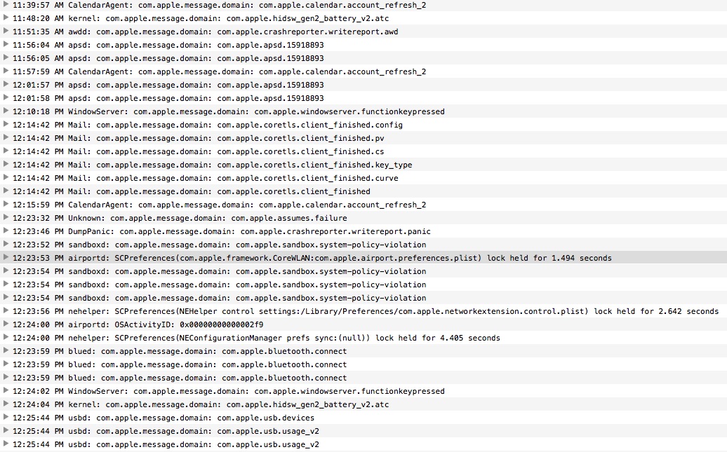

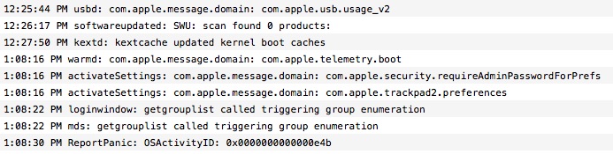

My faithful MacPro4,1 is getting a little spacey lately. It's crashed a few times. Nothing leaving any real messages as to what's going on.
Last month I blew out all the dust, and apparently some of the magic dust keeping it running spotless for years. I'm hoping this isn't a seriously bad thing.
But here is the latest crash. I just left it, and it crashed, came back and had to relogin. I can't afford to replace this workhorse, so hoping I can keep it among the living for a few more years. (Unless someone has a trashcan Mac Pro, really cheap)
Thanks for any assistance. I can't make anything out. I mean there are some things that look odd, but I don't look at mac logs all day to know if they really are odd.
Thanks...
Thanks...
These log entries seem related to the AirPort Extreme, Wi-Fi. It's not uncommon after all these years the AirPort transceiver to fail, I had to replace several cards.
If you connect via Ethernet, try to remove the card physically and check if your KPs stop.
