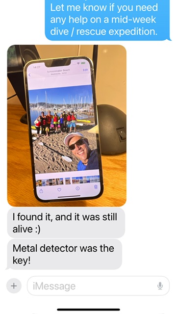

That's really unfortunate, as iPhones have been pretty waterproof in recent years. For an extreme example, a friend had his iPhone 13 Pro go overboard while we were kayaking on the bay. He free-dove repeatedly to the muddy bottom 12-14 feet down looking for it, to no avail.
(Shot with my 13 Mini 😀)
He went back the next day and spent 3 hours looking for it, again with no luck. He then went online and found a cheap underwater metal detector and went back a couple days later...
(Group selfie photo just before we took off)
The phone was submerged in deep salt water for 4 days and powered right up! However the speaker didn't work, so he took it in and they gave him a replacement phone on the spot, no questions asked.
