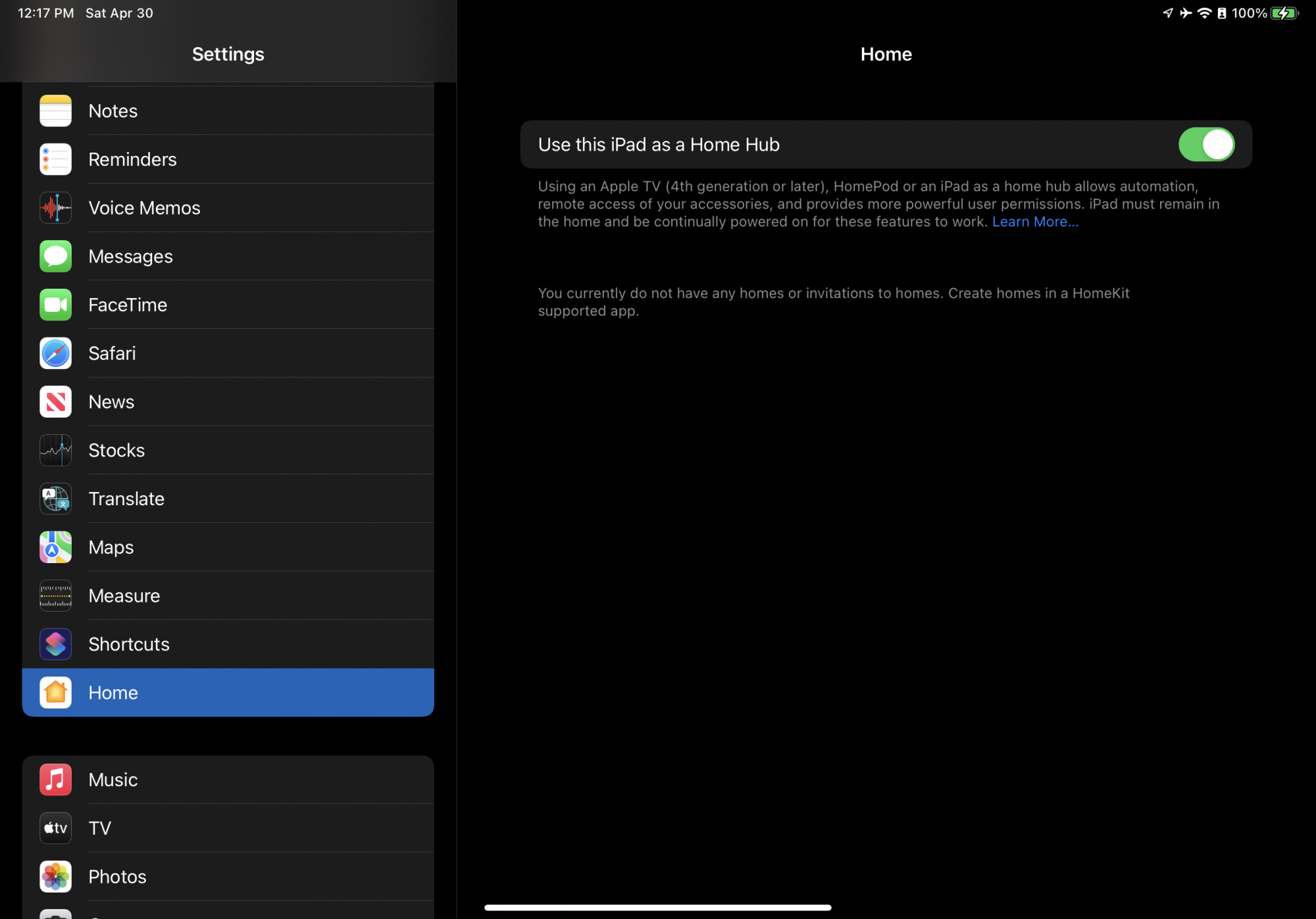

There is a way to disable the hub status on your iPad. Go to settings and then scroll down on the left until you see home and then there is a toggle switch to disable this setting
I’ve attached a screenshot of where you can find this setting on your iPad

Thanks, Justin. I was trying to toggle that switch, but it would just "pop back" to the on state. Only after several resets would it allow me to toggle it off and leave it there. Certainly a sw problem, but since no one else seems to be reporting it, corruption during a recent update seems most likely.
A lot of sliders broke with iOS 15. They don’t stick when you toggle them. The most frustrating one for me is the alarm on my kid’s HomePod Minis. I’ll toggle it on and it switches itself off. After doing this multiple times, it eventually sticks. I’ve seen this behavior in other places throughout the software UI as well.
