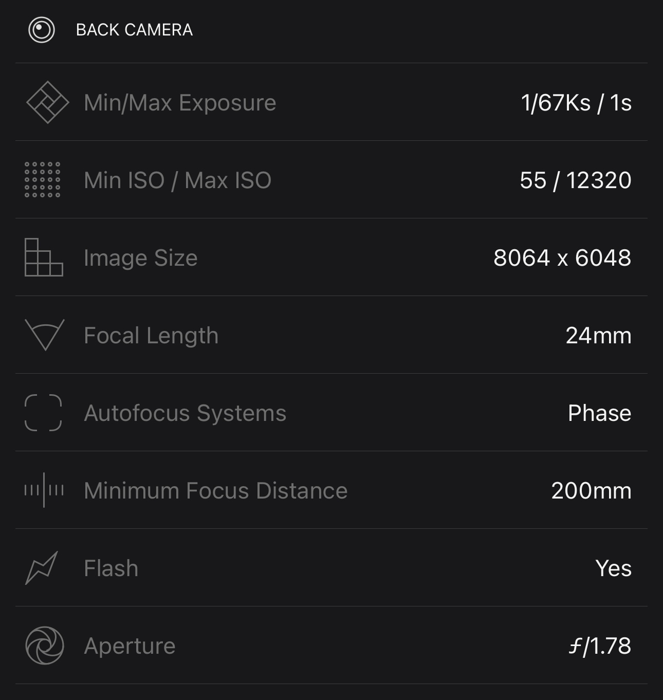

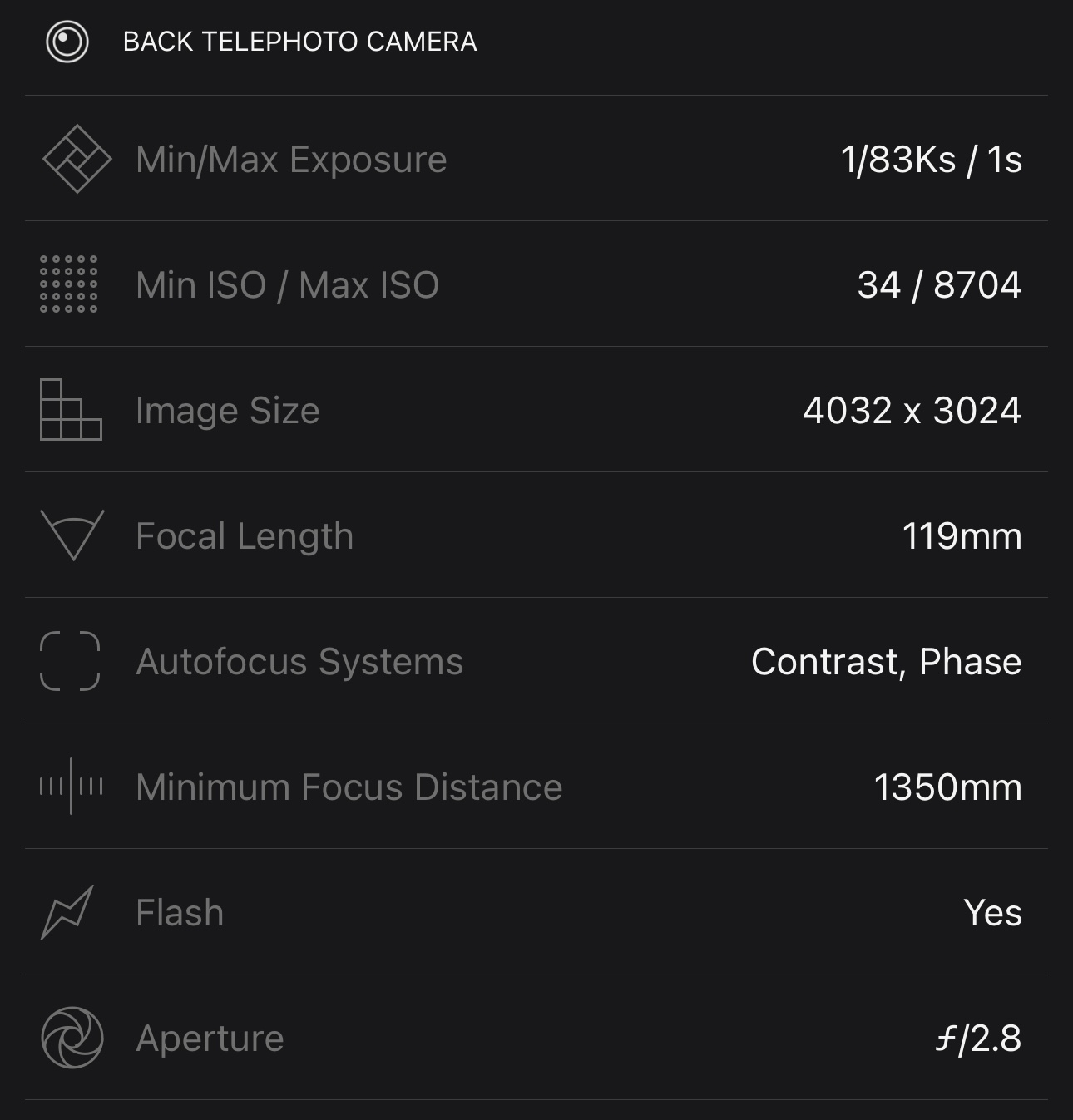

Each of the iPhone camera lenses has a minimum focus distance that you have to be mindful of. If you get too close beyond the minimum focus distance, the other cameras are going to take over and switch giving you the appearance of the other lens. The main 1X camera has a minimum focus distance of 200mm which is 7.7 inches. If you have macro mode turned on and if you get closer than 7.7 inches the ultra wide camera will take over and switch.
The 5X camera has a minimum focus distance of 53.15 inches or 4.43 feet. which means you can’t use the 5X Camera, any closer than 4.4 feet away from your subject. if you get closer than that, then the 1x Camera will copy the magnification of the 5X and zoom in and it will switch.
Third-party apps, like Halide, Moment, pro camera, etc. Will allow you to hard select the lenses to where they won’t switch. It’ll just have to get used to using a third-party app to take some of your photos which is a bad thing because you have way more control over your cameras with a different camera app.
You’re getting frustrated because you’re exceeding the minimum focus distance for those camera lenses. Take a look at the date below for the main 1X and 5X Camera.
If you don’t have the max iPhone, then the 3x camera has a minimum focus distance of 25 inches or 2.1 feet

This is understandable and at the same time terrible design. Why is a $1,200 phone camera ow that requires you to first measure the photograph image before which to take epic? A ~2002 Nokia point and shoot and every iPhone I had previous was fine.

All camera lenses are like that. They all have a minimum focus range. Nikon, Sony, Canon, iPhone, Samsung etc all have lenses that have to be used at a certain minimum distance. My Sony 85mm f/1.4 has a 3 foot minimum focus distance. It will not focus on anything closer. That’s just the way it is. The only lenses on a smartphone or DSLR that will focus close are macro lenses. Don’t blame the design, you have to educate yourself and know the cameras limitations. Once you learn that, you’ll not have any issues. You have to “think” like the camera.

That’s how my $2,200 Canon 5D Mark IV works. I have to manually change the lenses ($200-$1,200 each) if I want to shoot a subject that is closer than the minimum focal distance of the lens.
You don’t have to measure as much as use some common sense and your feet to get further from the subject when you want to use a specific lens.
