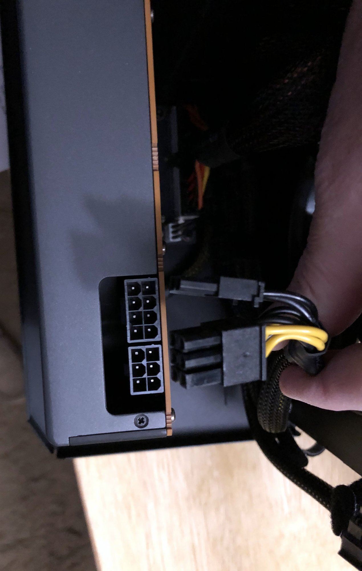

I took the Razer Core apart. There weren't very clear instructions on connecting the cables to the graphics card, with two connectors left hanging. So I flipped the connectors around and tried going direct with the DP cable into the monitor. Everything is working great now, much speedier than it was before. So maybe I had the cables backwards. Thanks for your suggestion; it made me re-look at how everything was hooked up.
Can you elaborate or post photos on what was hooked backwards? I’m looking to get the same setup soon and don’t want to make the same mistake and be disappointed in the performance
They're the power and data cables. The Razer Core X has two identical sets. One set will leave you with an extra power lead hanging off. There weren't clear instructions on which cables went where, so I had just guessed.
