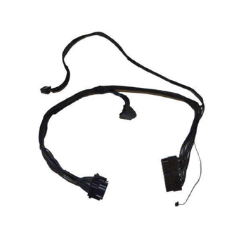

thanks you so much for the answer. I just looked it up and found this
the person providing the answers directs me to a eBay listing
The cable looks like the one I need but it's for the hard drive. At least now I know which cable it is
[automerge]1592674750[/automerge]
okay found it
now I just need to find some instructions on how to replace it
