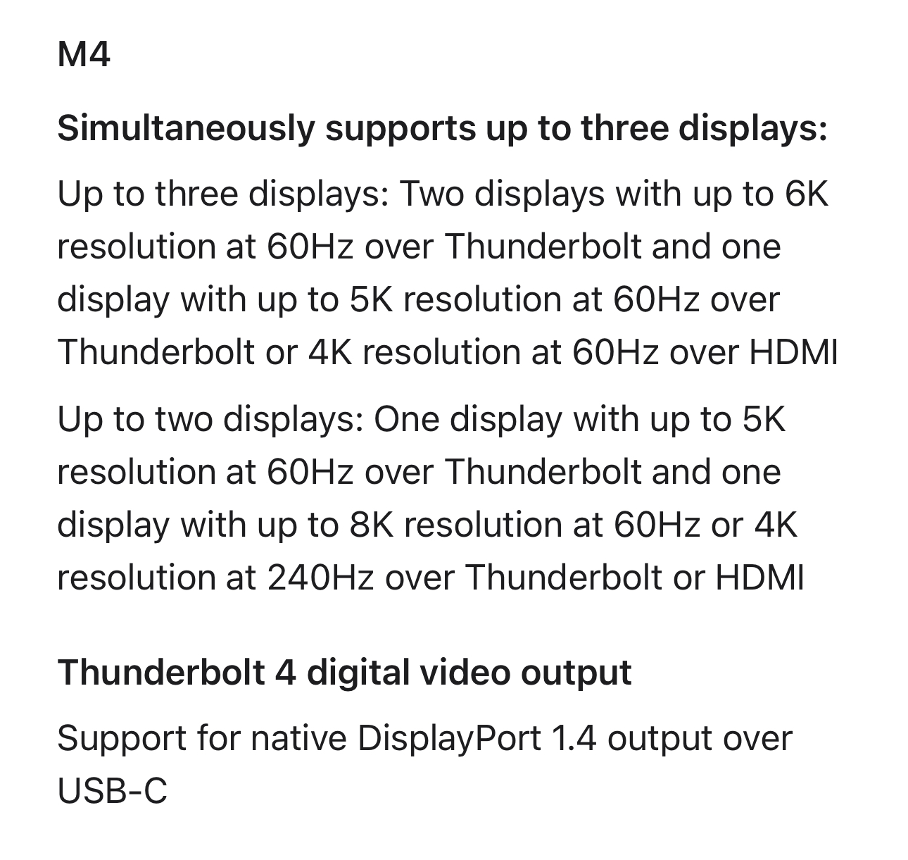

By looking at the wording on the Apple website, I’m kind of wondering if two of the displays have to be over thunderbolt. Someone with more technical knowledge of this could chime in, but the wording seems to point out one display over HDMI.
Reactions: streetfunk
The issue is most likely the how the monitors are connected. The last line in the above screenshot is the key here. DisplayPort alt mode is what runs the displays over the Thunderbolt connection. If your monitors support DisplayPort, you can run a DisplayPort to USB-C cable instead of HDMI to take advantage of the additional bandwidth of DisplayPort/Thunderbolt. Compared to DisplayPort, HDMI has noticeable limitations with respect to bandwidth. On the gaming PC side you will often see gaming monitors max out at 120-144Hz on HDMI even if they are capable of 165/180/240Hz over DisplayPort.

If you are using appropriate connections, you can connect three displays without needing a dock at all. One monitor would remain connected to the HDMI port on the Mac Mini, while the other two monitors would run a DisplayPort to USB-C cable, which you would connect directly to the thunderbolt ports on the back of the Mac. That would leave the third port on the back open for the TB4 dock. That would mean far less clutter in the workspace, and a cleaner look overall.

If you can't connect the other two monitors directly to the TB ports on the Mini you would have to go through a TB4 or TB5 dock capable of handling multiple monitors. You would need to ditch the USB-C hubs you mentioned in your original post and connect the displays directly to either the dock or the Mac Mini. With my current setup, I can connect one monitor directly via HDMI, one via the DisplayPort to USB-C cable, and one directly to the DisplayPort connector on my TB4 dock without any issues.

USB-C is a physical connection type rather than a protocol. Just because your hub has USB-C does not mean it supports the bandwidth needed to run your displays at the proper resolution and refresh rate. Keep in mind that Thunderbolt 4 supports 40GBps bandwidth per channel, and Thunderbolt 5 supports 80GBps per channel. In comparison, the Belkin Connect USB-C hub only supports USB 3.2 Gen 2 with a max bandwidth of 10GBps. The Anker 5-in-1 USB-C hub has even less bandwidth, only allocating 5GBps to the USB-C ports. The Sabrent 7-Port USB-C 48W Powered Hub has 7 USB-C ports, but only supports 5GBps per port as well. The Thunderbolt ports on the Mac Mini will support Display Port Alt Mode, which is why I was suggesting the DP to USB-C cable in the first place.
