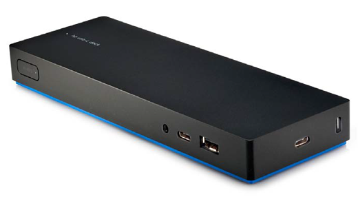

But, I would like to use my HP dock G3 to connect my dual screen from my desk.
HP Elite usb-c dock G3

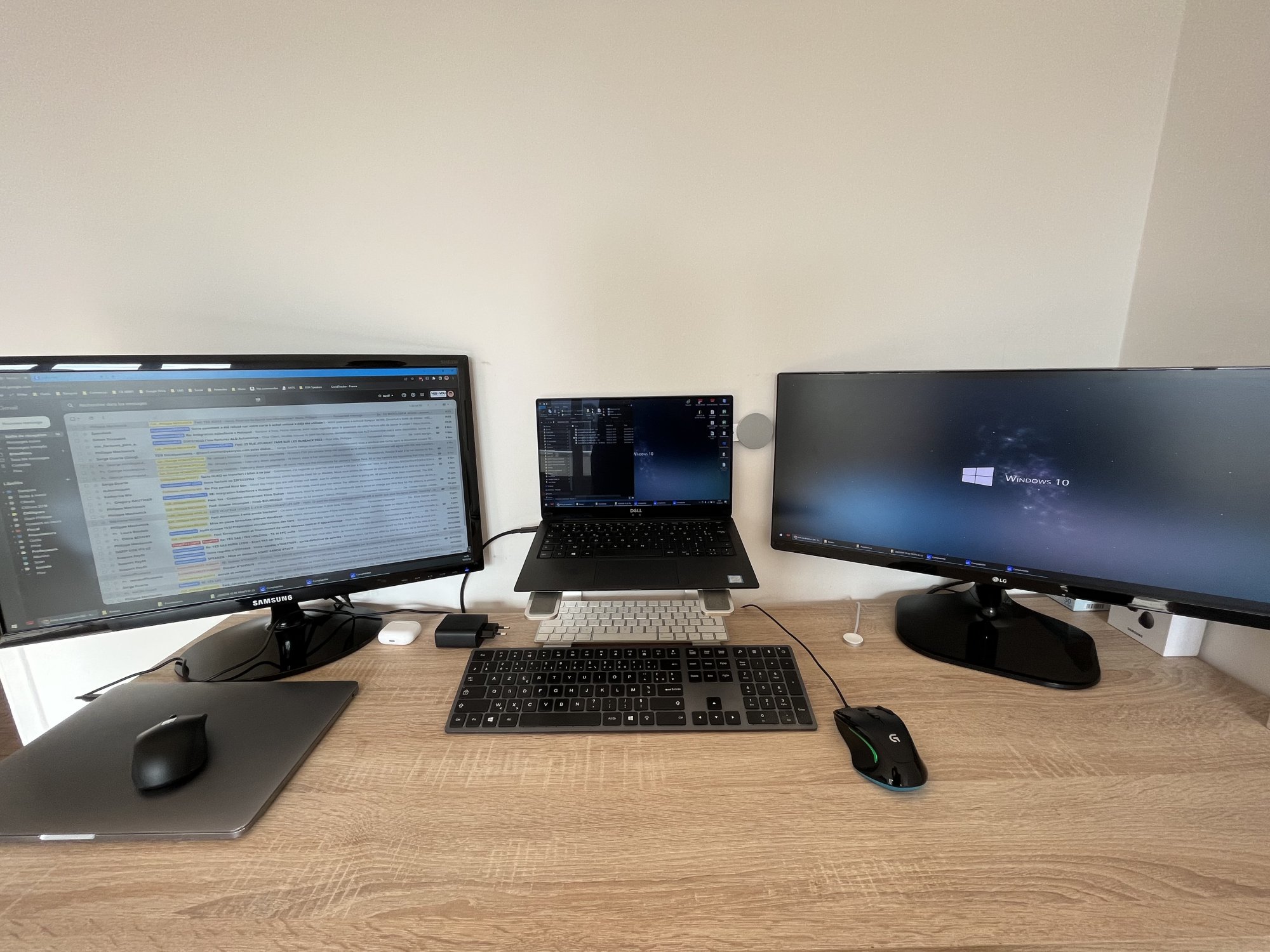

So when I plug the thunderbolt cable, there is only one screen working, that's odd. On my windows laptop I plug it and everything work seamless.
Could you help me please and explain me how do you do with your dual or even triple screen desk ?

What model of 2017 MBP? Might be 15" or 13" with 2 Thunderbolt or 13" with 4 Thunderbolt. Most likely the 13" with 2 Thunderbolt (from the CPU speed).
What resolution screens? The 13" models support two external screens up to 4096x2304.
I notice the spec for your doc only mentions Windows, not Mac. And it is a USB-C dock. You might do better with a Thunderbolt dock - but make sure it is supported for 2 screens on your MBP.

My point about the dock. USB-C is a physical port specification. It can be used for Thunderbolt, DisplayPort and various USB 3.x protocols. Your dock is connected to a Thunderbolt 3 capable (40 Gb/s) on your Mac, but the dock is only USB. The spec of the dock is not clear, but I assume not more than 10 Gb/s (maybe less).

My guess is, you’ll have to connect one display through the dock (which will also provide power to the Mac). The other display will have to connect directly. Some docks use “MST” (Multi-Stream Transport) to support multiple displays; which isn’t compatible with Macs.
