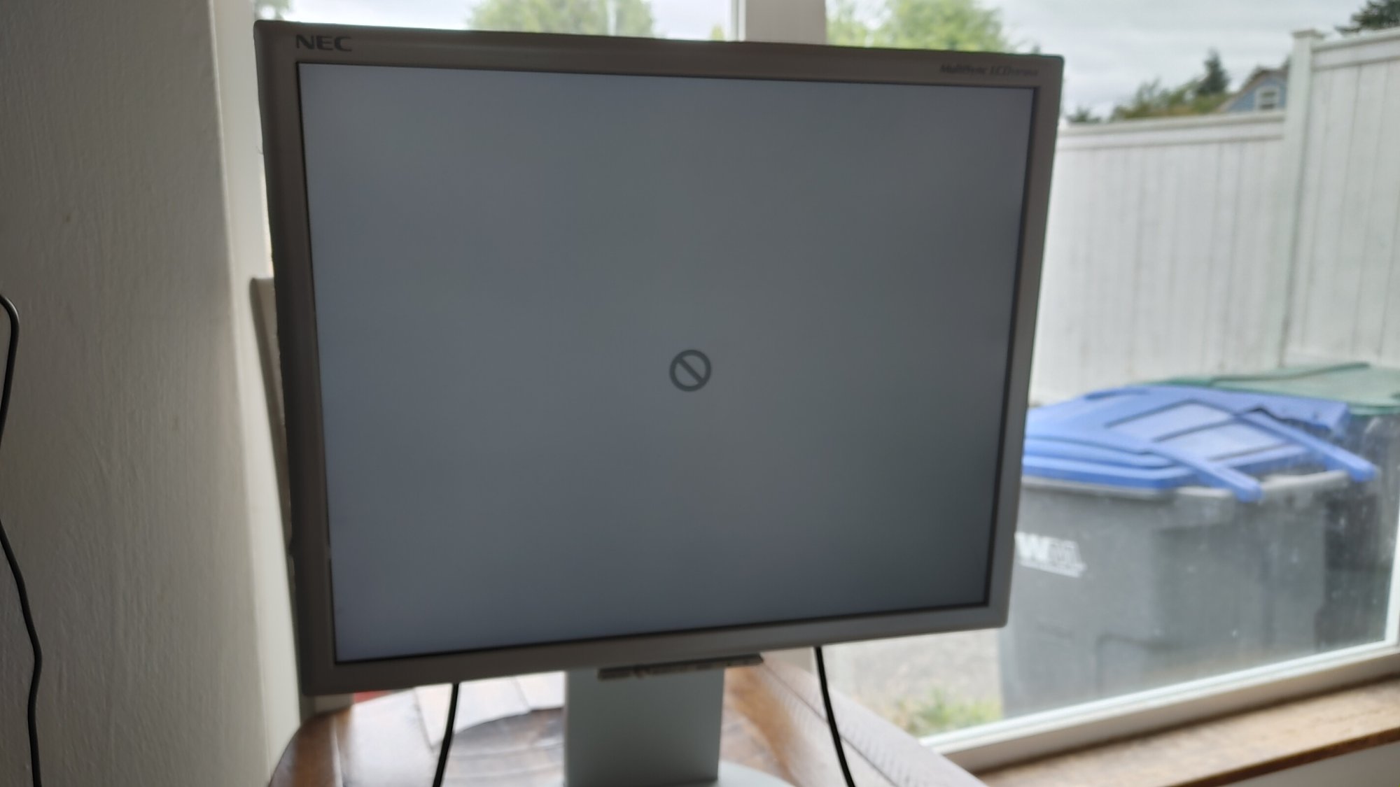

For funzies, I also tried using the Sonnet PCI X Installer to install 10.2. The installer found all the necessary files, but I was met with this on reboot.

Are you using onboard graphics or a PCI GPU? Check the correct video output is selected in XPostFacto

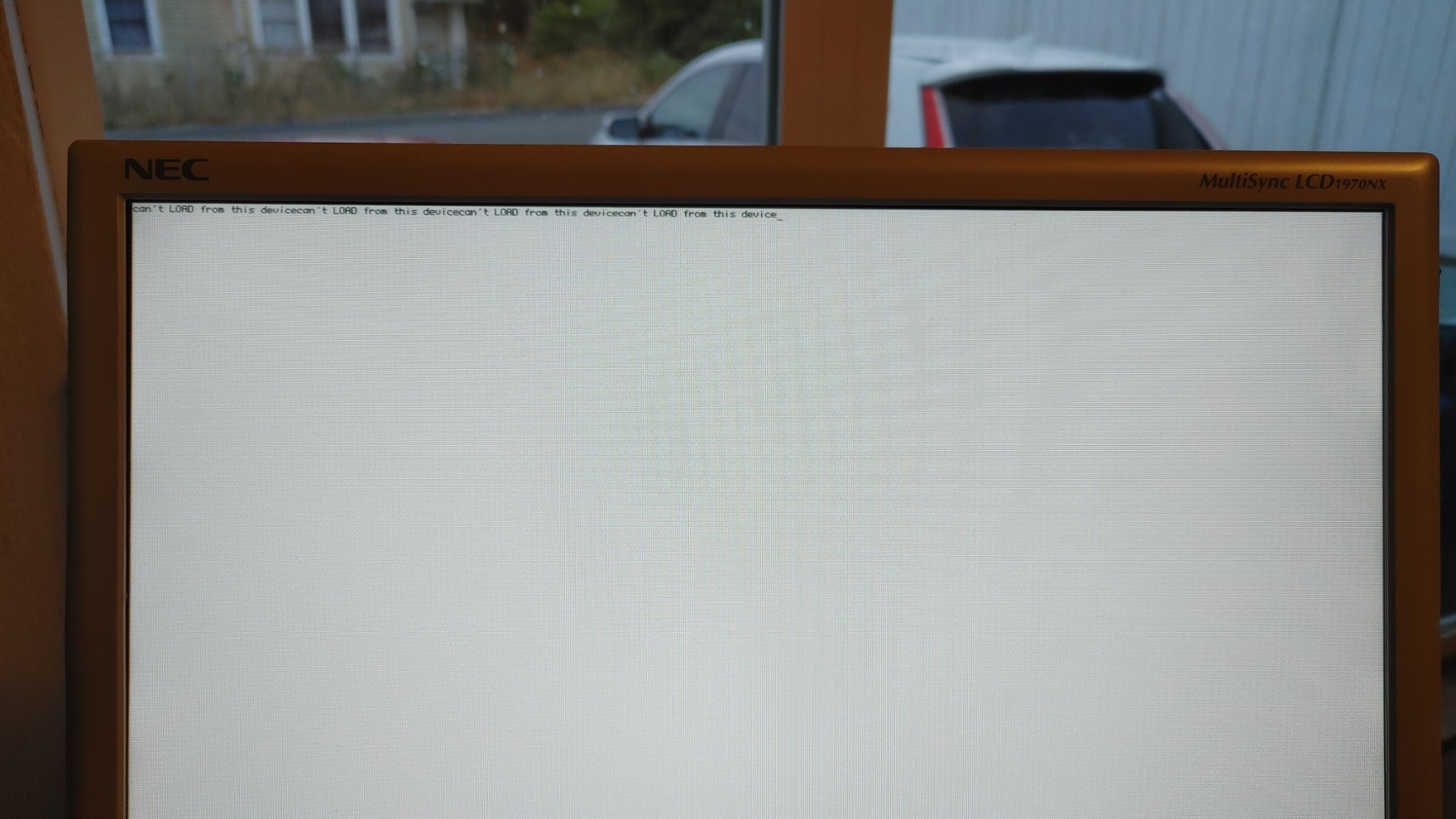

I am using a PCI GPU. Ok, so i had some of the OpenFirmware settings set incorrectly. Now i'm getting verbose output. It seems to be printing "can't LOAD from this device" over and over again.
Ok, I did some googling around and found this article:
It sounded similar to my symptoms, so I had to slow down the CPU in the XPostFacto settings. After that, things started booting!
