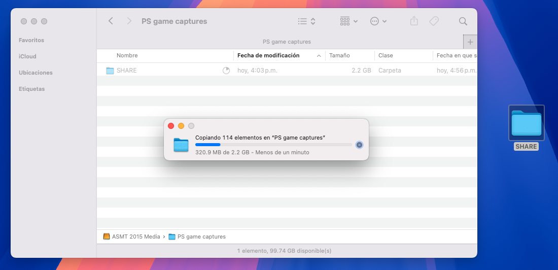

It's been happening since I purchased it, but because I seldom use USB sticks, I haven't paid it too much mind... But today I absolutely needed to use a USB stick and it was a pain; I had to use another Mac just to retrieve and save files there because I was pressed for time. I decided I have to fix this ASAP.

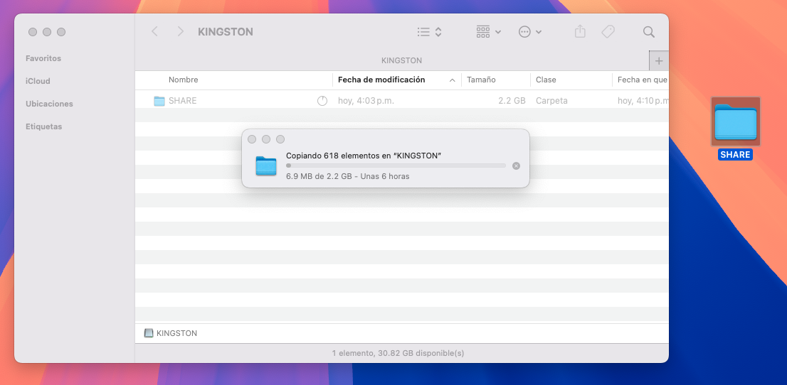

This is how it looks like: saving 2.2 GB to the USB stick is estimated to take about 6 hours.

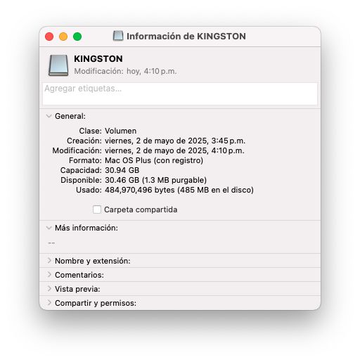

The USB stick is nothing extraordinary, a Kingston USB 3 stick with 32 GB capacity. I have 4 of them and they all behave the same way.
I also have a 8 GB PNY USB 2.0 stick and the experience is the same as the Kingston sticks, so I don't think the USB technology is the problem here.
I've tried several formats (FAT32, ExFAT, HFS+) and there's no difference, so I don't think the disk format is the problem either.

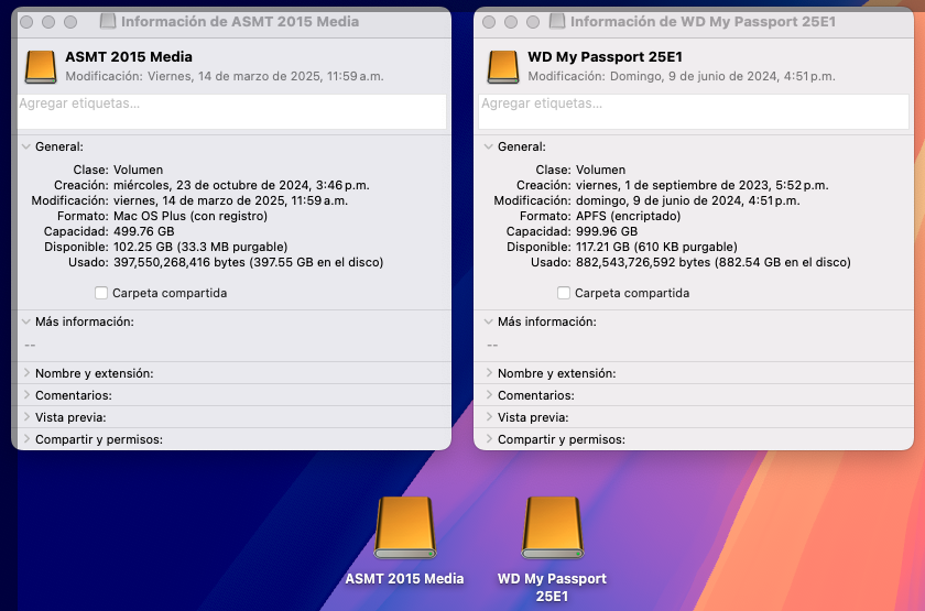

I find strange that I have a couple of USB hard drives that have no such problem. They have USB-A connectors just like the Kingston and PNY sticks, so I don't think the USB-A ports are faulty.
Less than a minute to copy the exact same folder that would take 6 hours on the Kingston flash stick.
The USB sticks are not faulty. I connected them all to another Mac and to a Windows laptop and they work perfectly. They only have problems when I connect them to my Mac Mini.
I have no idea how one USB mass storage device can work (hard drive) and the other (flash) cannot.
Now, I have been using Macs for close to two decades, and each new one has received all the data from the previous one via Migration Assistant. I've had trouble before with migrated legacy printers that prevented the system from sleeping... and since I've used interoperability software like Parallels Desktop and Paragon's NTFS-For-Mac, I figure that a poor uninstallation process could be messing with my USB ports?
I don't know how I could start troubleshooting this issue, and I need help. Thanks in advance.

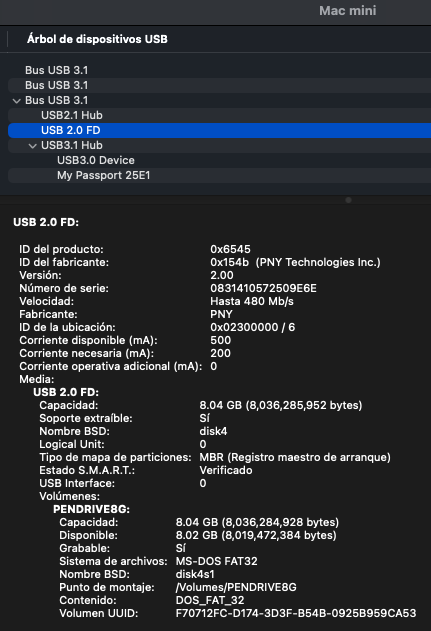

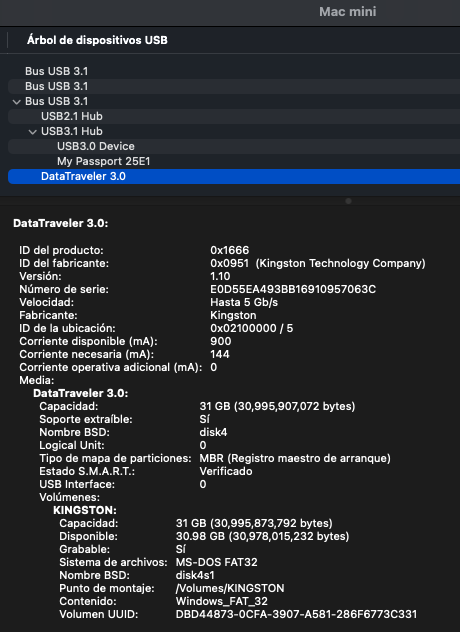

Have you checked in System Information to confirm if these flash drives are actually connected at USB 3.0 speeds? I've also had many flash drives that slow way down because they got very hot while copying.
Yes. The USB 3.0 stick gets 3.0 speeds, and the USB 2.0 stick gets 2.0 speeds. Both are connected directly to the Mac Mini back ports without any hubs.
I don't think the temperature is the root cause in this case, as they were connected only that moment and it would be unlikely that they would get unbearably hot in just a handful of minutes. I would also be able to tell when handling them.
