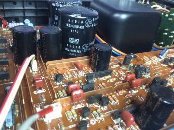

I'm trying to find this specialty audio grade capacitor for my venerable Yamaha Pre-Amp (C-80 as I recall). When in use for an hour or so audio in the right channel will get static or cut out. I've gone over everything on the board. I can't find any cracked solder joints. The pots all seem fine. All I could find were these two slightly bulged capacitors. So I think they are the problem.
The problem is I can find ones which match their voltage and uf ratings. But they are all two pin and appear to be rather small. While the capacitors I need are four pin and rather large.

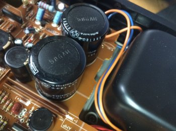

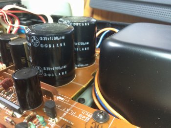

One side reads Nippon Chemi-Con. Audio Neg. Black 85 (degree symbol) C. It appears the part number on top is 58GAH. They are rated (B) 35v4700uf(M), (A)(C) Blank, (-).
Check out mouser.com, that's where I score my caps, they carry a _huge_ assortment, possibly some high grade like you're wanting.
Also try digikey.com for caps.
Here's the manufacturer of the existing caps:
http://www.chemi-con.co.jp/e/
Search their site to find their US distributors.
Crackling in the output can also be caused by a failing transistor. Basically, it malfunctions when it gets warm.
It might be a power transistor in the output stage, or one of the small-signal transistors earlier in the amp channel. There might be no visible indication that the transistor is bad. Some freeze-spray may help find it, or it may not.
Without a schematic and some way to look at signals in the channel (e.g. oscilloscope), you'd probably have to take it to a repair shop.
