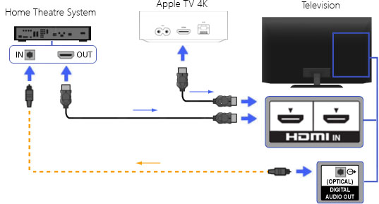

Tried reinstalling tvOS four times.
The issue persists.
Audio set to Dolby Digital 5.1 on the Apple TV.
No surround sound in the Computer Home Sharing app using tvOS 14.4.

No problems with 14.4 on my 4k box. The ATV output is connected to my receiver and the receiver to tv.

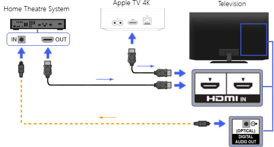

The issue persists.

What TV do you have? Are you sure that it converts 5.1 from the HDMI to 5.1 on the optical out? Do you get 5.1 from the TV on its own apps etc? I assume that your TV is also 4K? Do you get 5.1 from the other Apple TV apps? Is this only on the Computer Sharing app?
Jason
I have a Sony 4K television.
I'm not certain what the television does with the audio out signal.
The only thing I'm absolutely certain of is that surround sound works using the Computer Home Sharing app with tvOS 13.4.8 and not with tvOS 14.3 or tvOS 14.4.
On my entertainment system the Apple TV must be set to Dolby Digital 5.1 to have surround sound.
According to my receiver's display, aside from an app titled Surround Sound Check, surround works in everything except the Computer Home Sharing app.
