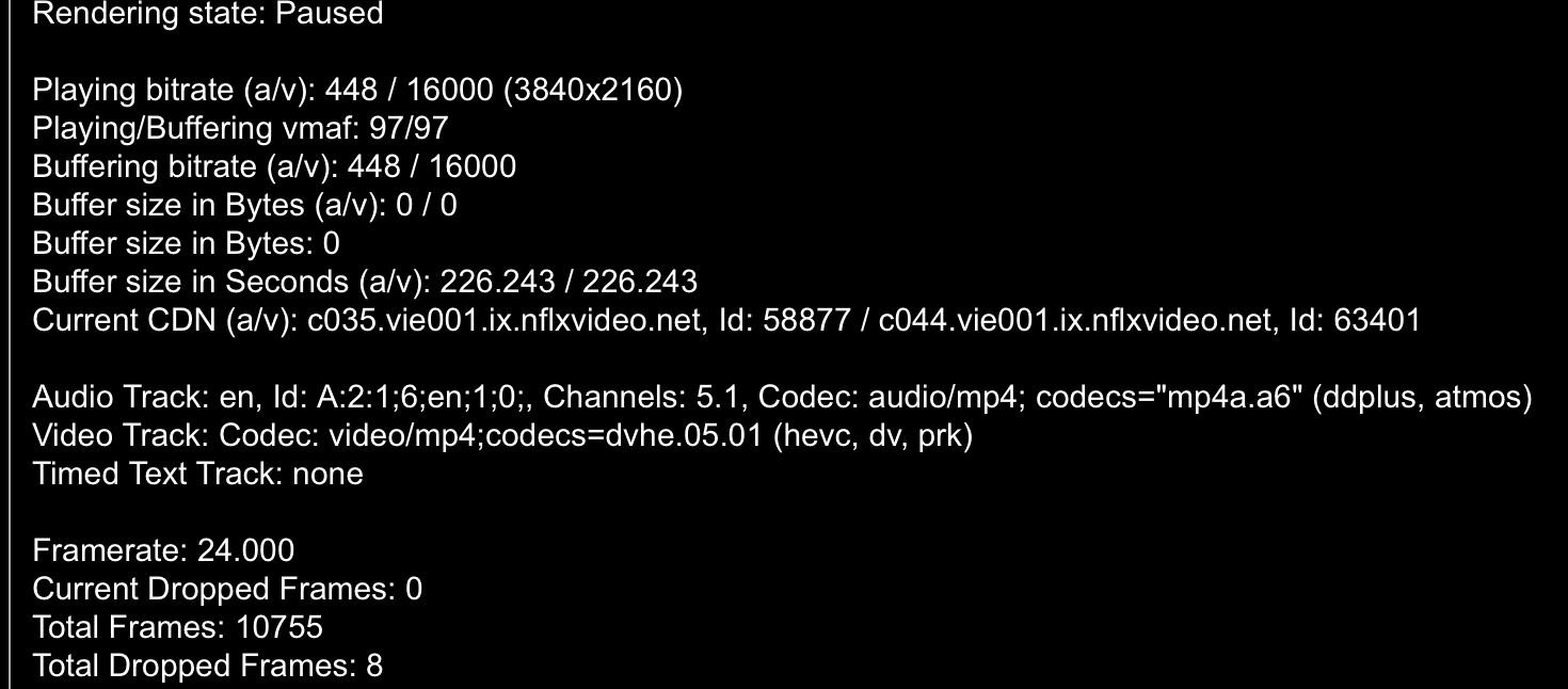

This extension does provide 5.1 too, so I was intrigued. I managed to get DDPLUS 5.1 out of Netflix, which correctly shows up as Multichannel audio with Spatial Audio. Atmos is also possible, but I got stuck. It shows up as Atmos on Netflix, but still just Multichannel in sound settings.

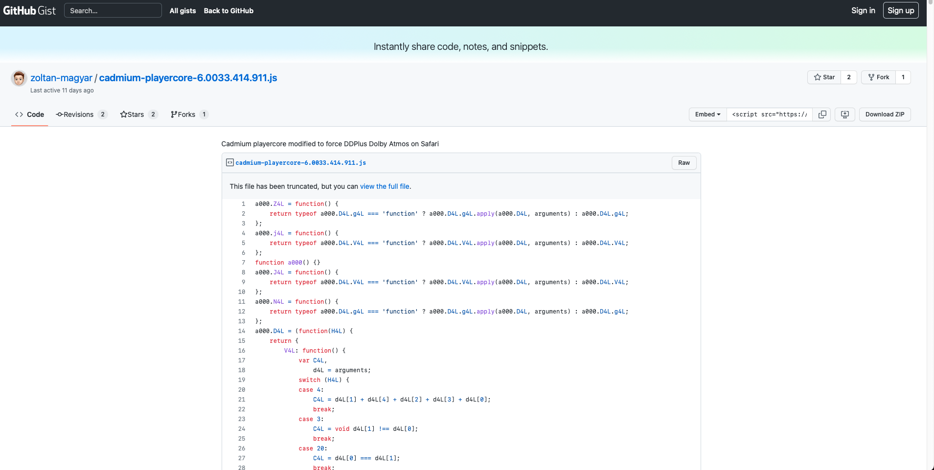

I created a gist of the modified Cadmium Playercore. It is a mess, mostly I just wrote over the existing heaac-2-dash because the minified .js file is extremely hard to read and Safari kept going back to 2.0 without basically overwriting everything. Atmos also needs a bit of a push.
If somehow Atmos could get through Spatial Audio, I would be willing to make this nice and potentially an extension. 5.1 is already quite nice with Spatial Audio though, but I really hope this could be pushed all the way.
Github Gist

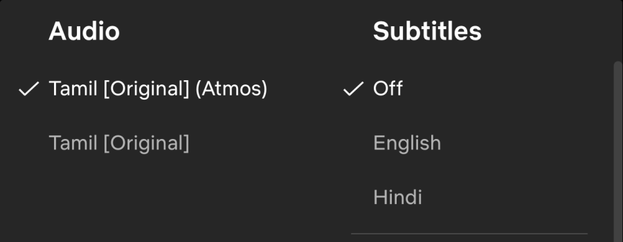

I manage to get Atmos by overriding with this gist. However, in those shows/movies with only 5.1 audio, I can only get stereo. Is any update going to fix this? Thanks a lot.

recently i got it working with the help of katzecz. And i was able to get high bitrate for audio in atmos, but in 5.1 it is still low, can you somehow manage to push t to highest bitrate in audio as well, to enable high bitrate audio all I did was add hq behind 5.1 or atmos, thats what katzecz found.

Enable developer options of safari,
Open Netflix play anything click develop option in top bar then show page source
In left there is scripts folder or something tap it then you will find cadmium player click it, tap copy kind of icon then select create response override then the tap import and select the file. Then refresh the page you are good to go. It will stay 5.1 until you reload the page. Click import and load file again if doesn’t work in first try and refresh the page

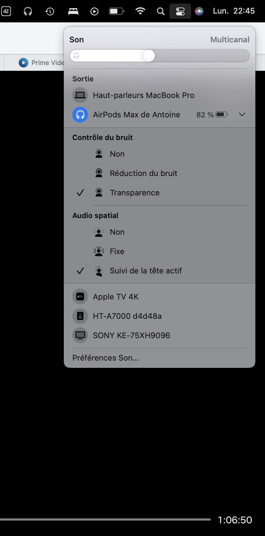

Hi, this latest gist works for me : I can select the Atmos track for neftlix shows as shown in the screenshot above. However when looking at the sound output to my AirPods Max it says Multicanal (multichannel) not Dolby Atmos. Am I missing something ?
Many thanks for your work !

Open netflix. play any content in it pause it. then go to develop option in menu bar, show page source, in left menu go to scripts, cadmium player in right text box thing in top of it tap that copy button type thing, create response local override, in left menu you will see local overrides, tap it, in right text thing there is import button and import the file and hit refresh on netlfix page. it will give netflix until you manually refresh page or reopen netflix.

Interesting stuff! I applied the last gist and the player interface now reports '(Atmos)', but actually only decodes to 5.1 instead of 7.1.4 as configured in Audio Midi Setup.. If anyone know how to fix it, I'd appreciate any advice.
