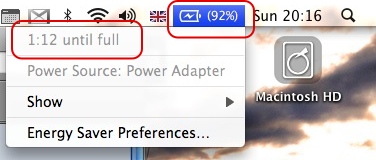

I wonder what the OP and others have done to their slow charing problems??
