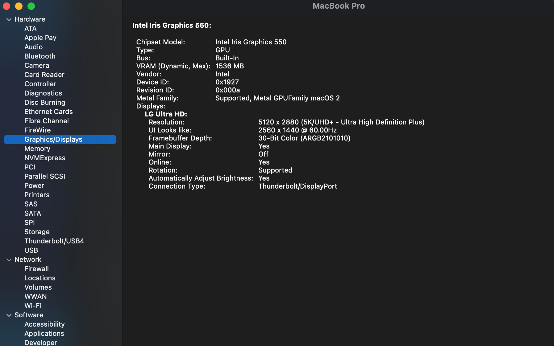

I have a similar use case as you - a 27" LG 4K monitor, that I run in closed clamshell mode with my 13" 2016 MBP. I run it at "Looks like 2560 x 1440" at 60hz, which leads to a great size of text / UI icons in a 27" monitor.
Note, one of the reasons the performance is likely worse than when you ran it on your windows Lenovo is that macOS does HiDPI scaling, where it doesn't just display 2560 x 1440 when using a 27" 4K monitor. It actually pixel-doubles it to 5120 x 2880 (ie. 5K resolution), and then downscales that to fit your 3840 x 2160 4K monitor. This is why (in my opinion, and many others with a similar use case), it looks better than a Windows laptop running it at regular 2560 x 1440.
This non-integer scaling is what makes you take a hit in performance. I personally don't really see that much of a performance lag on my 2016 13" MBP with integrated Intel graphics, but my use case is simple stuff (spreadsheets, safari browsing, etc.) , and nothing that requires heavy graphics processing.
You can see this if you go into System Report (About this Mac > System Report), and go to Graphics/Display, you'll see under Resolution, it actually shows 5120 x 2880 (see below), with the "UI Looks like" as 2560 x 1440.

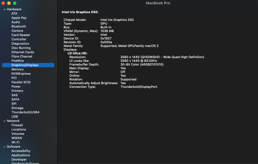

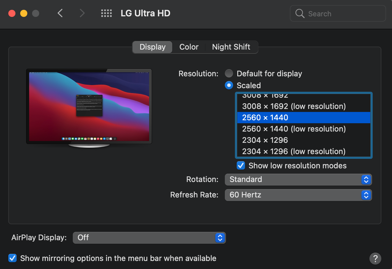

If you want to turn off the HiDPI scaling and run it at a normal 2560 x 1440, go into your Display Settings. Hold the "ALT/OPTION" key, and click on Scaled. It'll open up additional resolutions. Click on the "Show low resolution modes" check box, and you should see both a "2560 x 1440" and a "2560 x 1440 (low resolution)".
Click the Low Resolution option, and it should no longer do the HiDPI scaling. It'll look worse (but probably similar to how it looked with the Lenovo), but shouldn't have that performance hit any more. Give it a try and see what you prefer. If you don't think it looks that worse and you feel graphics improvement is worth the trad-eoff, you can always run it without HiDPI scaling. If you turn it off, you can confirm it in the System Report, as it'll look like this.
When you tur
