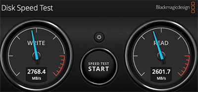

You make a very good point. The 2018 Mini internal SSD is actually closer to THREE TIMES as fast as the T7. :)
Here's my internal 2tb SSD
Now, this is somewhat dependent on the size of your SSD. I have seen posts by others with the 512gb SSD, and the read speed is about the same but the write speed is closer to 2000MB/sec. Regardless, it's a really fast internal disk and it makes a lot of sense to use it as your system drive.

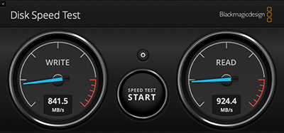

I’ve been running the new Mini from the T7 for a few days now. It has been solid and I’ve had no glitches. I understand the speed compromises using the external SSD for everything. I ran the BlackMagic speed tests and my T7 numbers, as you’d expect, are very similar to Boyd01’s posted results.
The Mini feels quite responsive compared to my old iMac and I’m happy with the performance. The simplicity of having everything on one device (T7) and not having to manage “remote” libraries and data files is worth the speed penalty for me. So at this point the internal SSD isn’t being used for anything but it does have a configured but empty Catalina install on it.
