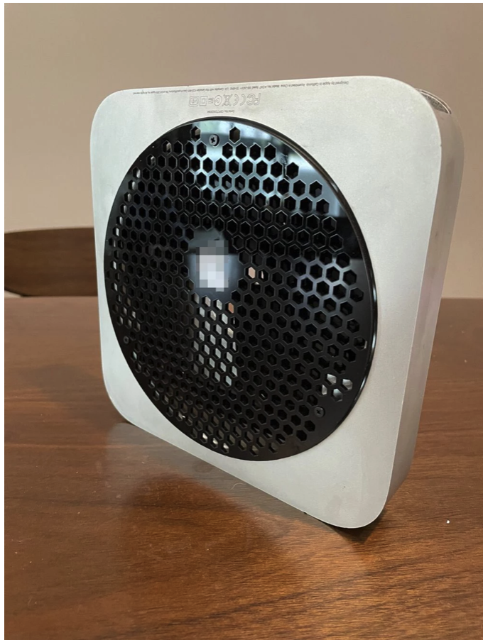

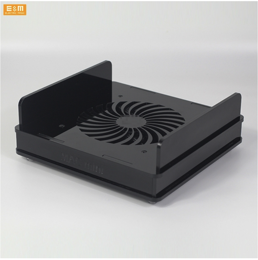

I also have some cooling options on order for the mini, one is a bottom cover like this, the other is a stand with cooling fan built into it. Keep that mini cool :)

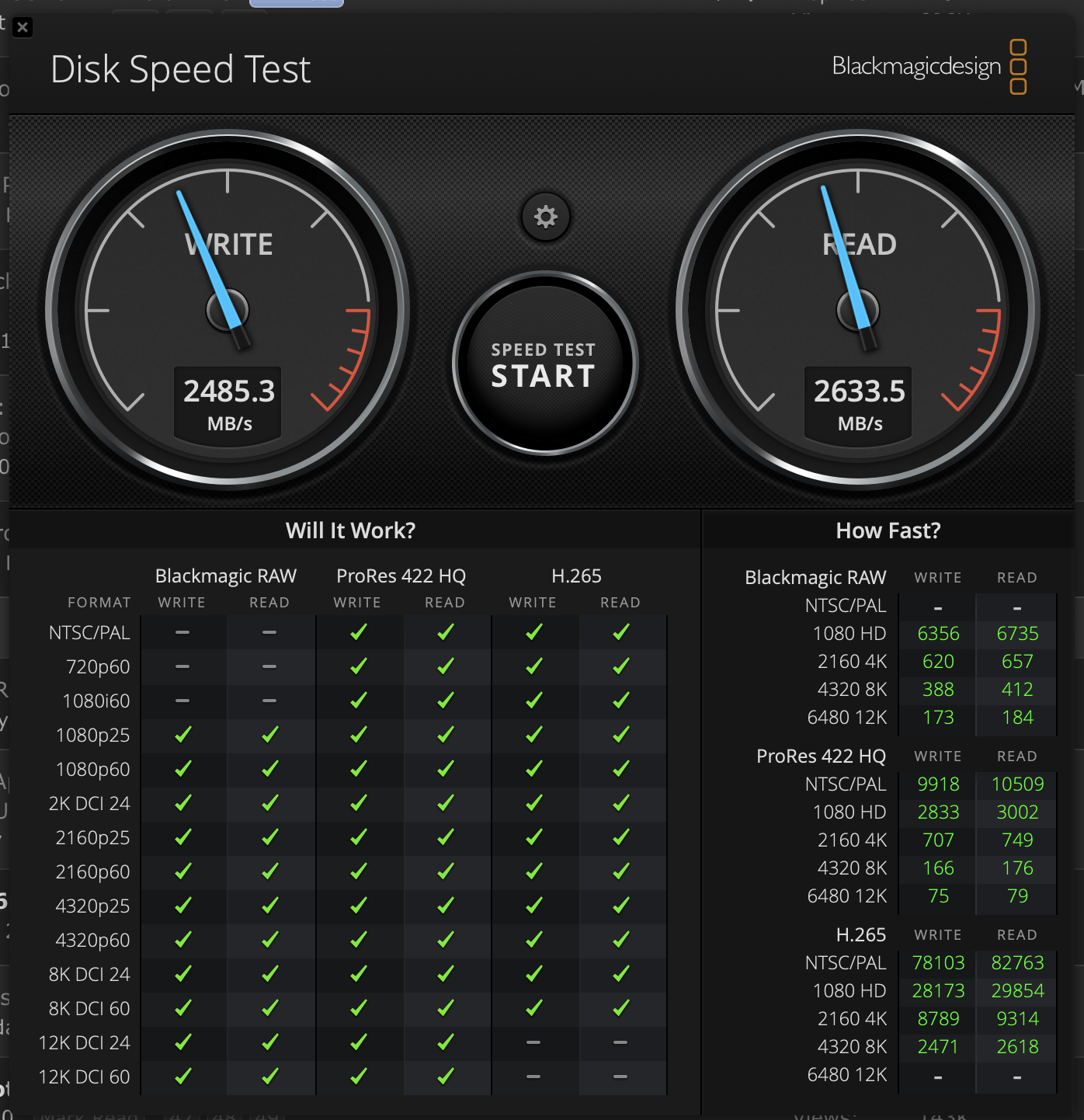

Looks great! What enclosure are you using?
Could you post results with AmorhphousDiskMark app?
These are the enclosures I am using https://www.amazon.co.uk/gp/product/B08X9YTWJC/ref=ppx_yo_dt_b_asin_title_o05_s00?ie=UTF8&psc=1
Great performance.

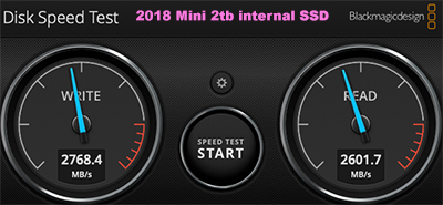

Can you post also the speed of the internal SSD?
Next time I boot to the internal drive I will grab a screen shot for you. but write was just over 2000 and read 2250 so the 980 pro M2's are faster plus you don't deteriorate your internal drive.

Those speeds are really good! But USB 3 externals are fast enough for my needs and much cheaper. My internal boot drive is just a bit faster than your external.
yes very impressive speed there, but 2t drives are faster as internal drives, but very expensive of course. mine internal is only 512G so not as fast as yours. I use a 2TB drive for data storage over USB also. which I agree is fast enough for storage purposes.

Here are the links for the cooling stand and base cover for the Mac mini.

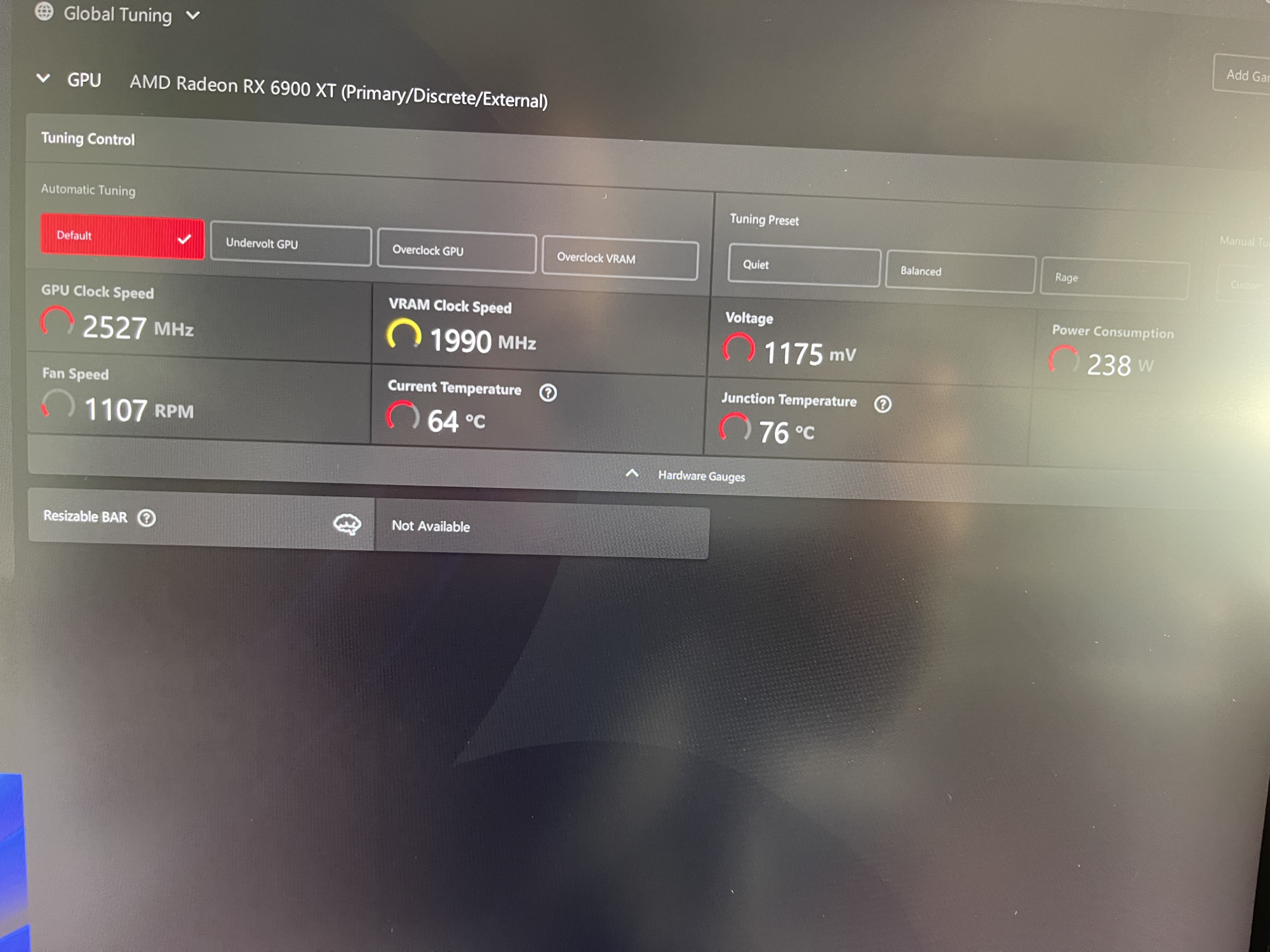

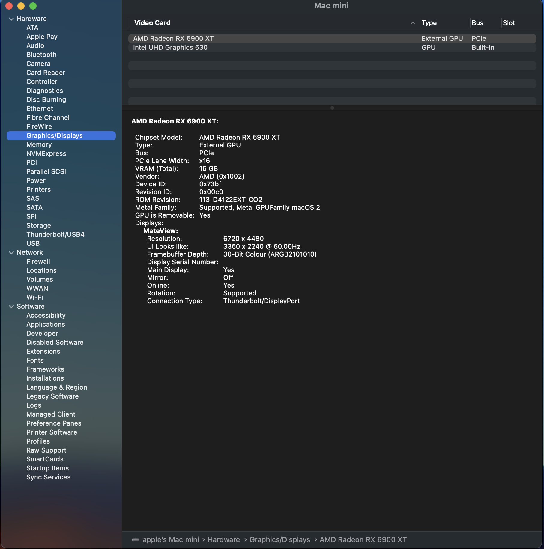

Today I will be fitting a Sapphire Nitro plus SE OC 6900XT in my Egpu so will add some pics later. but so far in Monterey I have had no issues at all with my Egpu setup and hopefully the 6900xt will be behaving just the same. I have also upgraded the PSU in my Razor chroma as the standard 700w PSU is noisy, I went for the Corsair SF750 which offers 62.5amps on the 12v rail and fits nicely into the chroma and is silent.
Reactions: AlumaMac

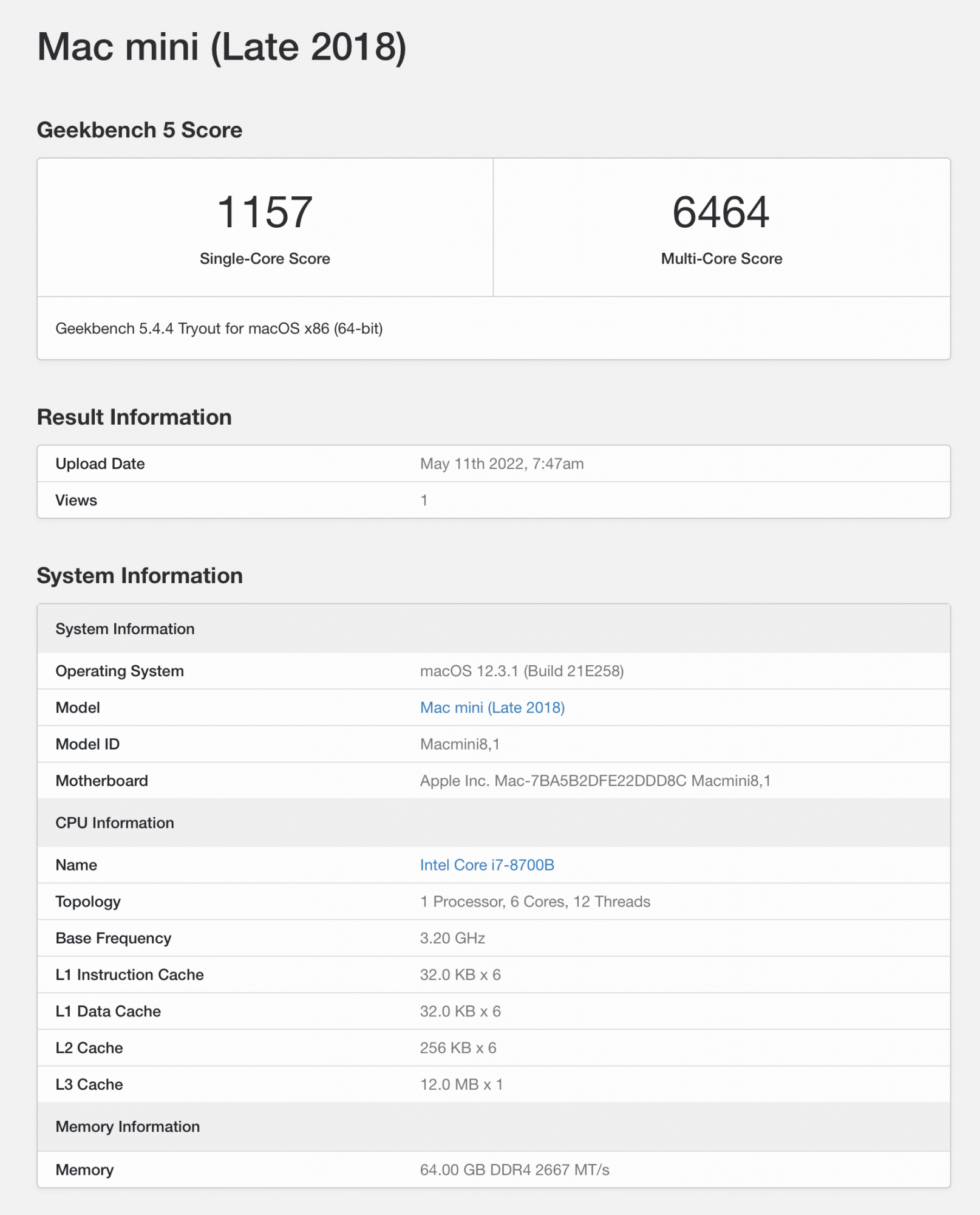

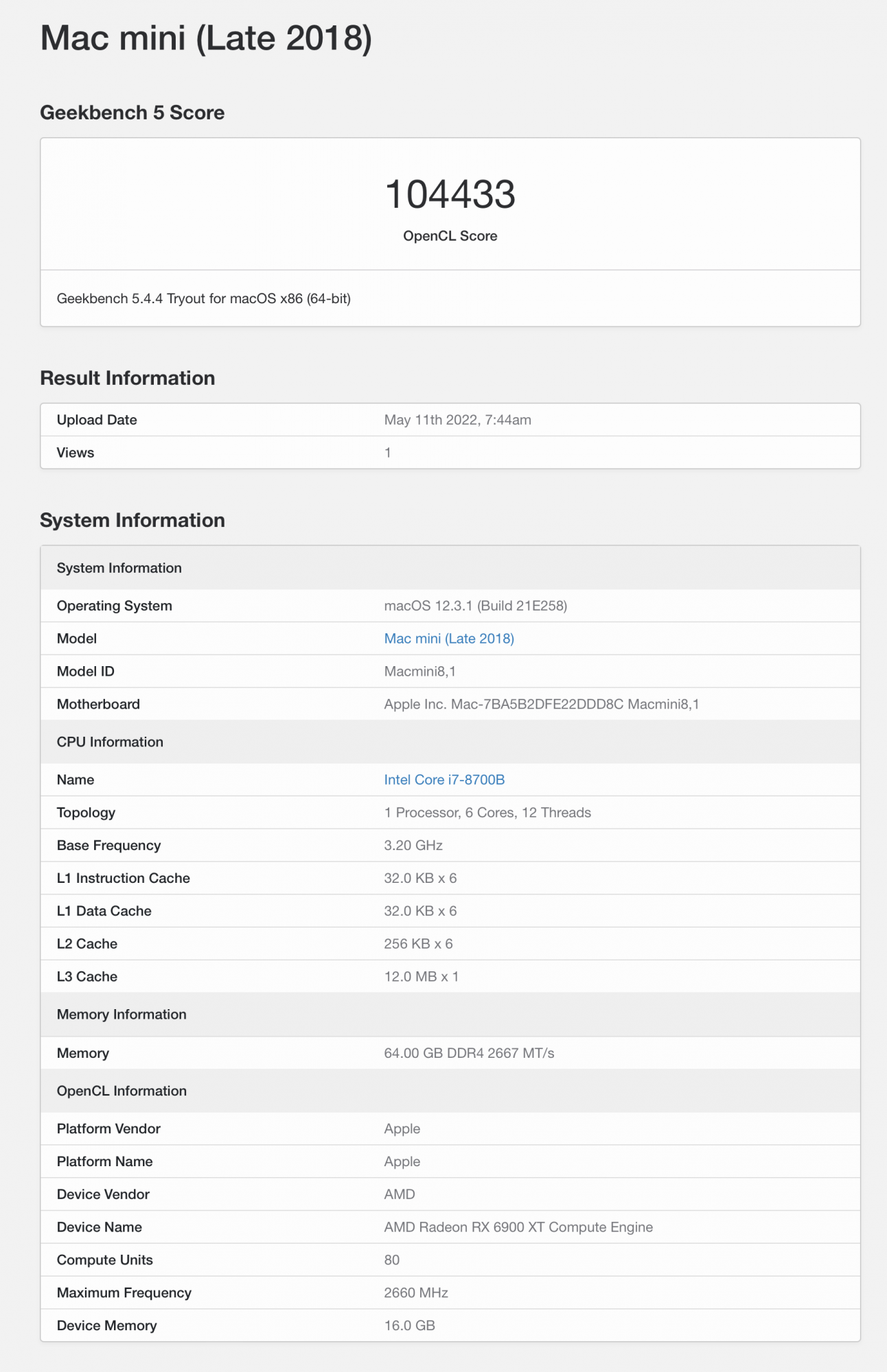

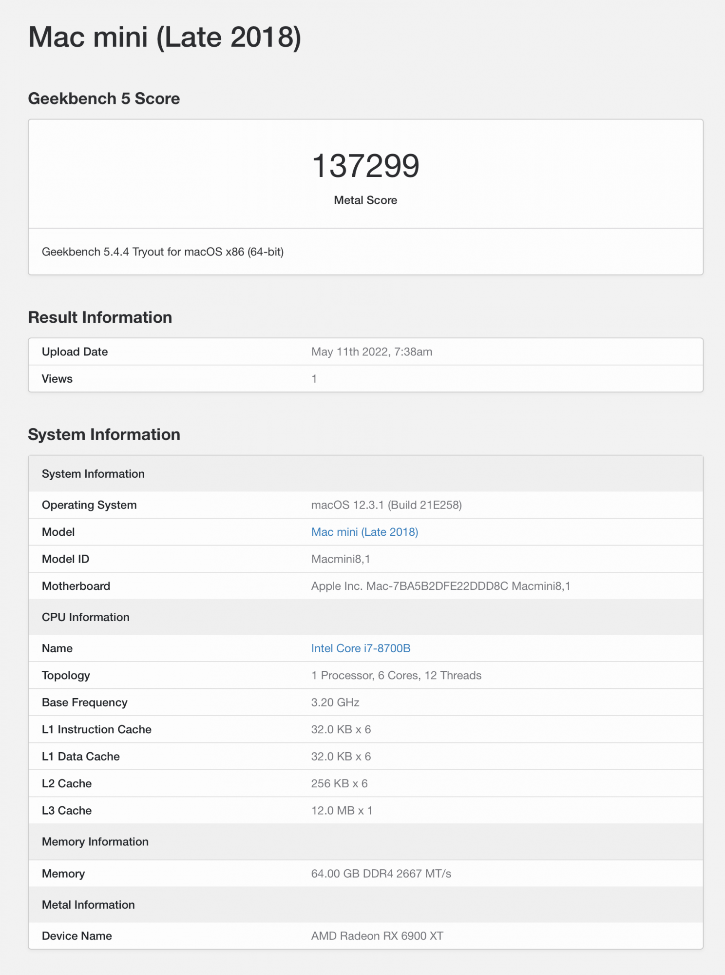

Well today the 6900XT went into the Egpu and all good so far. only thing I would say is Mac fan control does not see the temps of the card unlike the RX 590 but it seems to be very good, only thing I might do is disconnect all the RGB on it, I don't need it looking like an Xmas tree :)

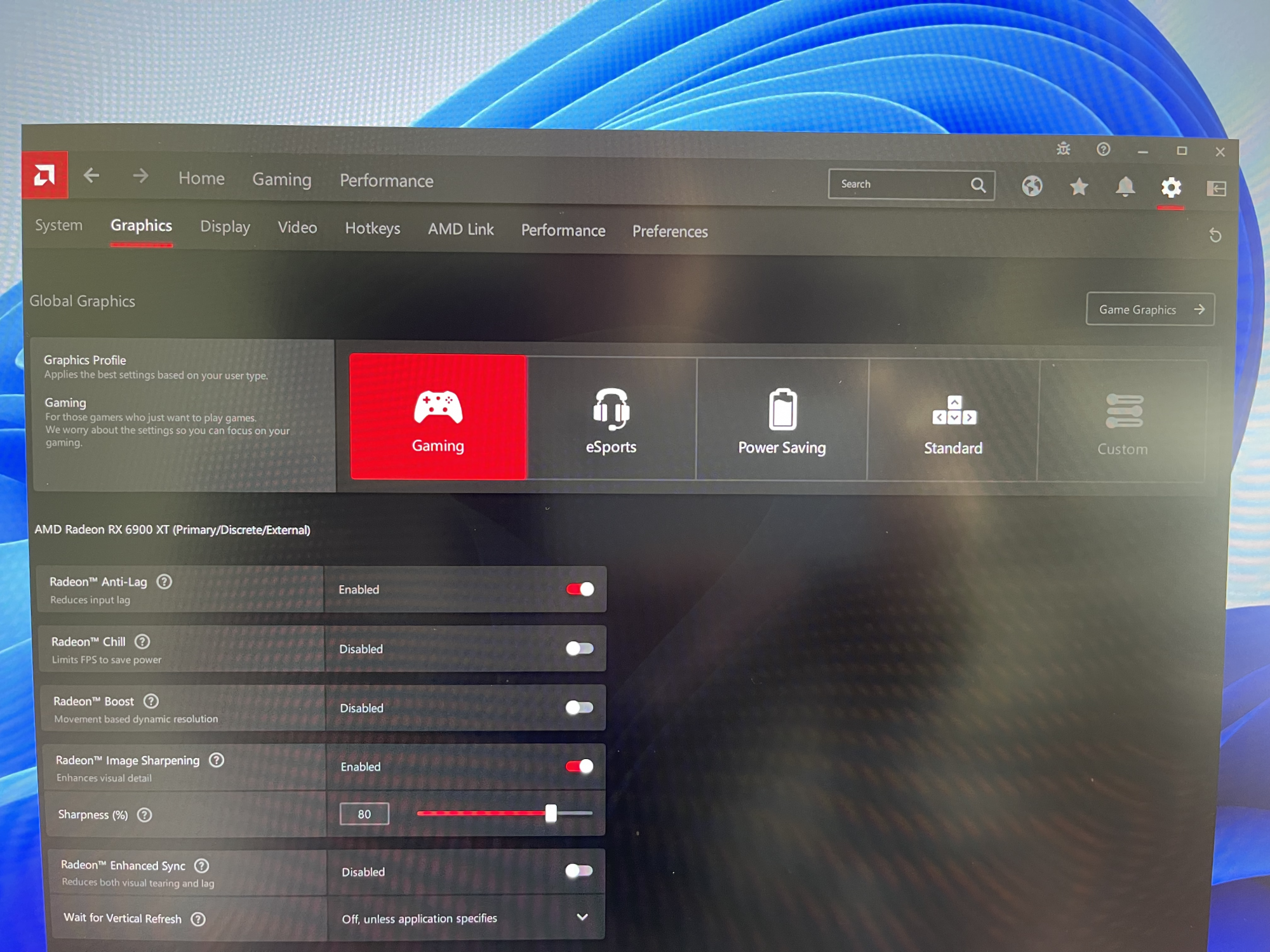

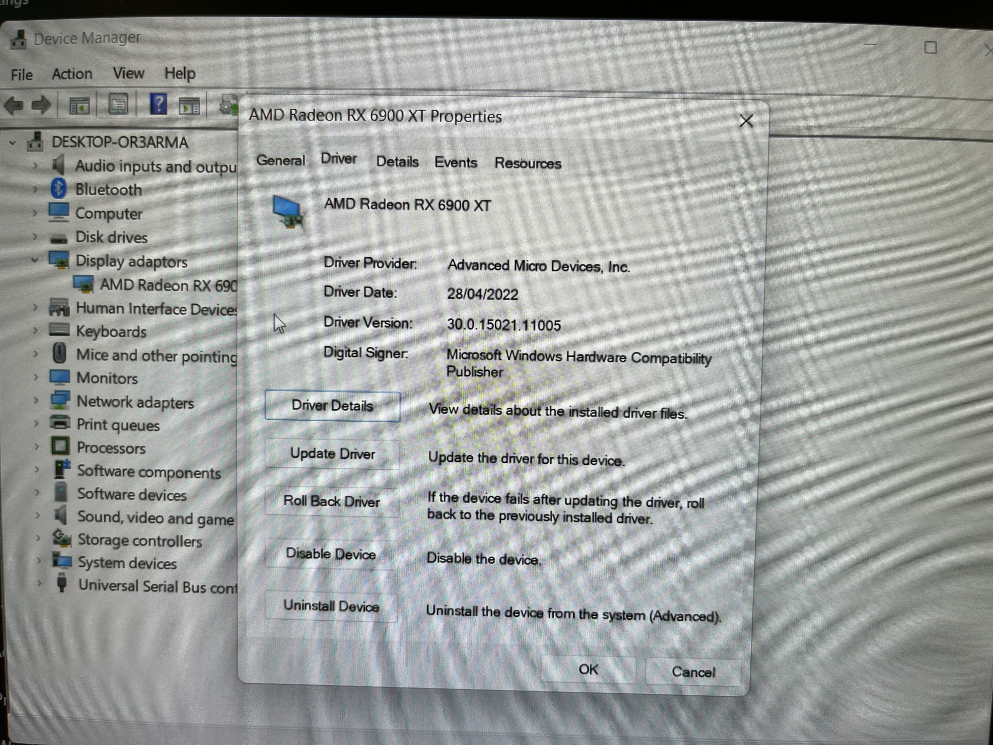

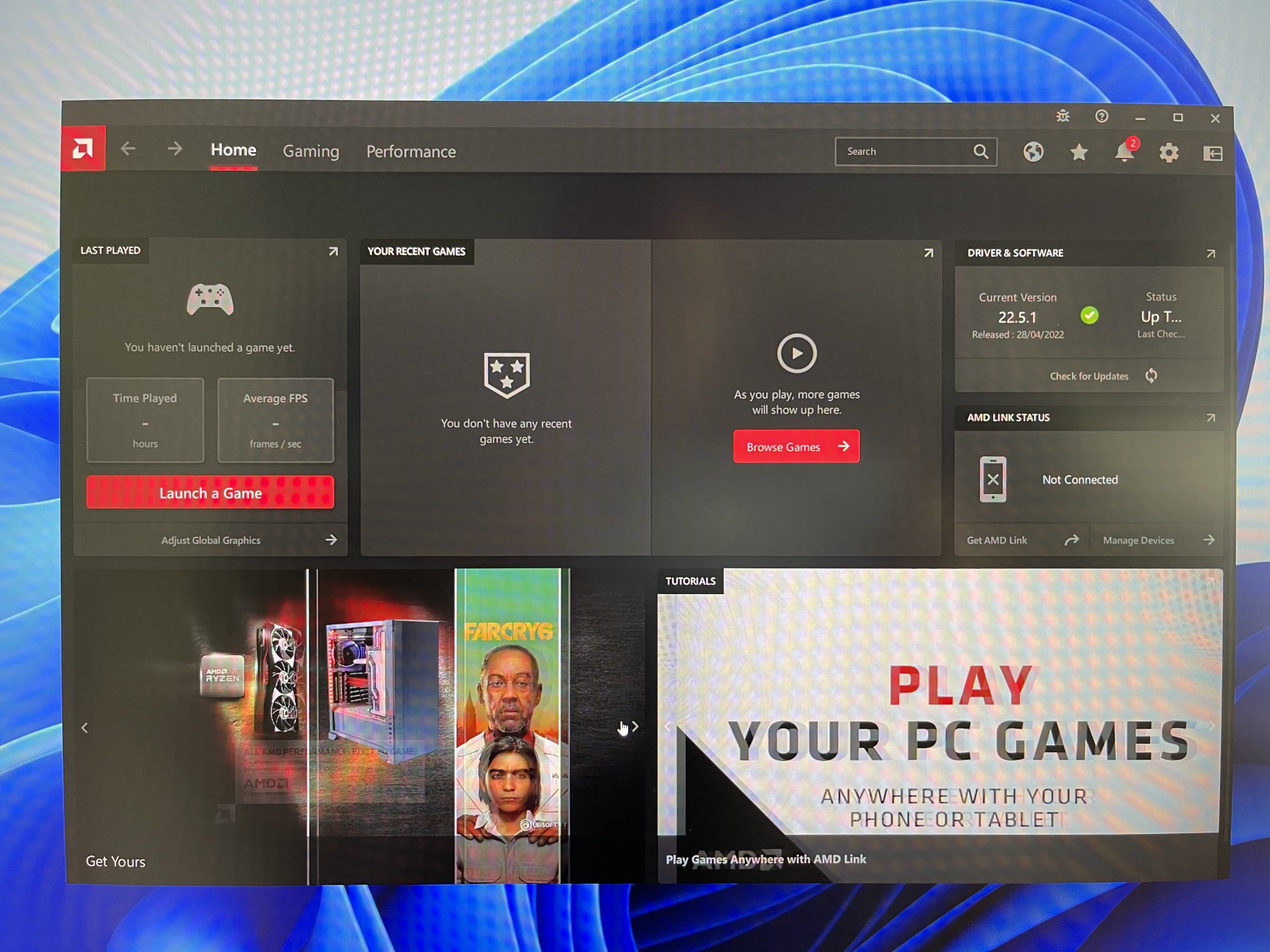

I decided I would update the 6900XT drivers in Win 11 bootcamp on my Egpu as they were months old so downloaded the latest drivers from AMD, I then go install and it extracts them all to a folder on C drive in windows. then complains they are not compatible with your system and they close. Copy the Extract folder from C drive to desktop.
When you open device manager and open 6900XT click update drivers. browse to the folder on your desktop and click update. it will go through the process of updating then reboot. Not only do you get the latest drivers for windows but a fully functioning AMD Adrenalin GFX control panel, which works perfectly.
So as you will see below I now have the latest drivers in my bootcamp win 11 and all working 100%
