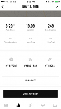

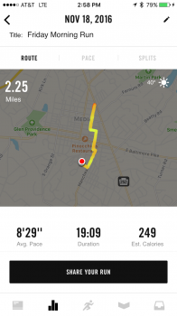

Observation #3 - after the run sync'd to the Nike servers, the iPhone NRC app did not show HR or elevation data. I expected not to see the elevation since I started the run on the watch, but I figured that since the iPhone was showing HR data during the run, that it would show up.

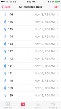

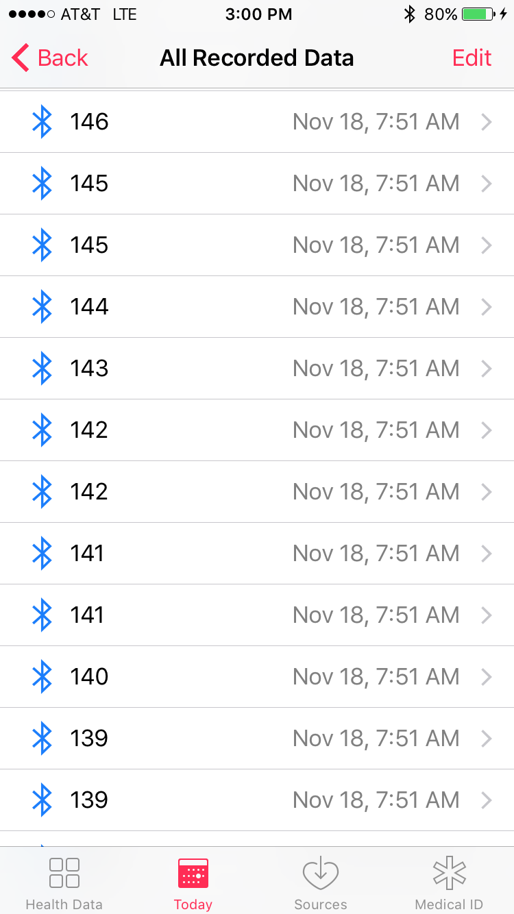

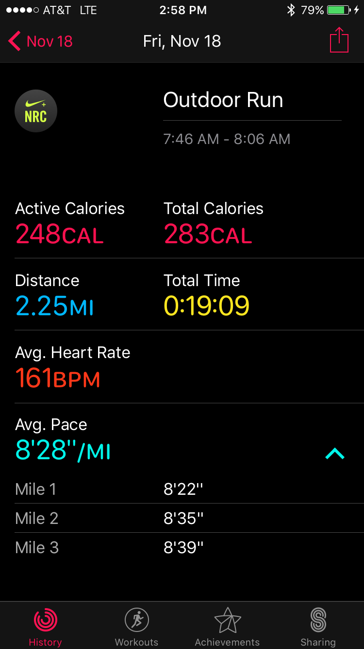

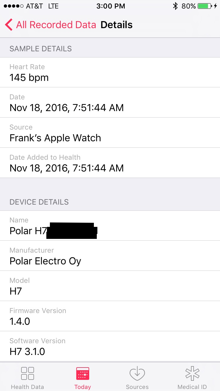

Observation #4 - I confirmed that the AppleWatch did transfer the HR data over to the phone by looking at the Health app data.

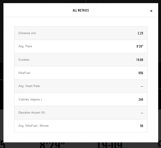

Observation #5 - this one is interesting. Even though the NRC app did not record/sync the HR data, when I look at the run in the Activity app, the average HR is recorded (no min/max shown).

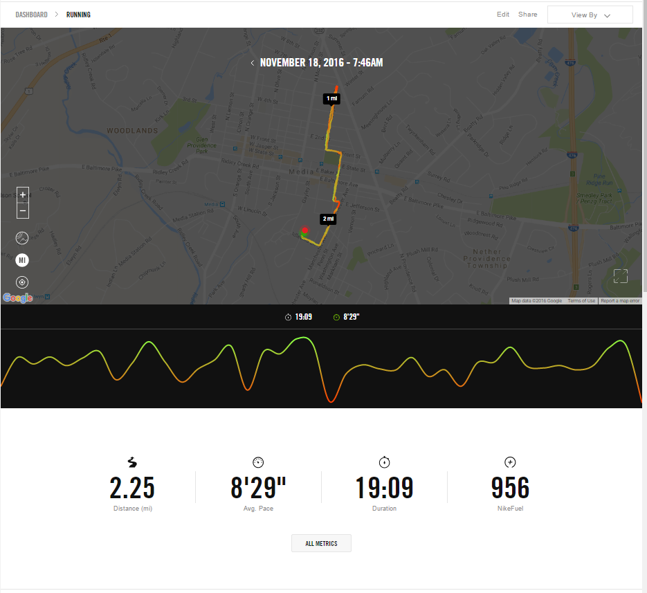

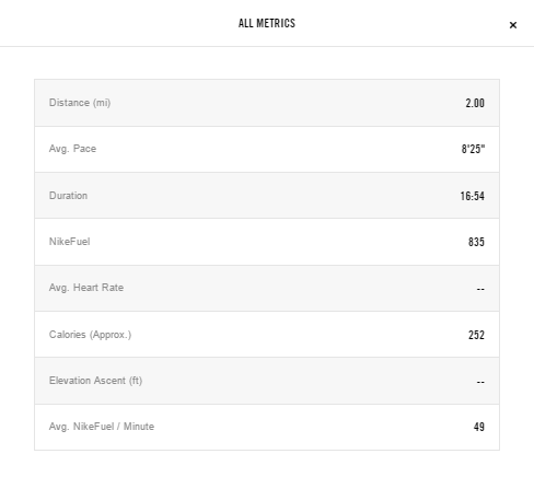

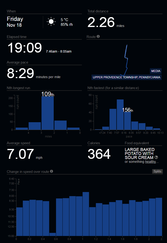

Observation #6 - I checked the run on the Nike website and also on SmashRun, neither HR nor elevation was recorded.

Observation #7 - GPS data was recorded and sync'd fine. No issues.

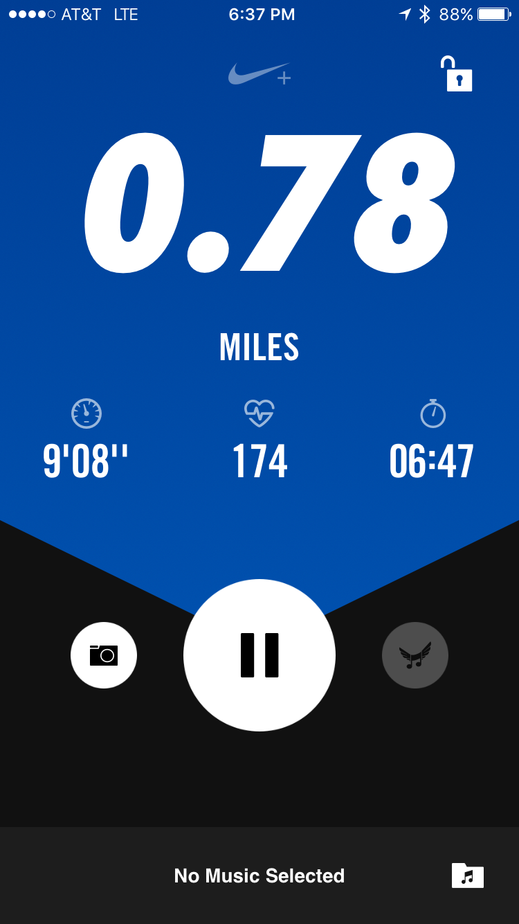

21NOV2016 (630PM)
Equipment - Nike+ apple watch (watchOS 3.1); iPhone 6 (iOS 10.1.1); Polar H7 BT HR monitor (Firmware 1.4.0, Software H7 3.1.0) - NRC app (5.2.0) - note that I had updated my iPhone between this run and the previous run
Like before, I started off by connecting my HR monitor to my AppleWatch. I confirmed that the HR monitor was being used instead of the watch's built in sensor.
Started the run with my watch. iPhone was in my pocket.
Observation #1 - the watch did not show the HR, but the iPhone did. The sensor on the apple watch was off.

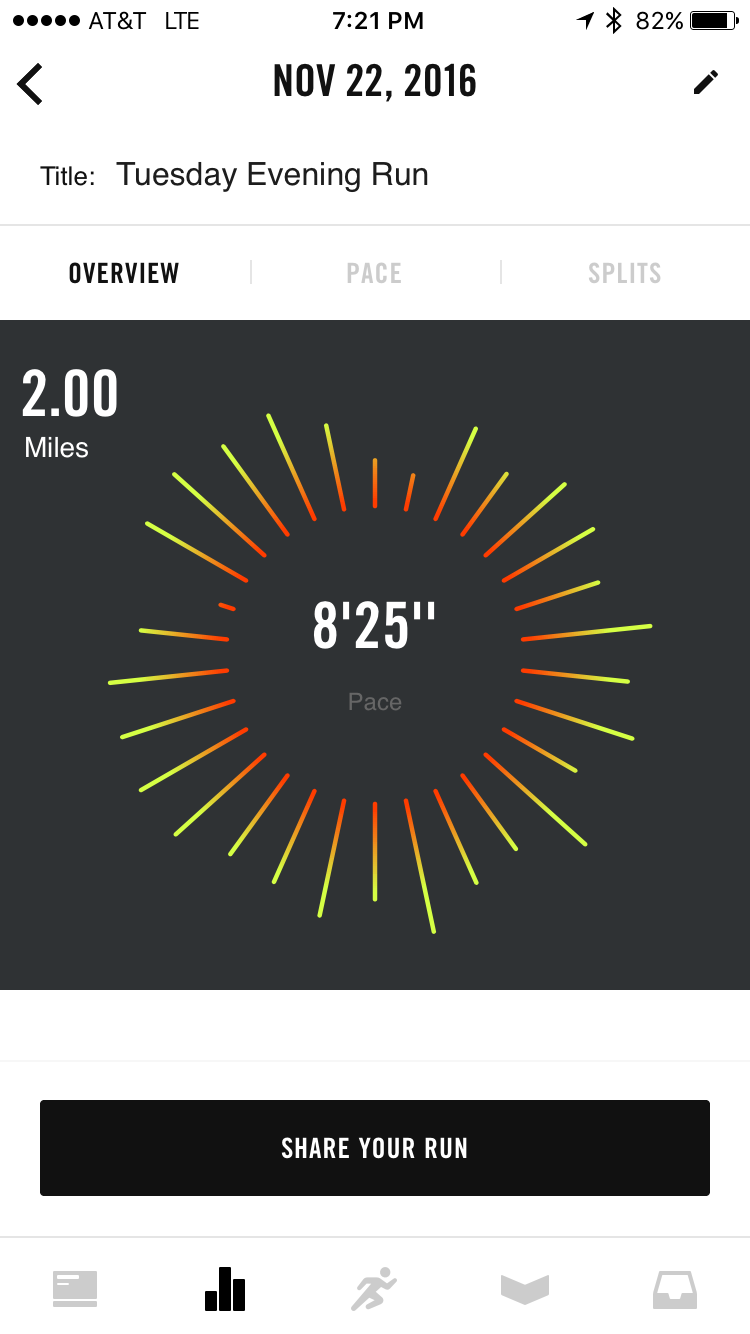

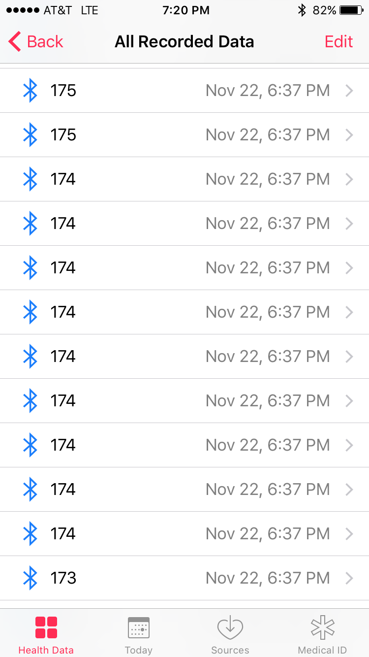

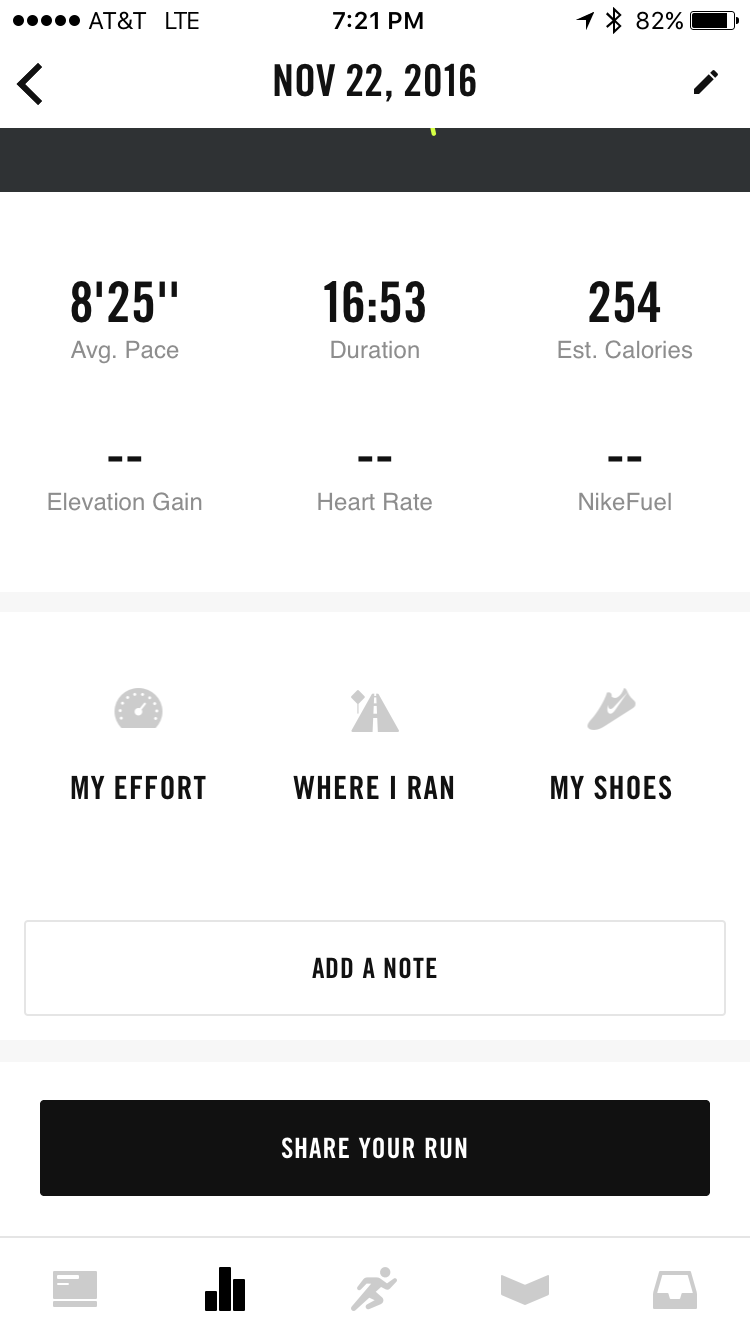

Observation #2 - even though the NRC app on the iPhone had HR data during the run, upon syncing with the Nike servers, the HR data was not transferred over. Also note that splits were not recorded, but this is expected behavior as splits do not transfer unless you start the run with the phone.

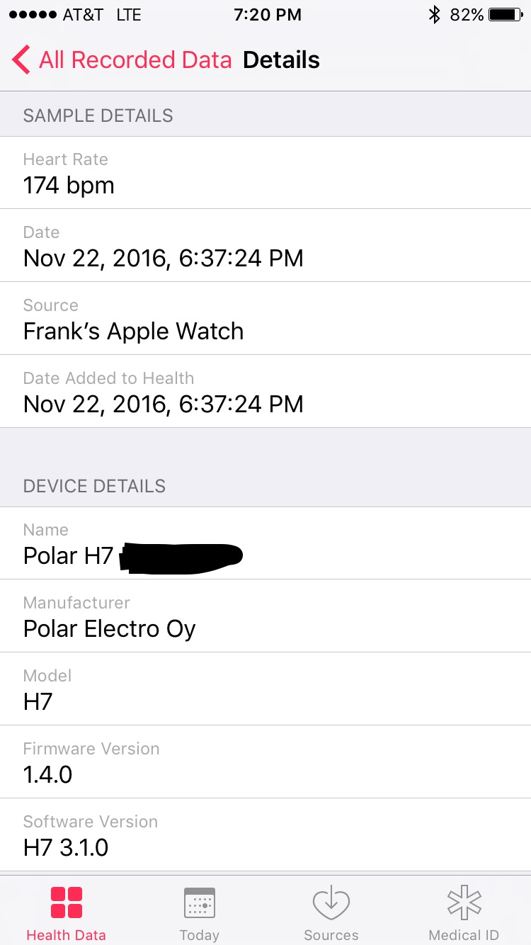

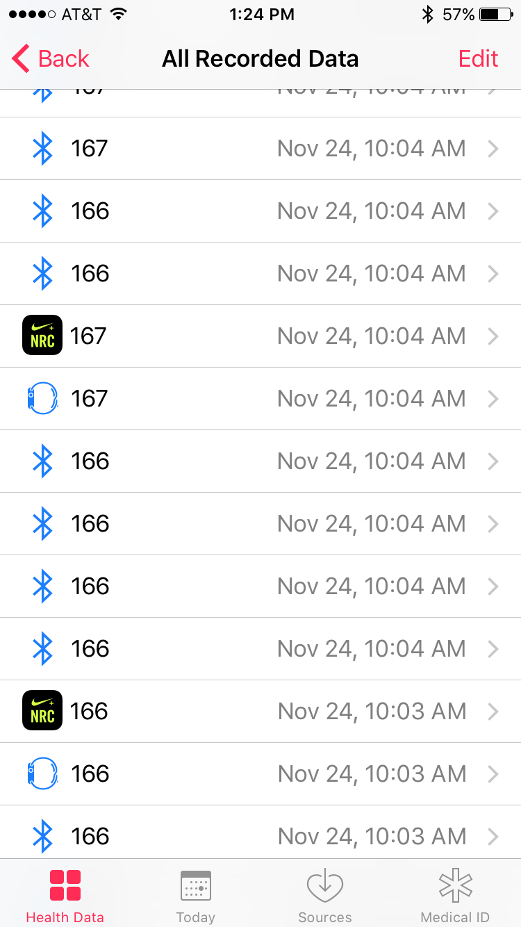

Observation #3 - the HR data that the iPhone was seeing was provided by the apple Watch via the BT strap.

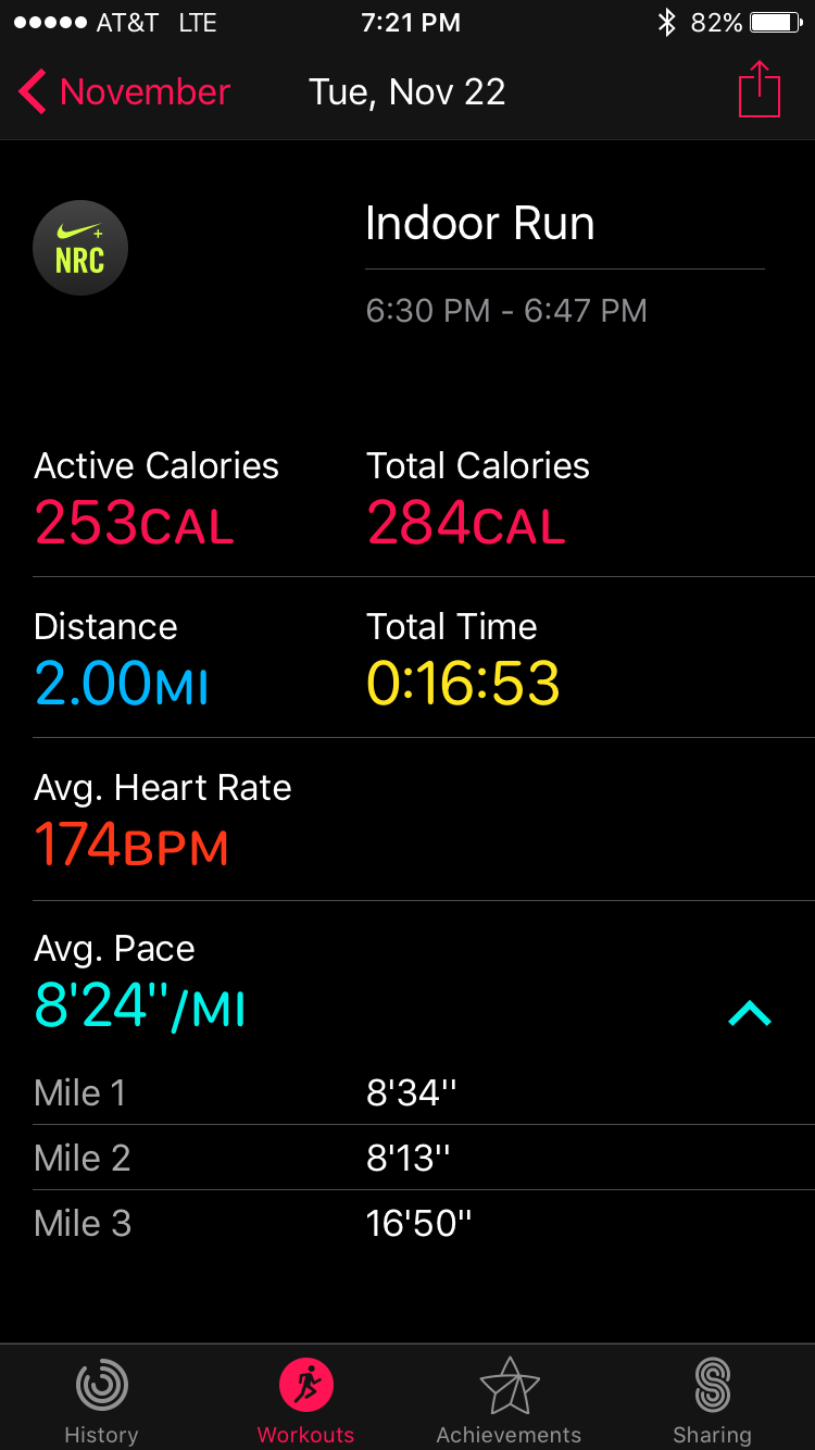

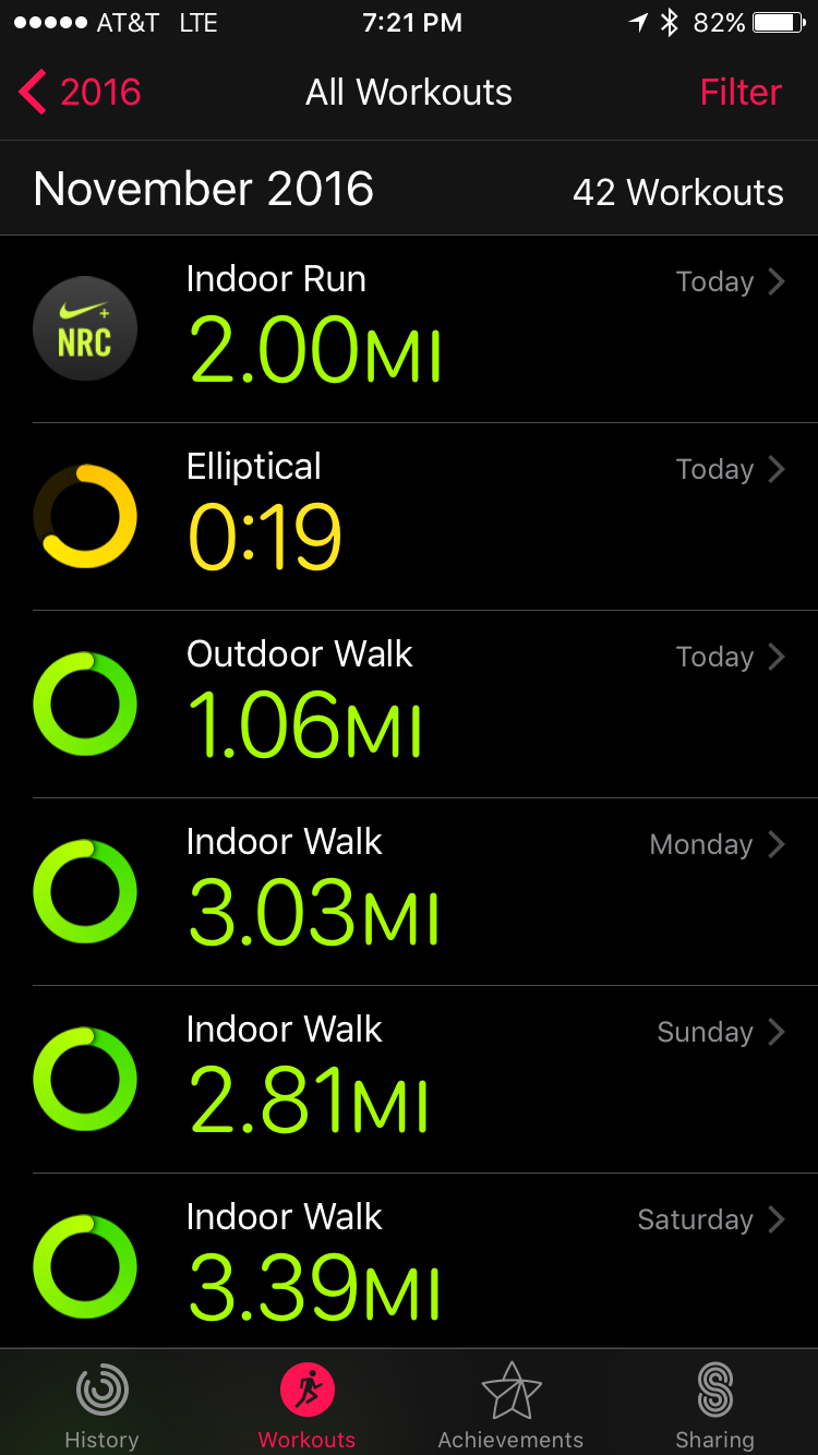

Observation #4 - as seen with the previous run above, the Activity app on the iPhone shows both the HR data and the splits, so the information is available for the NRC app, but they just don't grab/record it. Baffling.

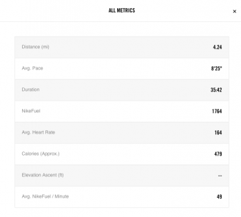

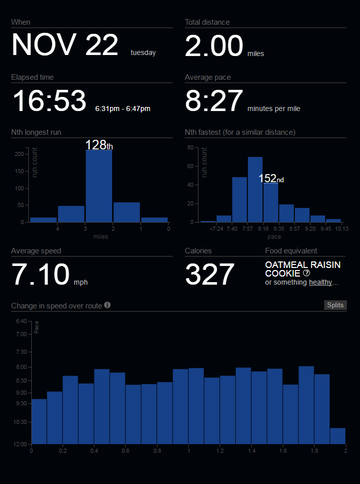

Observation #5 - Neither the Nike website nor SmashRun recorded the HR or splits. The Nike website did not record HR or splits. SmashRun didn't record HR, but it did record the splits.

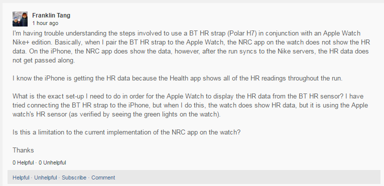

BTW, I posted over on the Nike Run Club facebook page.
They respond quickly, but man, this app really needs work.

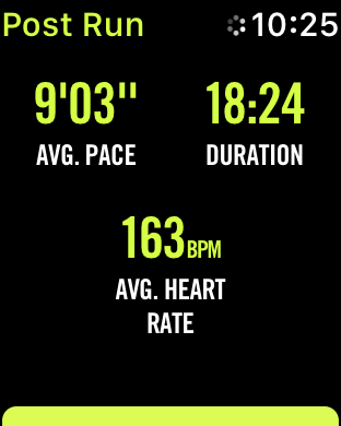

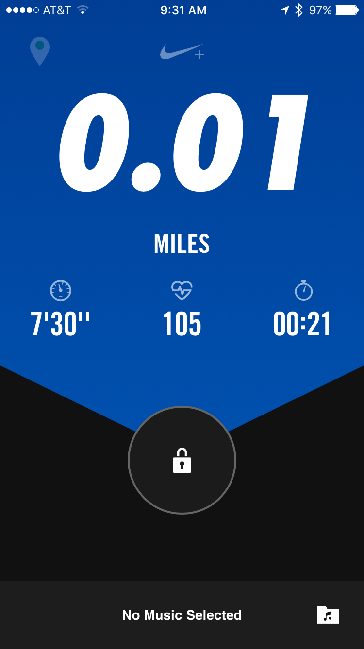

Happy Thanksgiving Everyone. I did a morning run to try and get that Turkey Achievement.
24NOV2016 (931AM)
Equipment - Nike+ apple watch (watchOS 3.1); iPhone 6 (iOS 10.1.1); Polar H7 BT HR monitor (Firmware 1.4.0, Software H7 3.1.0) - NRC app (5.2.0) - no changes to equipment from the last run

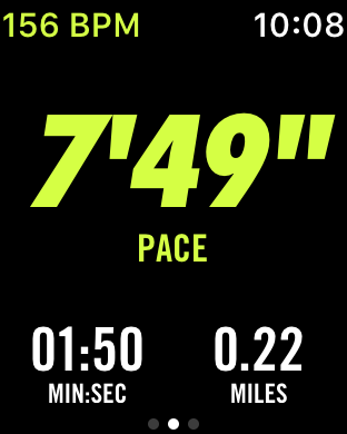

For this run, I connected my HT monitor to my iPhone and confirmed that the NRC app on the iPhone could see the data.

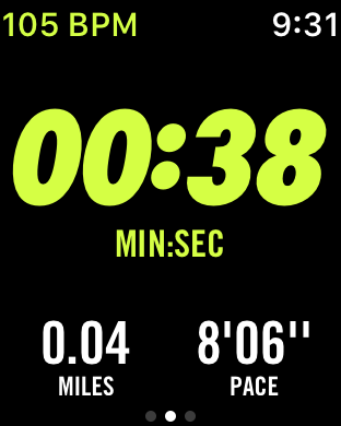

I started the run with my watch, iPhone in my pocket. The HR sensor on the AW lit up and the NRC app on the iPhone had HR data too.

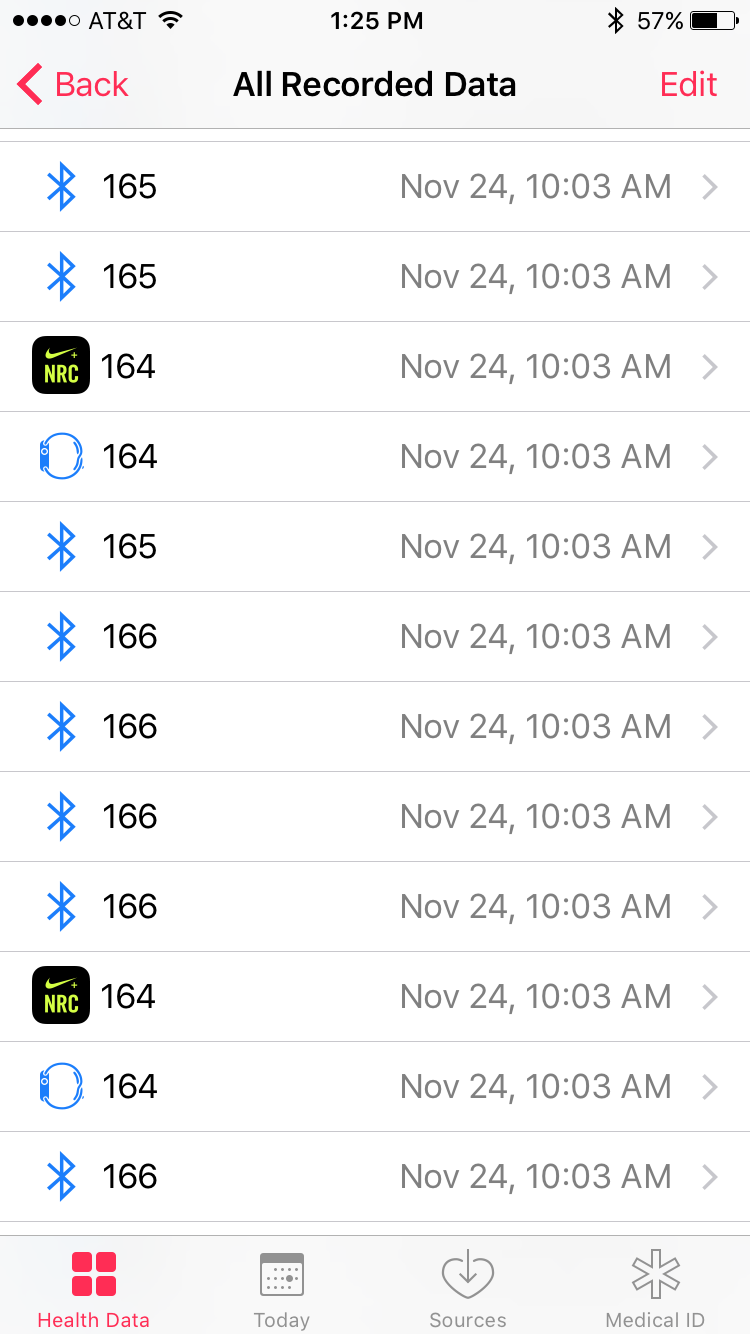

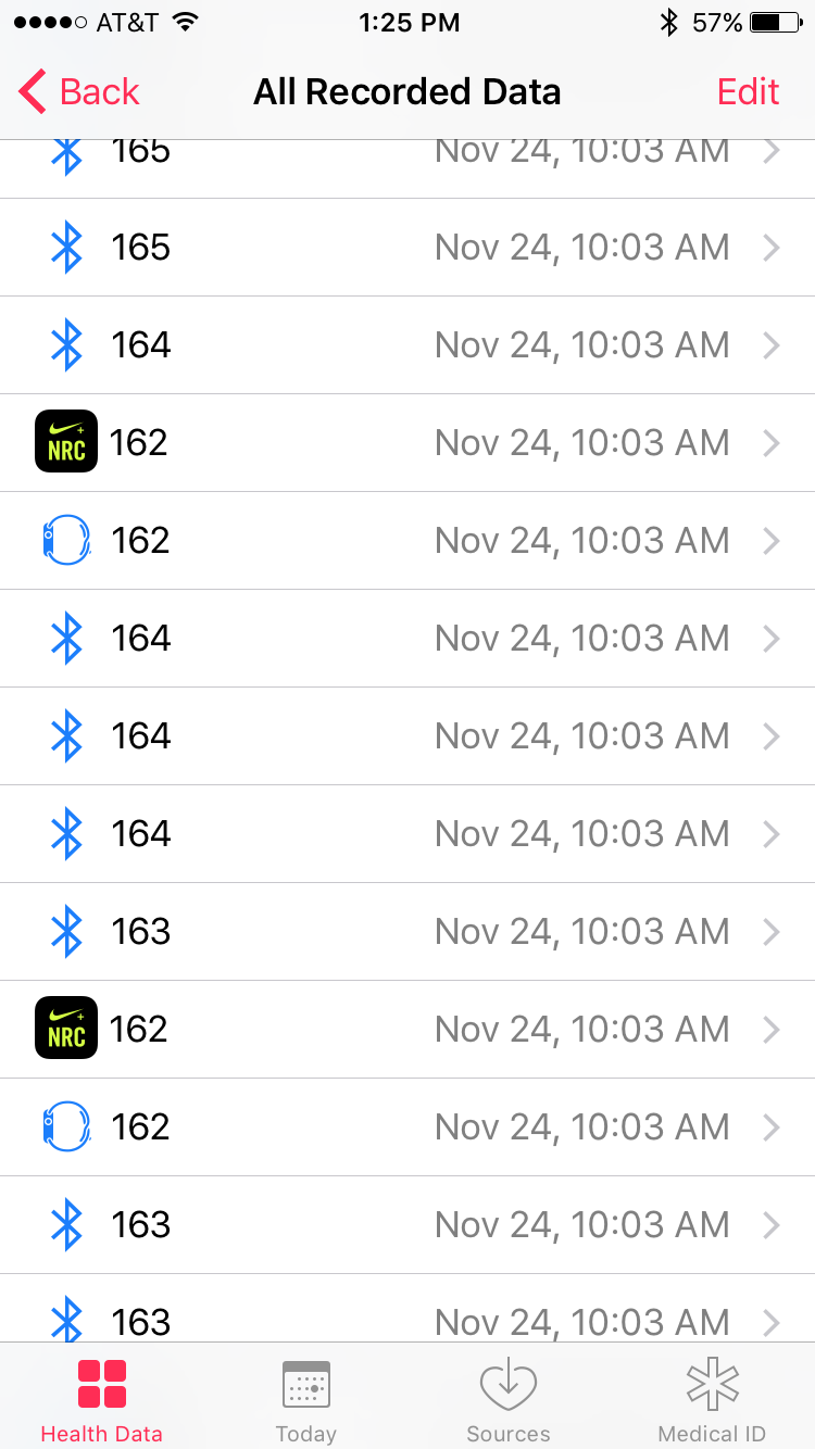

Observation #1 - Both the AW and iPhone NRC apps had HR data available. My guess is that the NRC-AW app was using the watch's sensor and the NRC-iP app was using the BT strap.

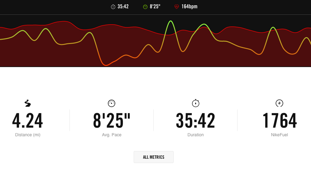

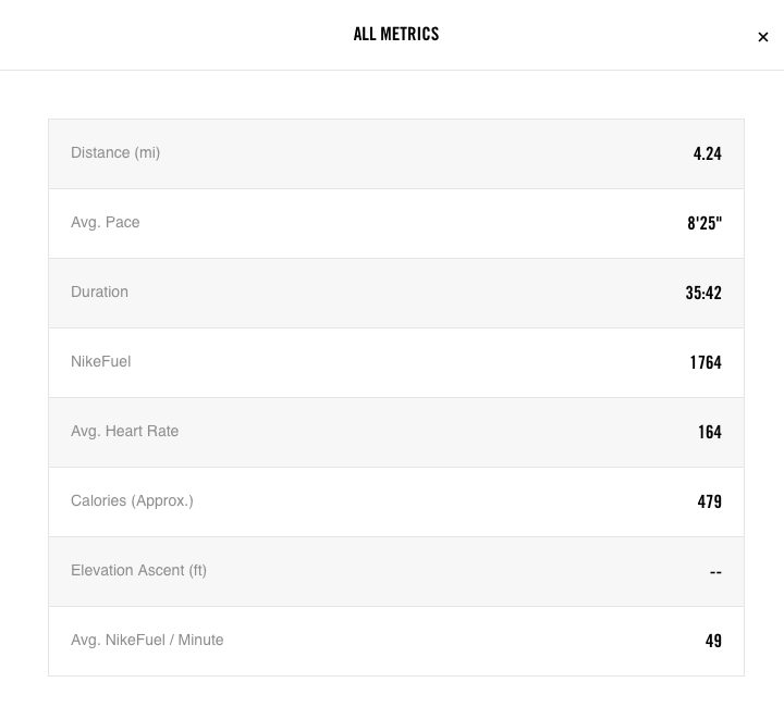

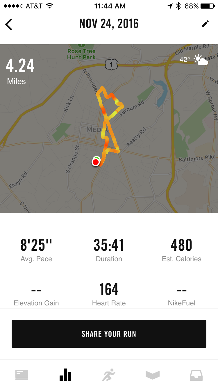

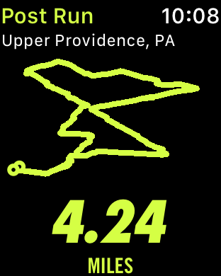

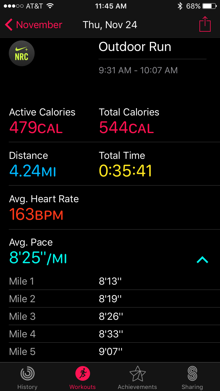

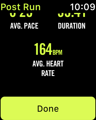

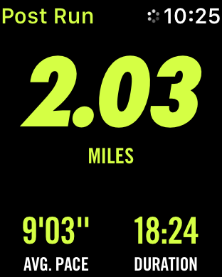

Observation #2 - Upon completion of the run, the NRC-AW app showed both the route and the HR data as expected.
Observation #3 - After syncing with the Nike servers, the NRC-iP app showed everything as expected, which means no elevation changes or splits, since I started the run with the watch.
Observation #4 - The Activity app on the iPhone showed both the HR and splits.

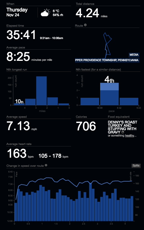

Observation #5 - The Nike website recorded maps and HR, but not splits. Smash recorded maps, HR and splits. To me, this is weird ... why does SmashRun record splits, but the Nike website doesn't? SmashRun gets the data from Nike. :(

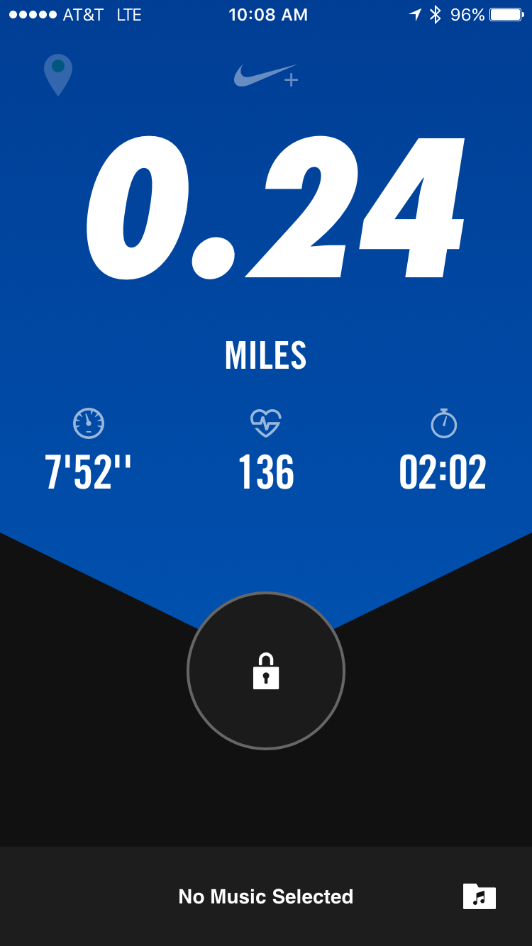

Quick 2 Mile Run this morning. My normal route, so nothing out of the ordinary, besides my sucky pace.
26NOV2016 (1006AM)
For this run, I connected my HT monitor to my iPhone and confirmed that the NRC app on the iPhone could see the data. Everything was setup the same as my previous run, except this time, I started the run on my iPhone. However, I was surprised to see that the AW mirrored the iPhone. The last time I tried this, the AW didn't see what the iPhone was doing. I suspect that this is because I had the NRC-AW app opened when I started the run with the NRC-iP app.
Either way, both the iPhone and AW was reporting a HR. I suspect that the NRC-AW app was getting the HR from the watch sensor and the NRC-iP app was getting it from the BT HR monitor.

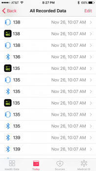

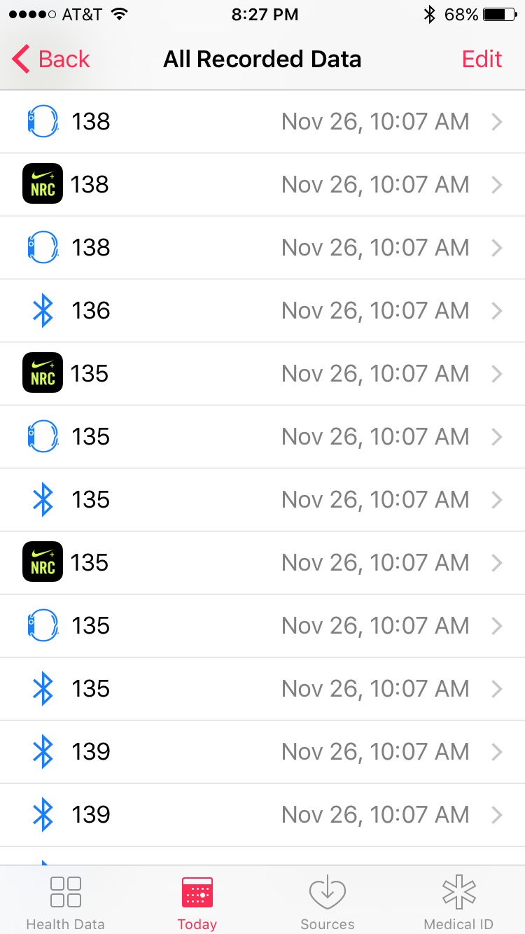

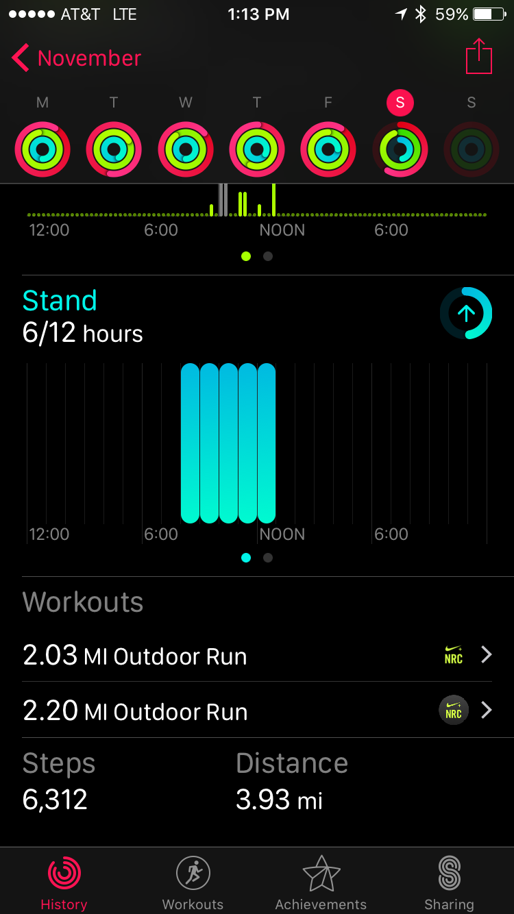

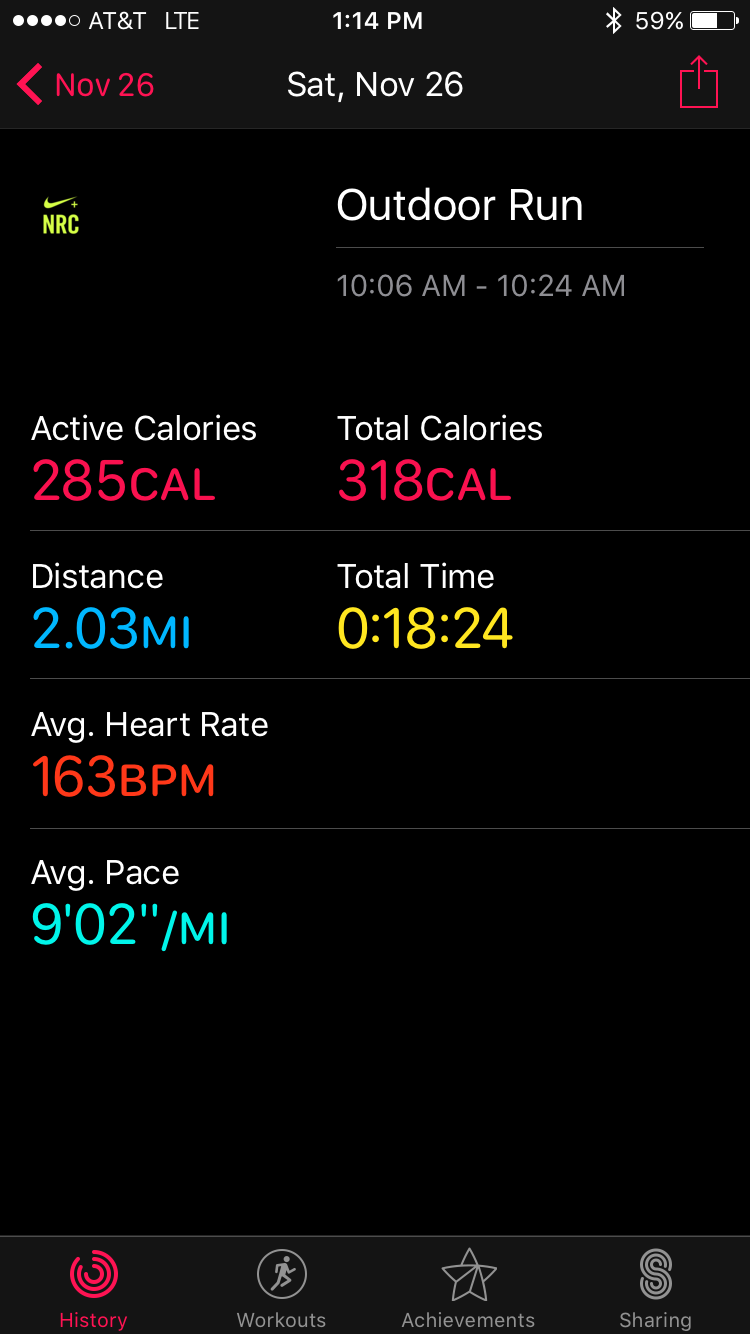

Observation #1 - I didn't notice this at the time, only after the run when I went through my screenshots. The AW and the iPhone were reporting drastically different HR. I think this is because something weird was going on with the BT monitor. It just cut out after about 2 minutes into the run. Don't know why.

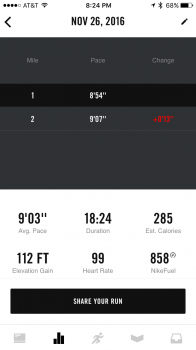

Observation #2 - While I started the run with the iPhone, I ended the run with the AW. It was kinda difficult to end the run as I had to hit the pause button several times. I'm not even sure that's how I ended it. Perhaps it was because I came to a complete stop and the app auto-paused. I did notice that the AW screen didn't show the course map after the run.

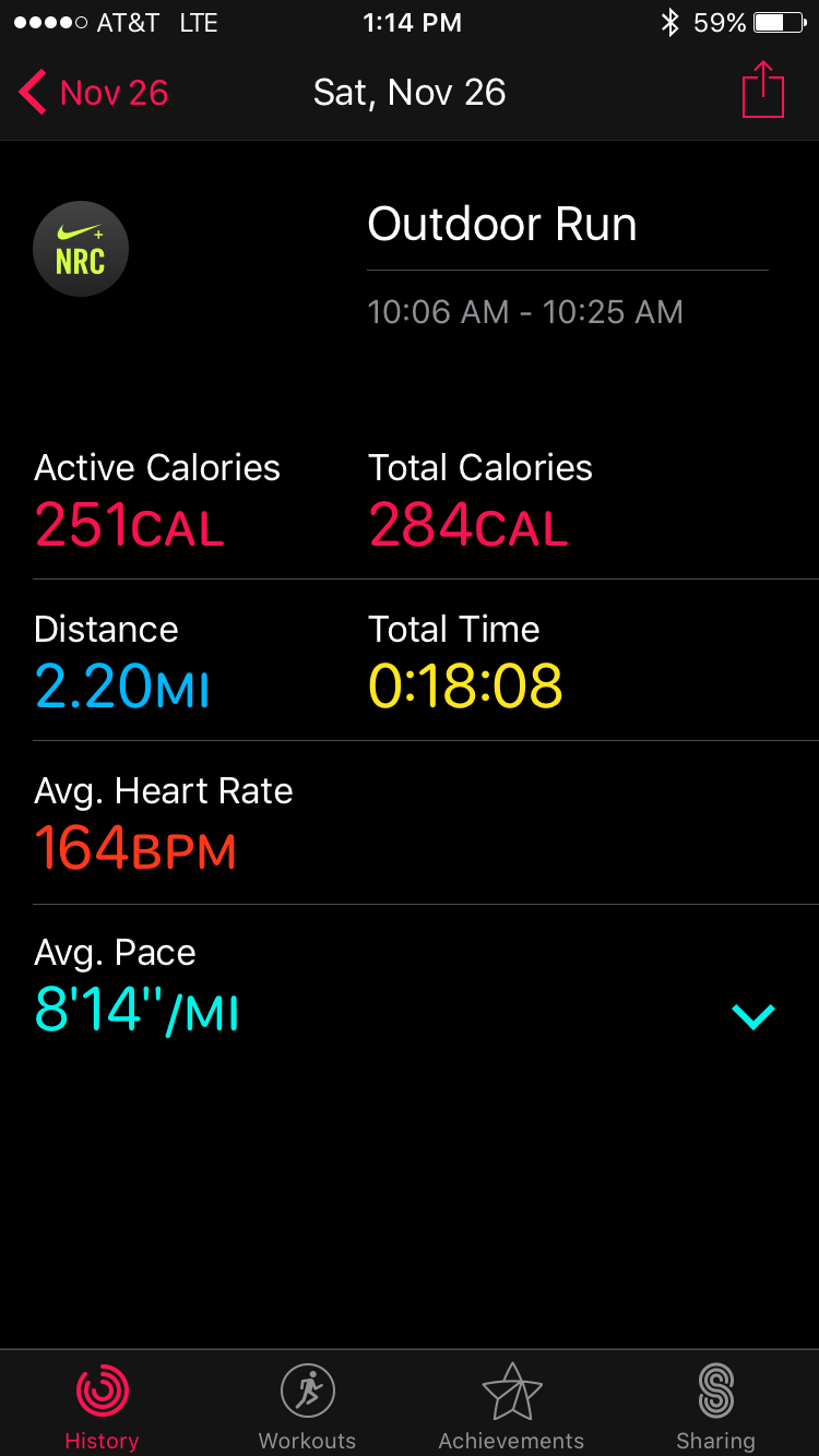

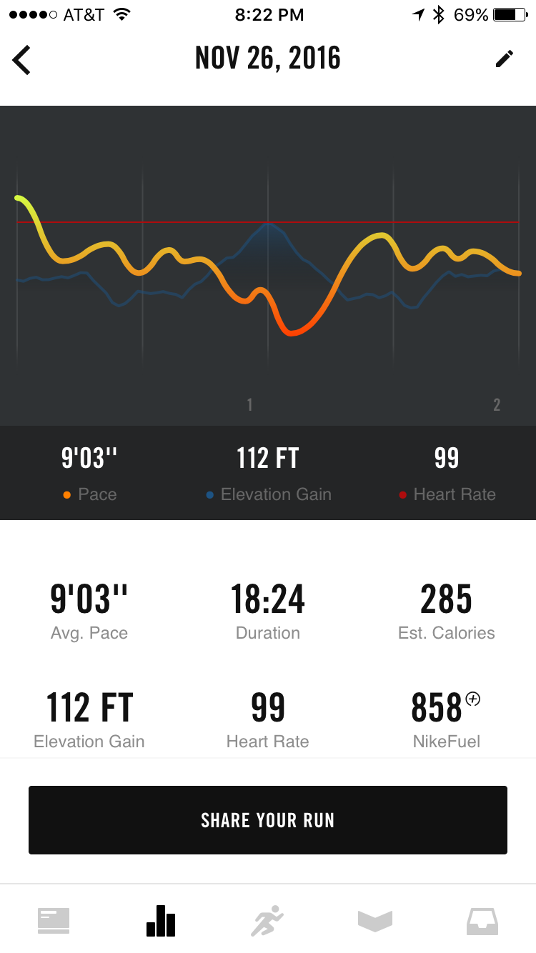

Observation #4 - The NRC-iP app showed the run at 2.20 miles, but when I logged in on my computer, the Nike website said 2.03 miles. Then when I reloaded the NRC-iP app, the run came in at 2.03 miles. What's weird is the HR was tagged at 99 bpm and flat all the way through the run. The nice thing is that splits and elevation were recorded and sync'd.
